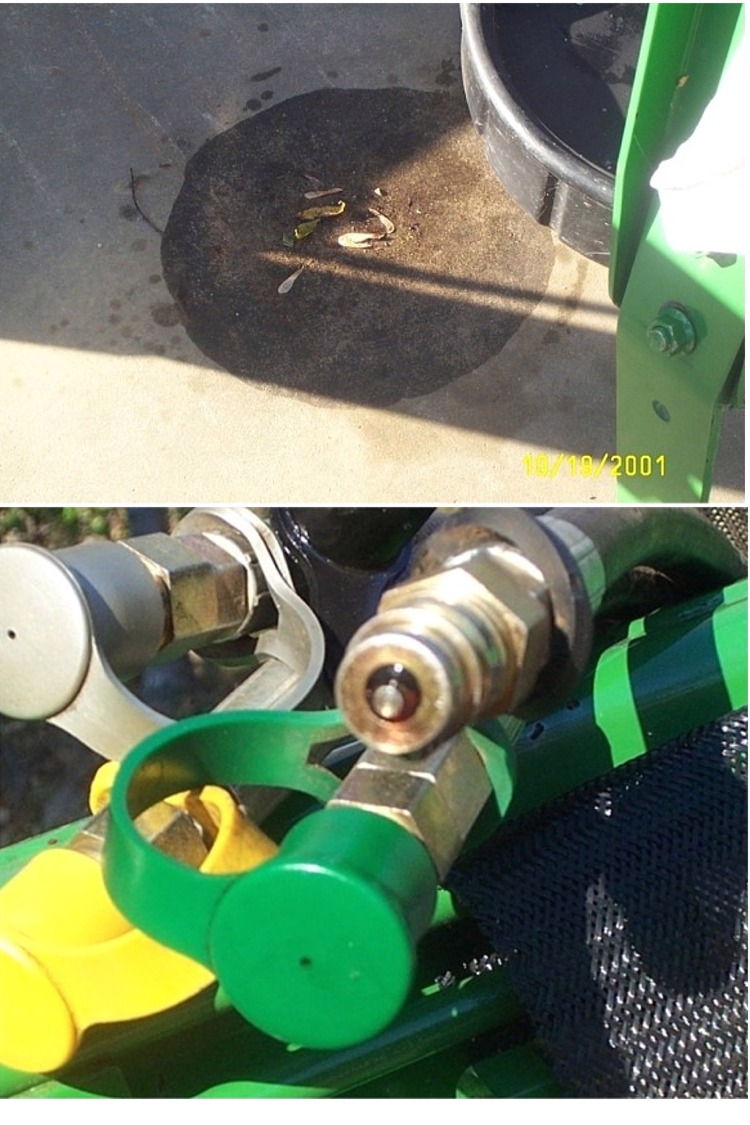

   / Hydraulic fluid frothing...
#13
The saga continues.....
Came home from work last evening and lo and behold an oil spot under my detached FEL. Aha.... the evidence is displayed in the attachment.
It appears as thought the seal for the nipple on this male quick attach is leaking. My guess is that it is shot and cannot be repaired.
Does anyone think that it is warrantee work or, oops heaven forbid, operator error?
It appears that the bad seal is may be causing the frothing (refer to previous posts in this thread on frothing/foaming) also. #4 Head-End lift cyl and #3 Rod-End lift cyl.
Terry
#19
I talked to my JD dealer and he said to that some manufacturing debris could be the problem. The seal is metal to metal, he says. No O-ring. So, I tried to pull out what appeared to be a piece of O ring or rubber. When I pushed the nipple in the rubber slipped back in.
Okay, now I have to remove the quick attach. I had a heck of time trying to get the thing off. Since I've never messed with hydraulics before I called my neighbor John over to lend a hand. He plays around with avionics and high pressure systems so I figured he would be the guy to have around.
We get the silly thing off after a few kind, manly, Naval words. We get the thing off and no rubber is floating around loose. John says that it has to be an inner O ring seal because metal to metal would not seal very effectively under higher pressure.
Well, I guess the short of it is that I have to replace the quick attach male nozzle. And of course, I couldn't get to the dealer in enough time to have them supply me a replacement (warrentee, of course).
The problem has finally be identified and will be solved in short order. Moral to the story. Don't take advise from your dealer over the phone. Just dive in a try to fix it yourself - with a little help from the TBN folks, of course. /w3tcompact/icons/smile.gif
Terry
P.S. - John Miller - looks like you were right on the money with a localized problem e.g. O ring.
