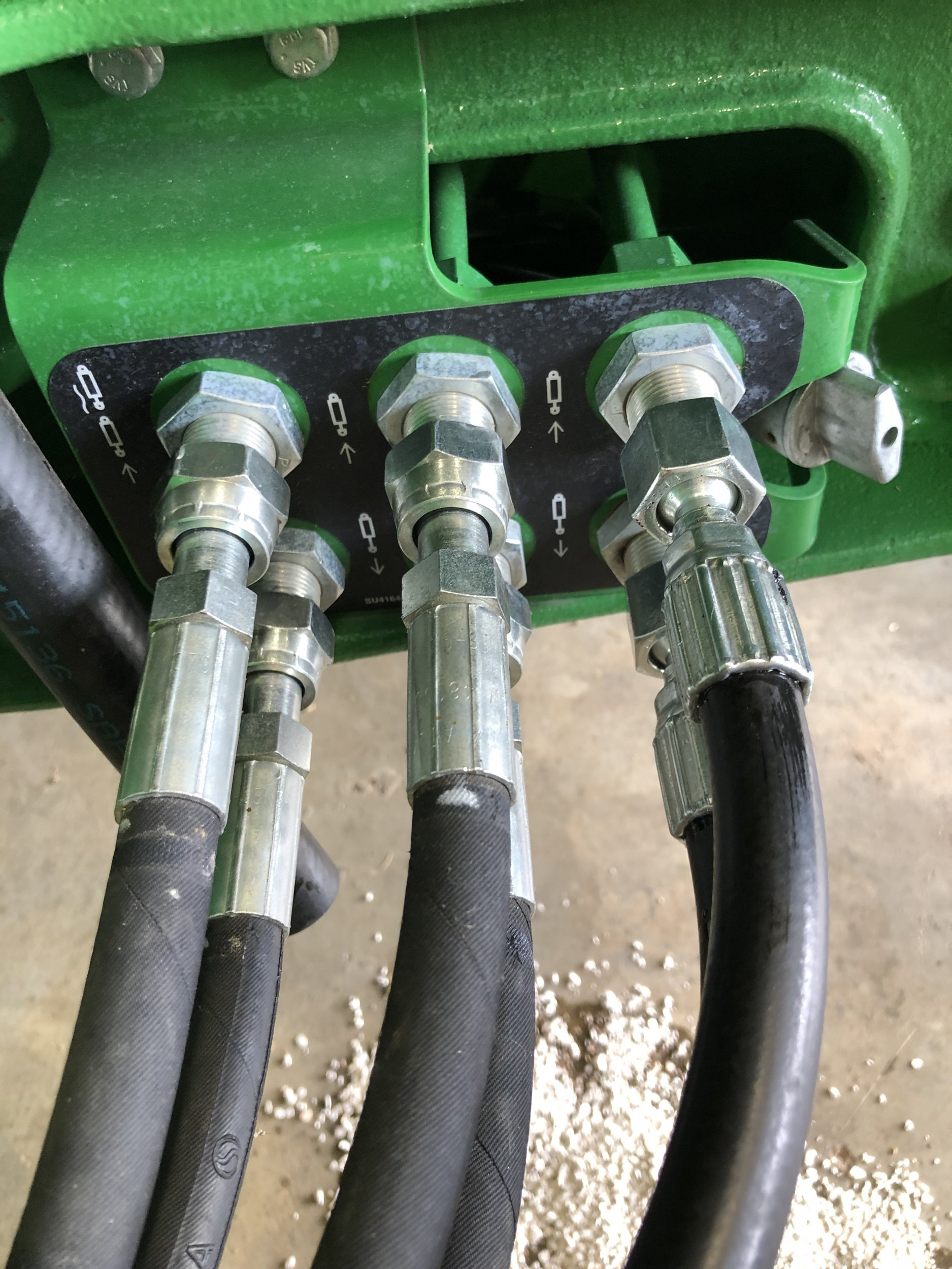

You miss understood my post just a little. I want to remove those 6 male orfs mid mount fittings that came w the tractor, unthread them from there steel lines. Once I do this it looks to me like those 6 female couplers would fit in the bulkhead mount and as I said before connect directly to the Female ORFS fitting on the steel tubing in back of the bulkhead mount frame. Thanks again.

Oh sorry.
that might be possible idk.
I hadn’t had those male fittings down there unthreaded from the tractor
the hex nut you see against the black sticker is a jam nut to keep the male o ring fittings from turning.

   / Hydraulic Hoses, Couplers & Brackets for JD 5115M Loader Frame Bracket Mounts #54
Good picture. I’m just gonna remove those male jam nutted fittings and replace with the 6 female couplers that you have. The female couplers will thread directly to the Green painted steel lines.

That’ll work.
it’ll be like the older JD where loader hoses connected down under the floorboard (y)
That will keep you from hanging tree limbs you mentioned.
I like customizing my tractors & trucks for specific applications :love:
