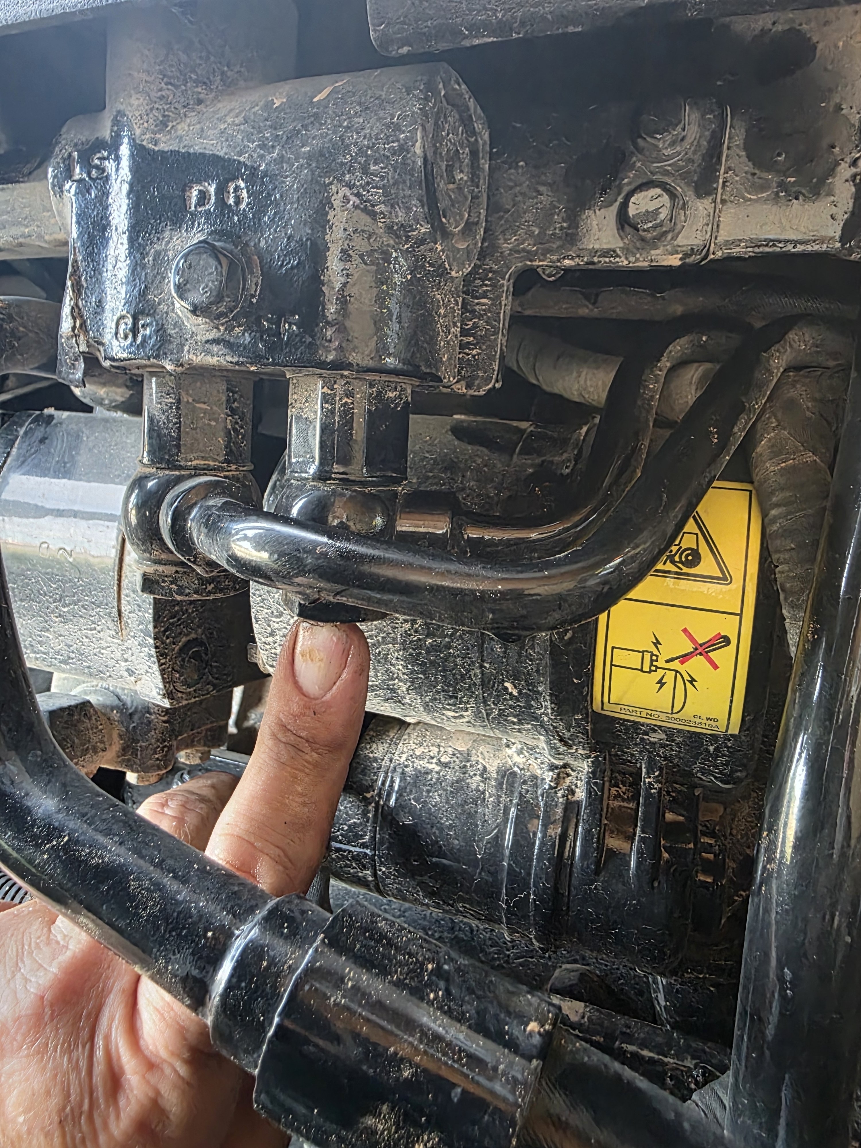

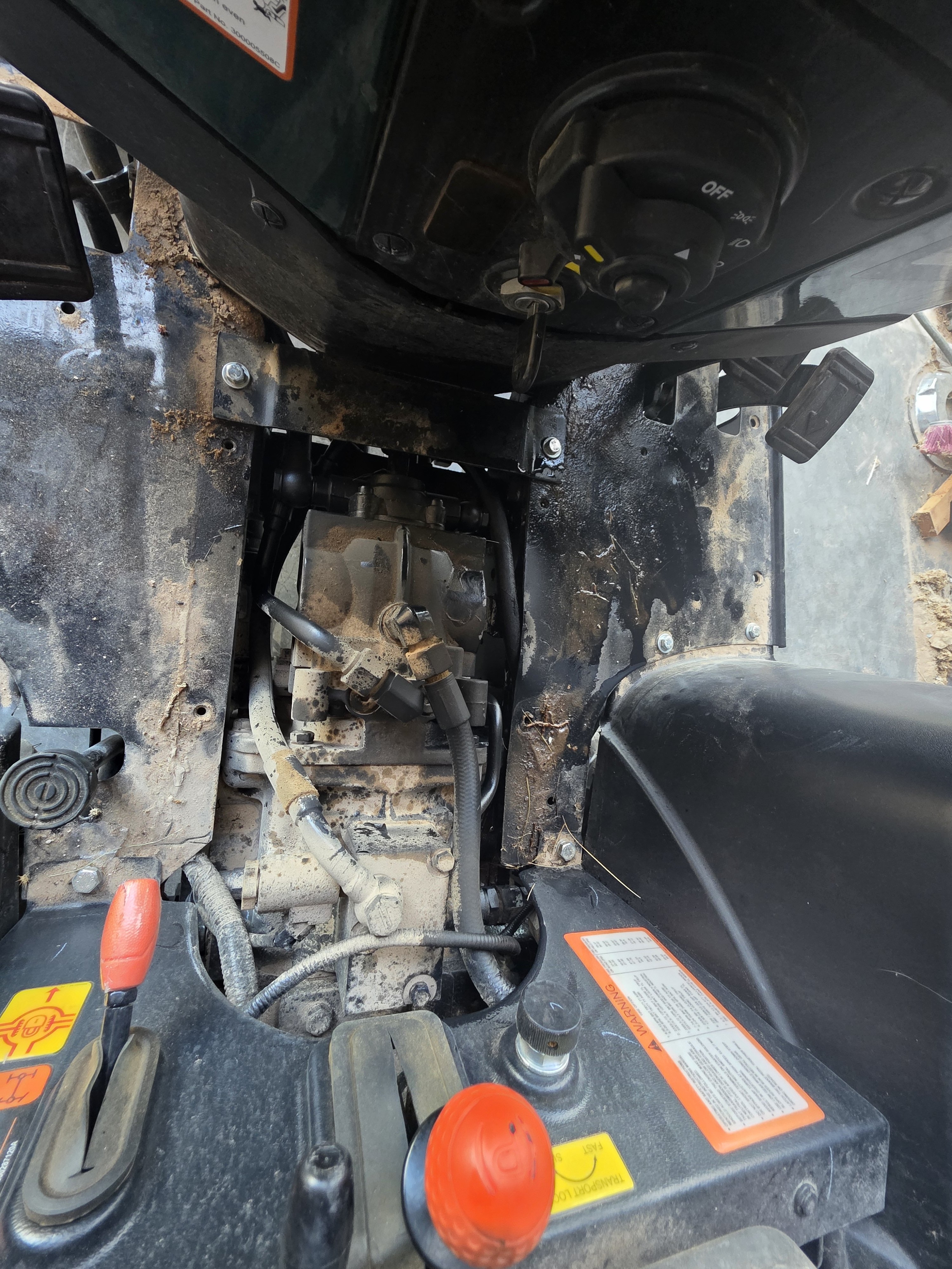

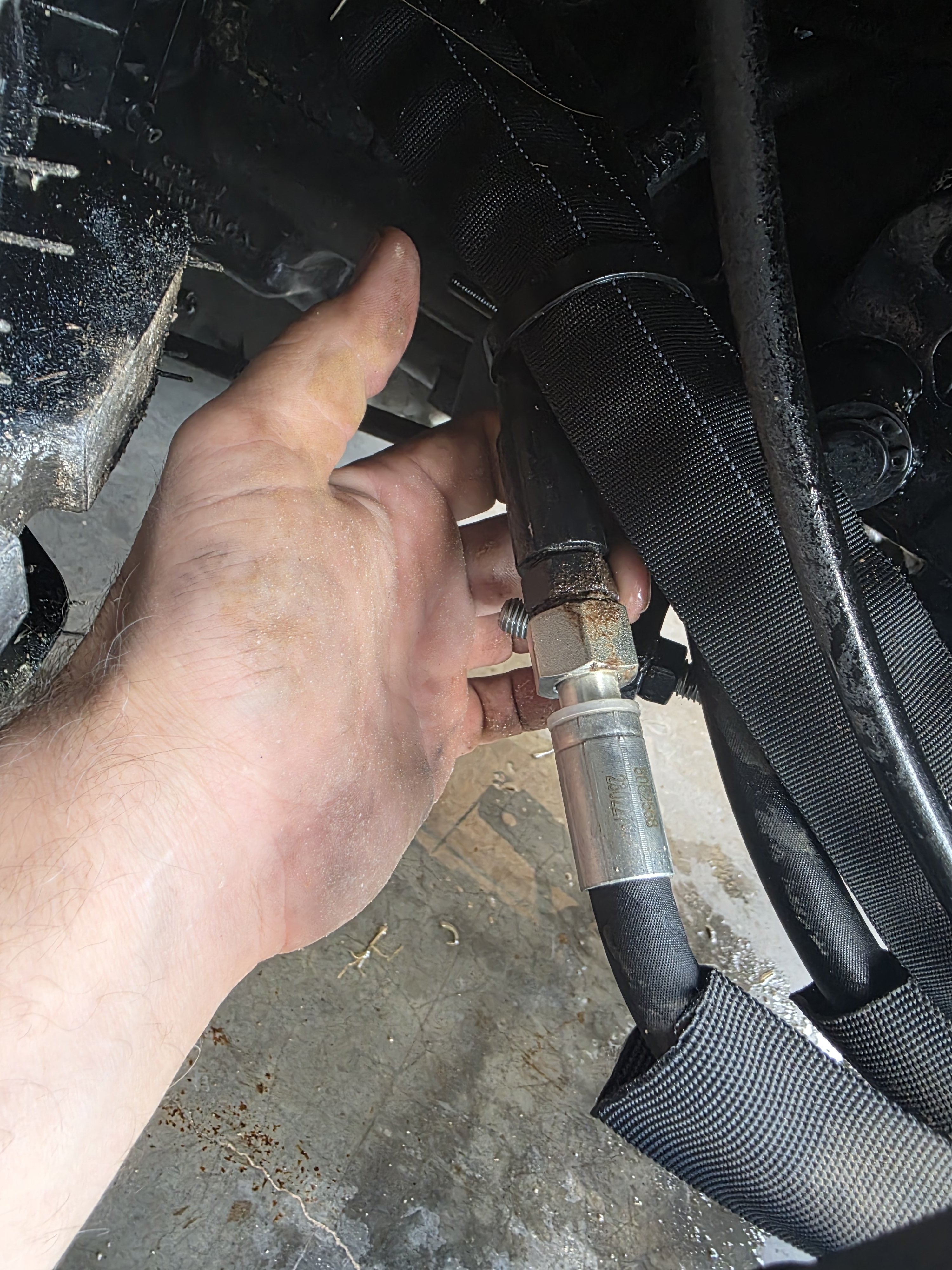

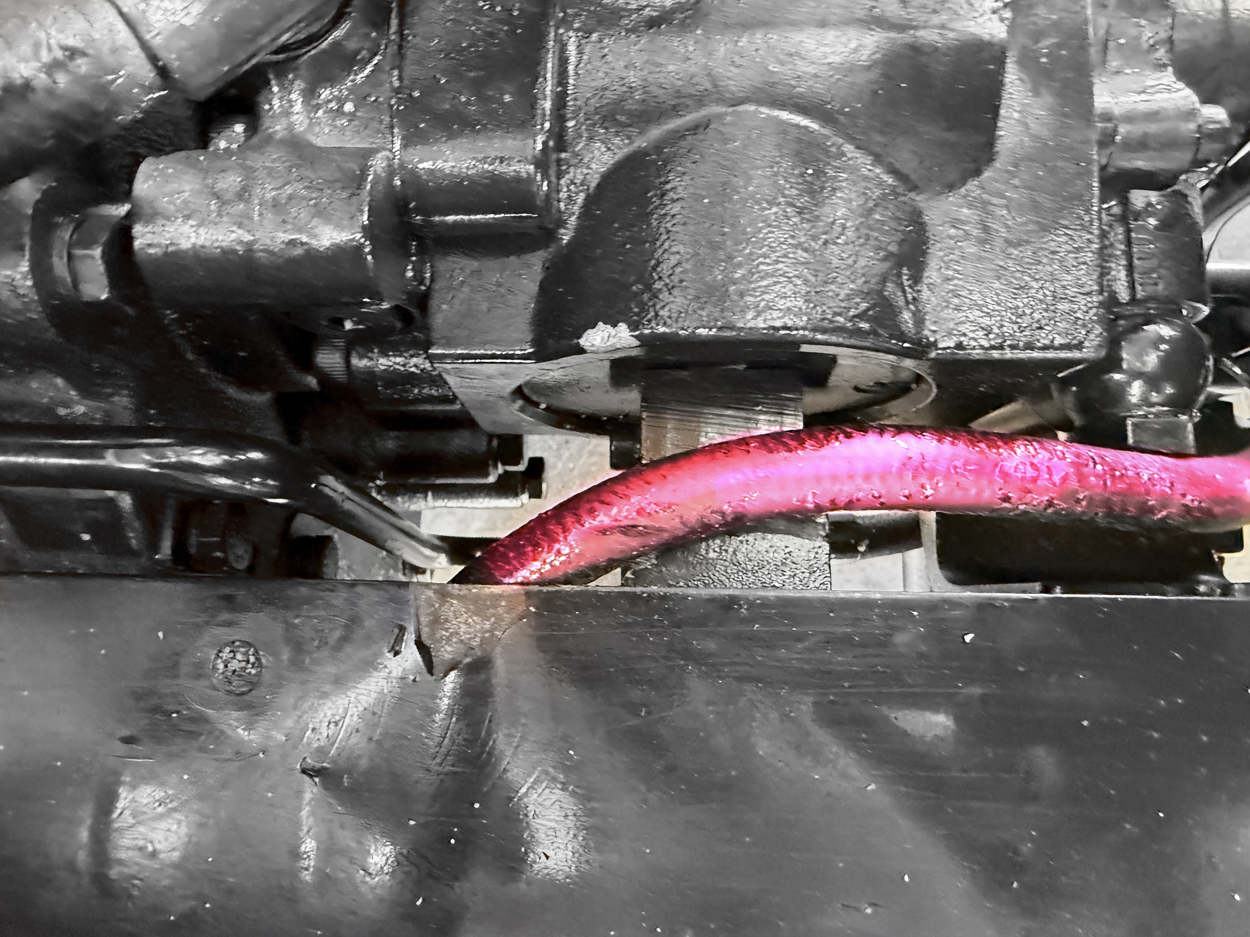

Any one else have a hydraulic line burst right under the floor mat? It was pinched between the floor board and the frame and the forward pedal pedal pivot was was rolling right under it you can see it in pic 2. It all most cut the hose in half.

Well talked with the dealer today (kinda). I called Said he was busy and would call back. (never did) I called back He asked for pictures, I sent them, he said he would see IF it's covered by warranty. and call me right back. (never did). I guess I will try again tomorrow. At only 49 Hr. on it I would think it would be a no brainier. This is also how the calls went when I ordered the 50 Hr. service kit. I only got the hydraulic filters called twice about the oil and fuel two weeks in a row and was told they are shipping out this week that was three weeks ago. (still no filters). So its been down for awhile now waiting on the dealer to send parts.

Yes, I was just about to post about this. I have been trying since July 27th to obtain a replacement hose. I think everyone needs to check their tractors for this, especially if it has a Gen2 Loader. It is a routing issue for that hose. If you catch it before it rubs too much, you can reroute and prevent the puncture.
Mine punctured. I made a temporary repair yesterday to hold me until I get the hose. And, as you predicted for yourself, I did initially receive the wrong hose. I hope to have it resolved in the next couple of weeks, but as the tractor was immobilized, I finally had to do something temporary to move it. Here is the hose repair kit I bought off Amazon that is holding for now. Amazon.com It is the 3/8 inch one. It is a very robust repair. There is a little rerouting I played with that gave me a little more slack. If it were a replacement hose, I think the extra slack I created could allow it to be tied up away from the moving block. Currently, the slight rerouting combined with the stiffness of the Amazon metal repair part holds it off the rotating block, so I did not have to tie it up.

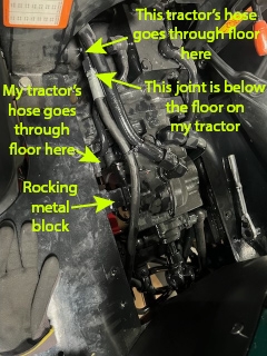

My hose sprang a leak at about 46 hours. The issue stems in my opinion—but I am not 100% sure—from the Gen2 loader having the manifold for the loader hydraulic connections up higher than the Gen1 loader, but the hose on the tractor feeding it is the same as the Gen 1 loader. This new manifold position causes there to be less slack, causing this hose to lie across the pivoting block connected to the pedal.
I am attaching a photo sent to me from another TX25, which I think may have a Gen1 loader. Here are my reasons for thinking the manifold location was changed, but the hose was not:
  1. The way this hose is routed in that photo of another TX25, make it clear there is much more slack, allowing the hose to be safely zip-tied away from the pivoting block.
  2. The hose in this other TX25 passes through the floor about six to eight inches further back than mine. There is no way my hose has the slack to go through that opening.
  3. The joint to the second hose that makes the final run to the loader manifold is above the floor in this other TX 25 photo. Mine is below the floor, about 12 to 16 inches further under the floor.
  4. The difference in height of the loader manifold between Gen1 and Gen2 loaders is about the distance that the location of the joint in this photo of another TX25 differs from mine. See the attached photos that I pulled off the web showing the different locations of the manifolds.
White 4768, if you look at the underside of your hose, you will most likely see two wear spots, one toward the back that is deeper than the other. The deep one, which will break first, is from pressing the forward pedal, causing the block's back edge to rock forward against the hose, and the shallow one is from depressing the reverse pedal, causing the block to rock backward and catch the block's front edge on the hose. Since most of the time is spent going forward, it will wear through first. Attached is a photo of where mine broke. I colored the hose magenta for clarity. I am calling in the morning for another update. I will mention this thread and explain that yours is the same issue and hose as mine. I think they will be having more of these happen because the hose is either too short, or incorrectly routed, or both.

Thank you for figuring out the root cause for this. Looking at your pictures it makes sense. I talked with them today they made no mention of anyone else having this issue and I think that I talked with every one there. Supposedly Summit is sending me a new hose.

I believe that we are needing #19 in the picture. Item # 300059050A PDF Page 70-71 of the Spare Parts book TX25

I looked at the parts catalog and at that hose #19, which you pointed out. It seems to be the one in question, but the hose it connects to in the diagram is not correct. The following is speculation on my part, but this is where I think the problem is coming from:
Firstly, the Summit TX25 clearly appears to be a rebranded and re-optioned Solis H26.
Secondly, the Summit LX85 Loader is not made by Solis; it is made by a loader company called Alo.
I suspect that the parts diagram is pulled directly from the SOLIS H-26 Parts Catalogue, as it is identical. Actually, the whole Summit parts catalogue appears to be the same as the Solis H-26 parts catalog, with the exceptions that the title pages changed from Solis to Summit and any model references are changed from Solis to Summit, with some pagination differences.
The photo on the front of the Solis H-26 parts catalog shows the H26 tractor with no loader or loader manifold installed, so it is the pure agricultural model of the Solis, on which the Solis H26 parts catalogue (and Summit's) is based.
The Summit only comes with a loader, but since the diagrams that show hose #19 are from the Solis catalogue, the hose that #19 is connected to is incorrect in the diagram because it's for the non-loader Solis.
I think that this is confusing the parts people at Summit.
The hose that #19 in the Tractor Parts catalog should connect to is #26 in the Gen 2 Loader parts catalogue. (See section "C" in the attached image)
So what I am saying is that I think you are correct with the hose you are specifying, but the Summit people are very confused. They really need to read this thread carefully to determine if I am correct, because they are probably going to be getting quite a few more warranty calls for this part in the near future.
All of this being said, the hose #19 may also be incorrect as it is for the Solis H26, and perhaps the Summit requires a unique, longer hose to connect the tractor to the oader manifold.

I talked with Joe at summit and gave him the part number to #19 and made him aware of this conversation and others that are that are having the same issues. In the past it looks like Summit people used to respond to this forum. However I was told they were sending me the hopefully correct hose.

I received the correct hose today, it was off of another tractor but it did not have a hole. So the part number that I posted is the correct one.

Are there crush washers in the banjo fittigs or to they just screw right on?
-Andrew
/ Hydraulic leaks
#20
There are crush washers in the banjo mine didn't come with any but Napa had them.
