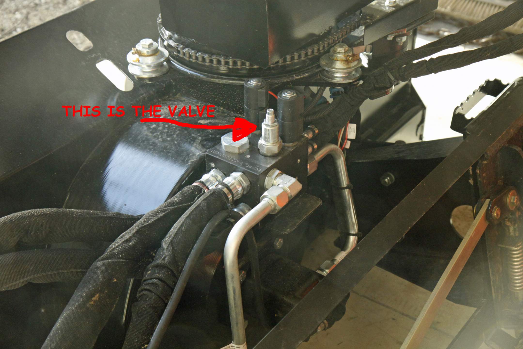

Call them and talk to their support department, I have a valve that I got from a forklift and I was able to get the specs (max GPM/Pressure/Open center/Power Beyond) with a phone call.
Parker might be able to tell you how much their pump “is capable of” but they cannot tell you now much 土ou really need for what you are trying to do

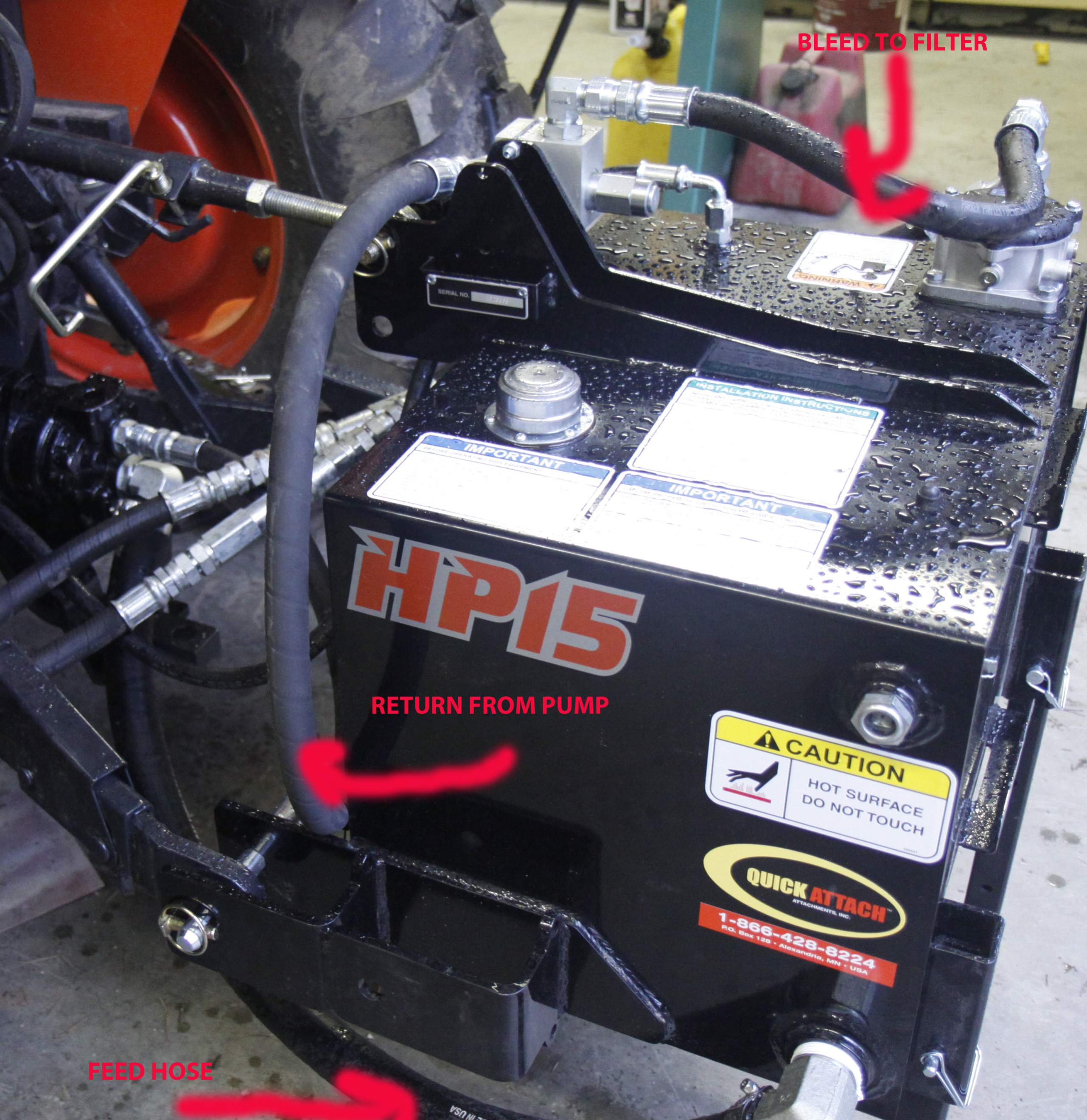

I think chooseing a hyd motor and then trying to match parts to make everything work is just plain working backakwards. What is the recommended hp required for the blower you are trying to use and what rpms are required to make it run properly. You can take those two numbers and do the math and come up with required torque/size hyd motor you need. Once you know how big a motor is required, you can again do the math and determine how much flow is needed to reach the desired rpms and how much hp is needed to turn the pump. Simply buying a large hyd motor and trying to make everything work will be a expensive exercise leading to much fustration with poor results.
