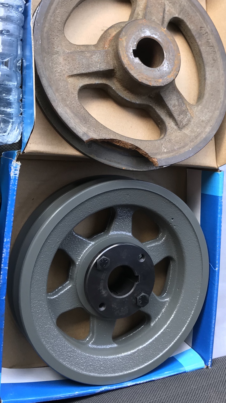

It’s not the $16 dollars because that’s pennies compared to what the mower makes me but the principal. I gave $50 for this deck pulley and didn’t feel bad about it. Now if they wanted another $20 relocation fee or some other bs that would be a dealbreaker. IMG_1484.JPG

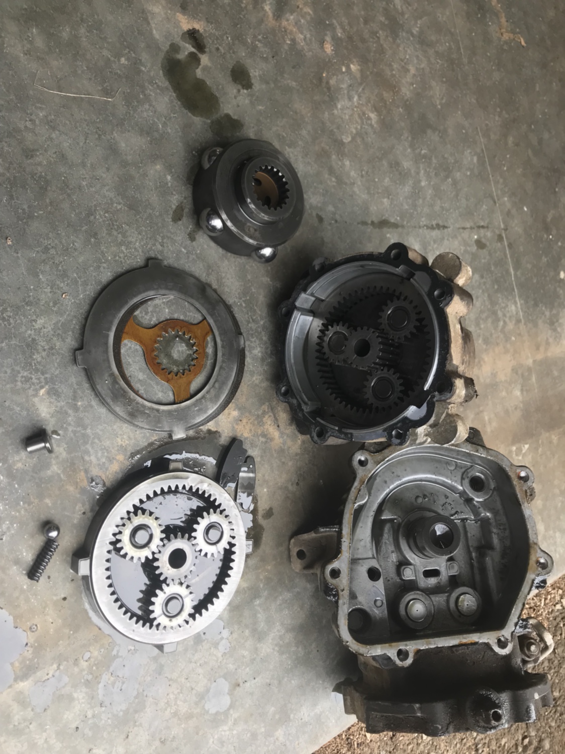

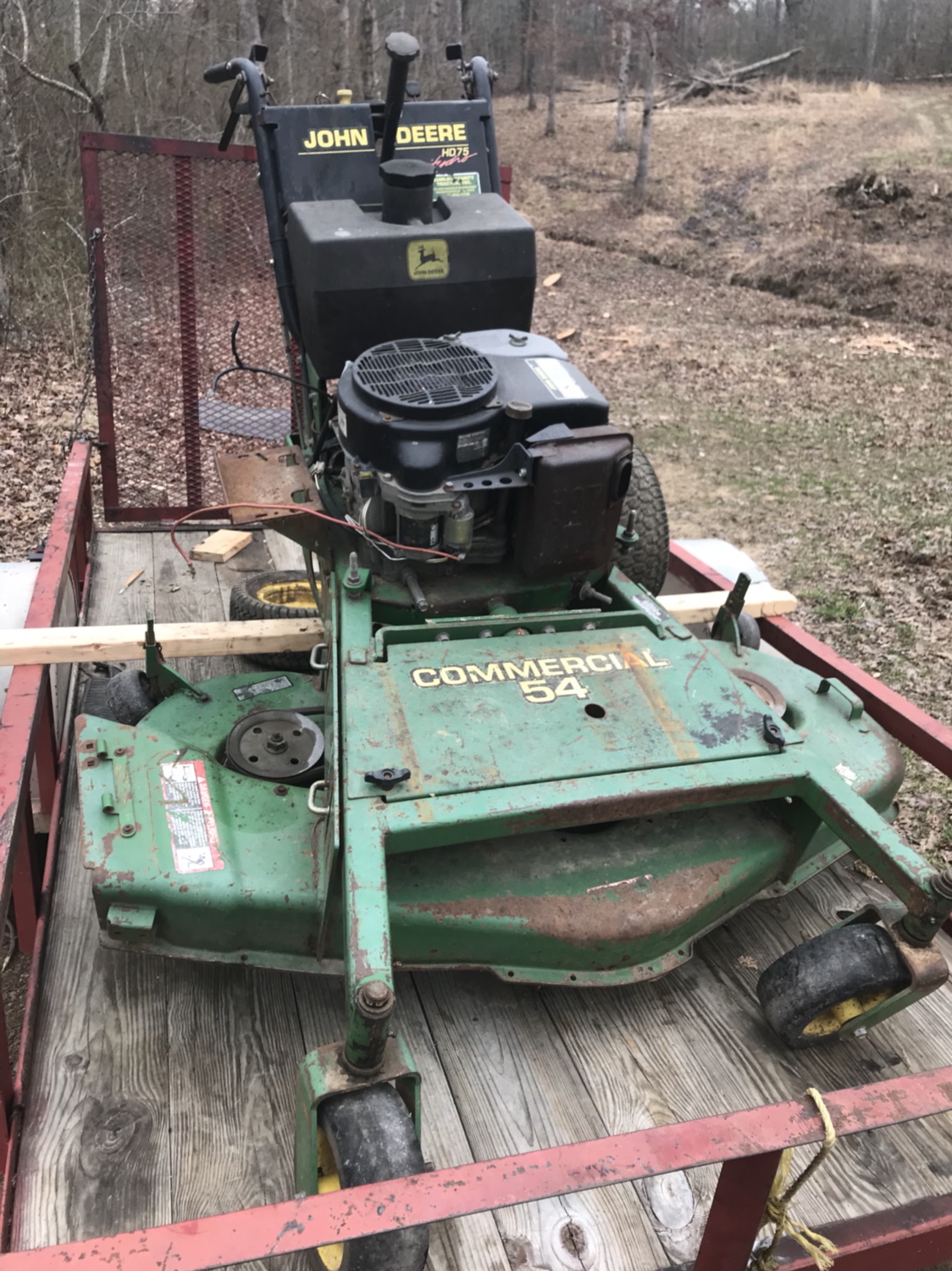

I’m pretty sure this motor will live to cut grass again. My John Deere one that’s full of metal I’m not so sure about. IMG_1489.JPGIMG_1491.JPGIMG_1492.JPG
