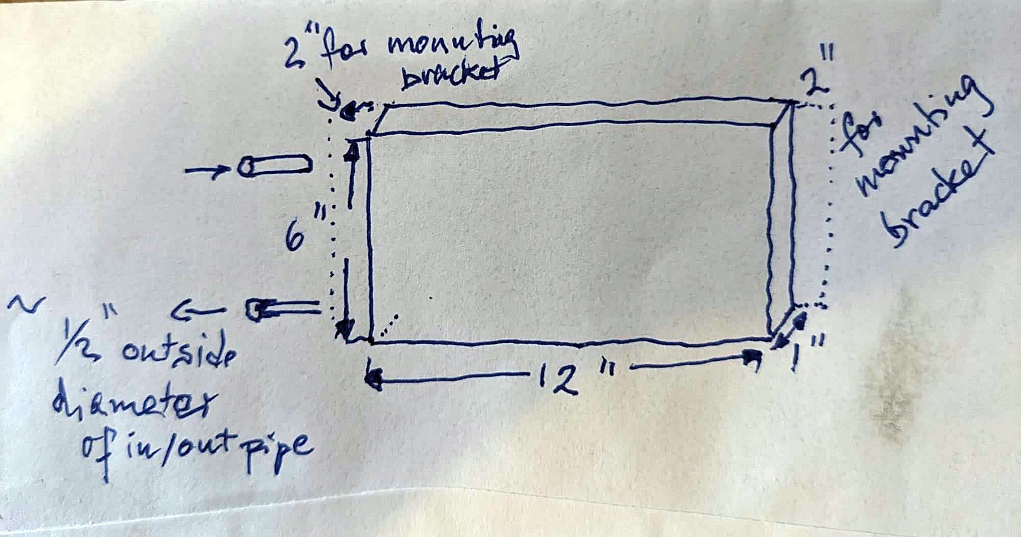

Give me dimensions I will call
My buddy at agco he has lots of used parts old cooler
Of a industrial tractor might work
Thank you.

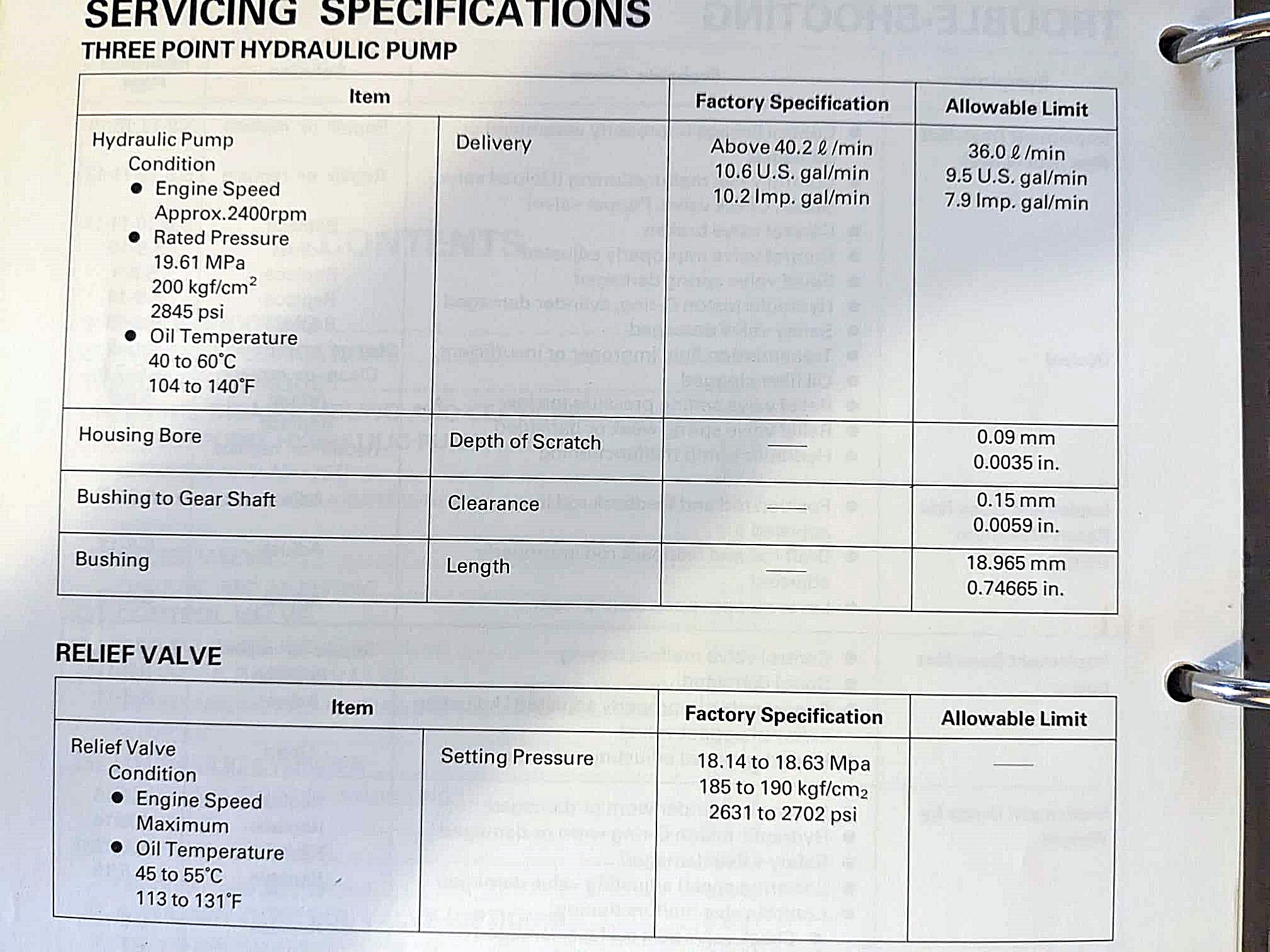

I am also adding the pump specs (pump works)
Pump flow13gpm / 49.2lpm-
