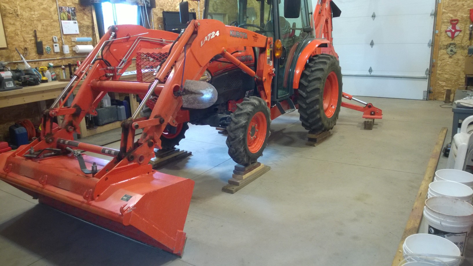

I screwed 2x6 together and drove up on the ramps. Gave me plenty of clearance for 5 gal pails, which are easy to handle.
I've used them many times now. Just did my 850 hour hydraulic fluid, plus front axle.

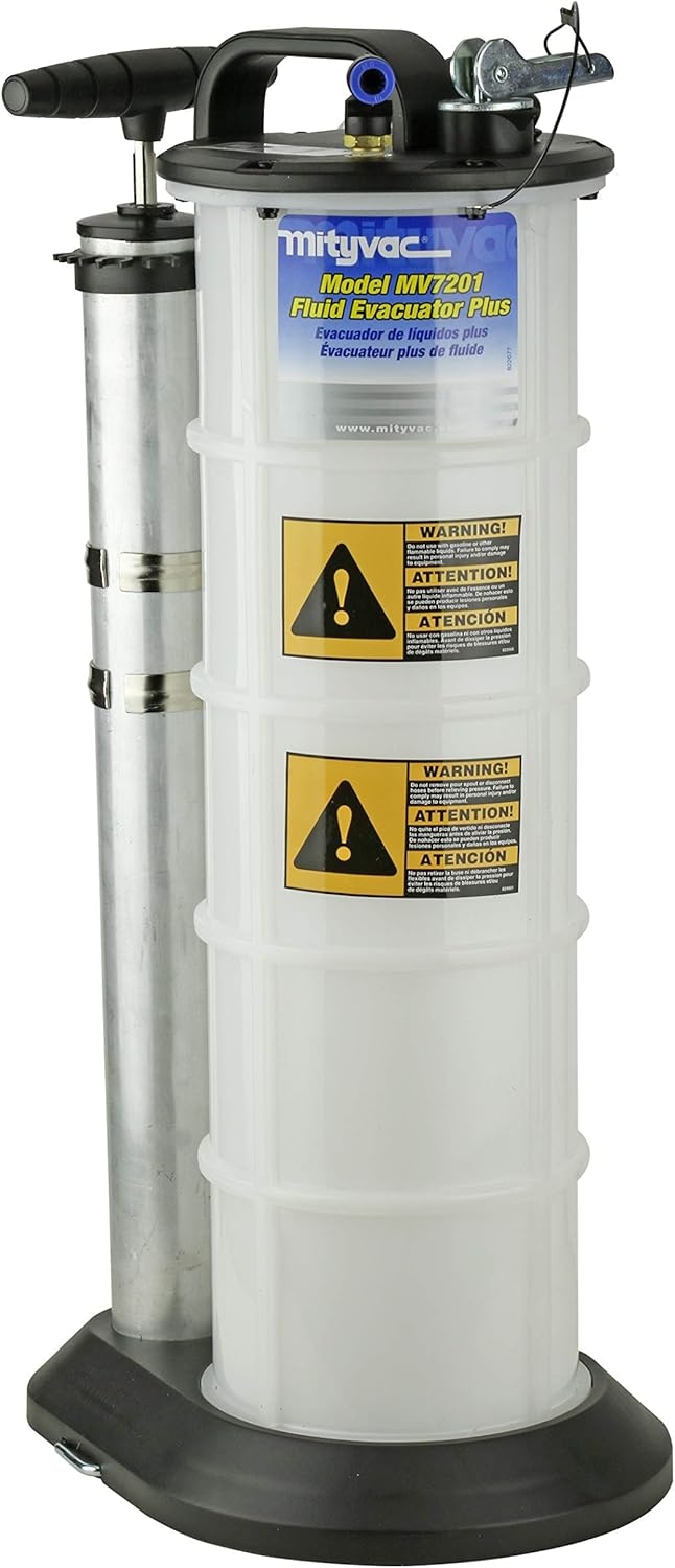

Draining the oil into a large pan is the easy part. Getting it into a container to recycle is another issue. My Kubotas both hold 15 gal of oil. A pan with that much oil is too heavy to lift and must be pumped into containers.
I use rScottys idea and evacuate as much oil as possible through the fill port. This oil extractor makes the job much easier:
It removes 2.5 gal at a time and can then be used to pump the oil directly into smaller containers.
There is usually 3 or 4 gal left that must be drained into a pan but that amount is more easily handled. I use a plastic dish pan for that, and use the extractor to put it into a jug.
