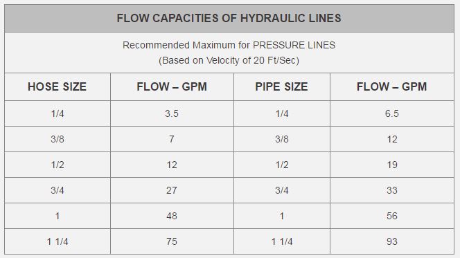

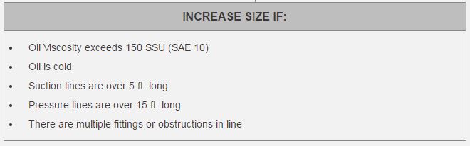

I don't think 1/2" hoses is big enough...
SR
   / Hydraulic power pack build #22
SR
I think your right.
From here: Hydraulic Reference Page - Mac's Hydraulic

inside diameter of pipes and hoses matter. going to small = lots of extra friction and loss of pressure to the motor. going to large and you just waste cash. NOTE inside diameter, not outside diameter of hoses and pipes.

3/4 hoses duly noted. As far as my tractor I believe it is around 10-11 GPM available and does not have the fluid capacity I feel comfortable with keeping cool. That is why I am looking at PTO mount gear pumps. If I can find a way to use a higher flowing pump I will. If anyone knows how I could do this feel free to chime in. I know a little about hydraulic systems, but never designed one haha. As far as the direct drive VS gear box, I thought even Direct drive units went on to a torque hub which usually uses a planetary thereby making them in essence still use a gear box...
