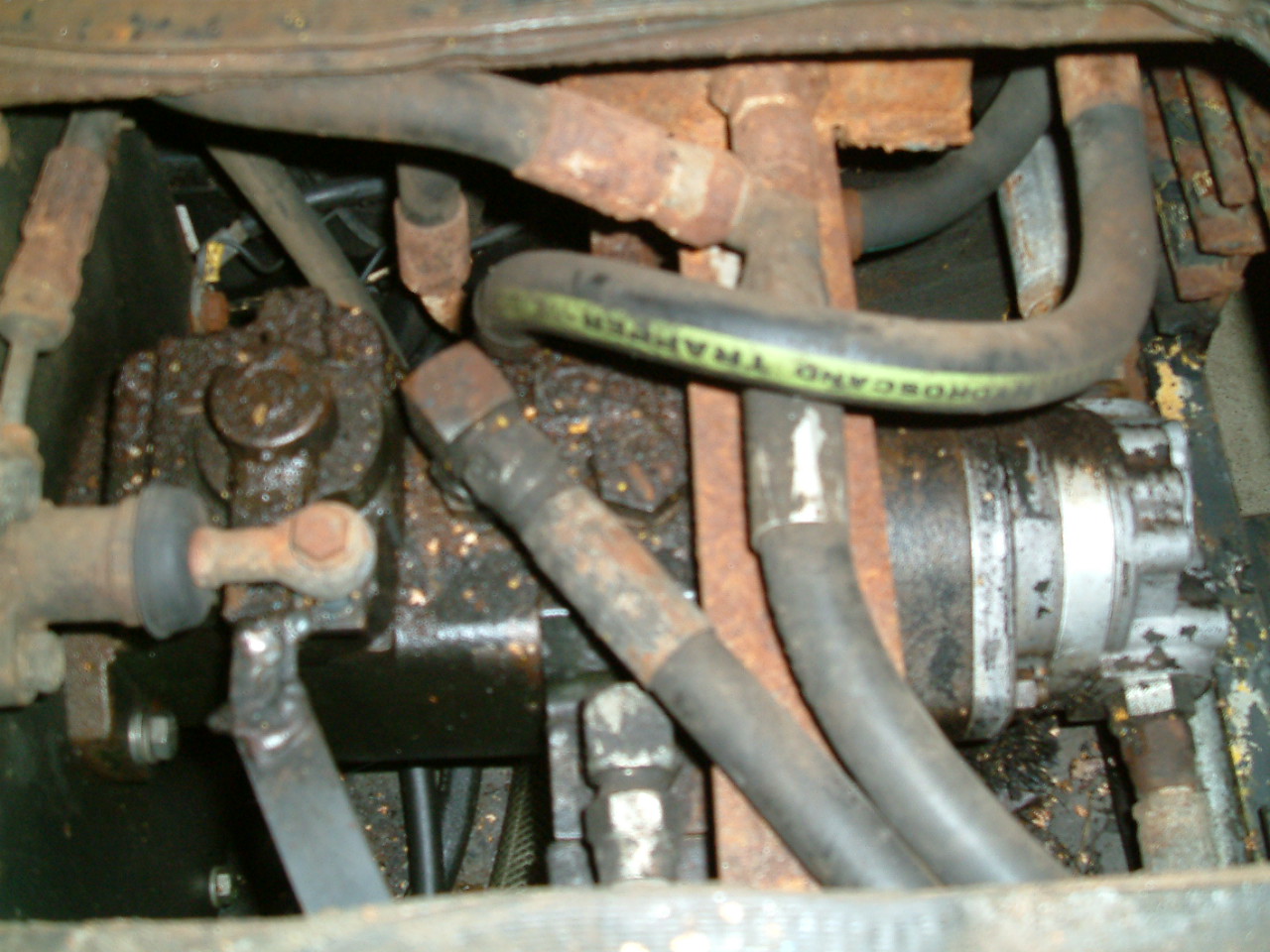

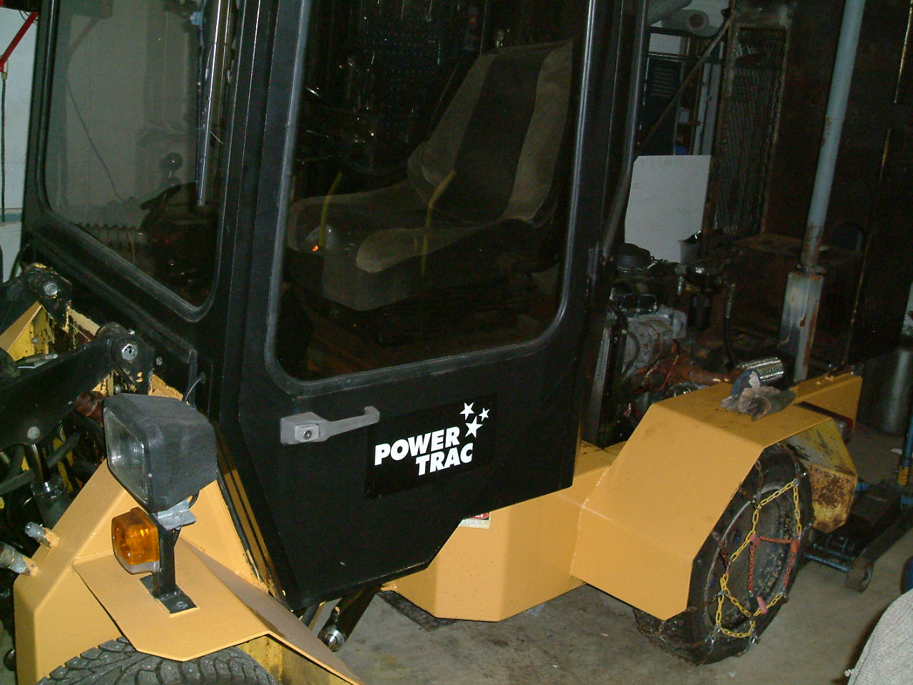

Hi,
I am from Sweden and a new user on this forum. Have hydraulic problems. It run slow when I bought it and I have repaired one wheel engine and tested.
Should move some gravel when it stopped with a "jumping pedal". Not moving forward or backwards. The lifting and steering works but not so strong and a little slow to. I think it is a PT 1850 early modell and have a Kubota 4-cyl engine. Can not se what the mainpump have for brand or modell. Anyone that can tell?
See pictures. Need also the circuit for hydraulic to trubleshot.What can be wrong?
I am in a hurry because the snow is falling and I have nothing to move it with!!

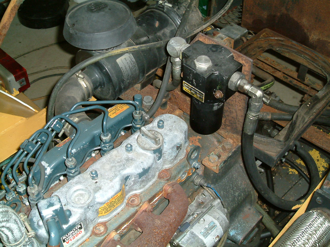

Have you changed filters?
The charge pump pressure has to be correct also, and should be pumping about 10 percent of VSP pump volume .
Relief valves in the pump might be fouled.

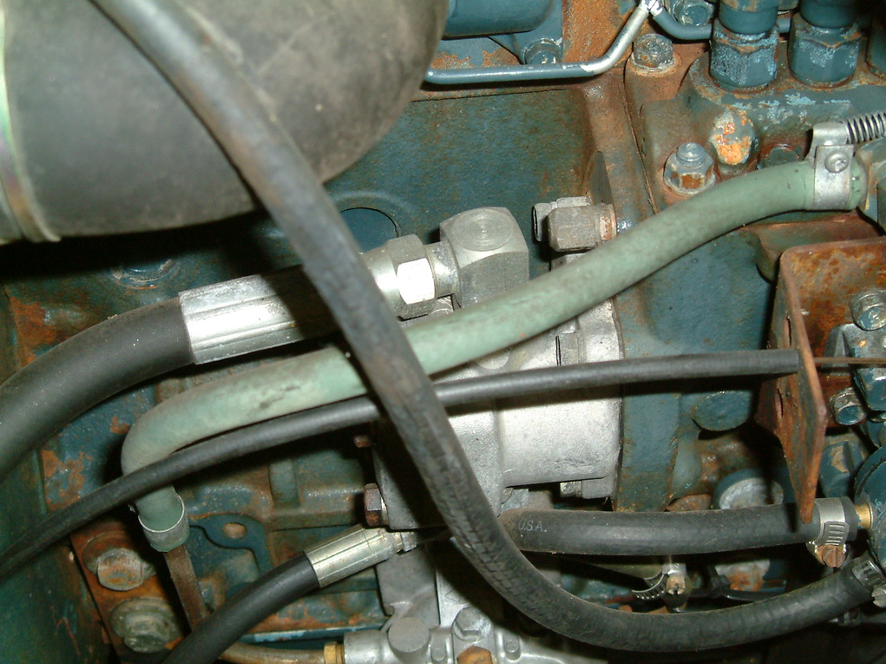

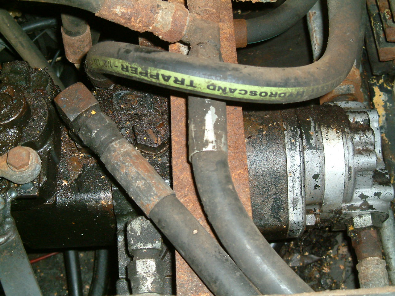

Thanks for troubleshooting help. I will test to lift and see if it moves. It worked at first and then suddenly stopped, so connection is not backwards. The back and forward drive is working with electrical valves. Maybe this is something wrong with?
See attach images. Is the small pump at right side on Kubota engine a hydraulic pump for steering. Is the dualpump with axial pistons nearest engine ( drive ) and gearwheel back ( for lifting and tilt ). Anyone that can tell what brand / modell. Hard to get spareparts otherwise. The mainpump, is it difficult to repair? Expensive?
Buy a new? I am not skilled at hydraulic, but work as a tool engineer and have worked a lot with engines, in particular with chevy smallblocks.

Your machine has a serial number and Terry should be able to tell you how old it is.
Ask the parts guy for a parts list.
I would wipe and clean the pumps, and use a mirror or put the camera under the pump and take a picture.
The numbers on my pump were on the bottom.
The pump on the rear of my tram pump is the PTO pump.
Where is your third pump located?

Not sure what the model of pump it is but it looks similar to an oil-gear piston pump, old style with swash-plate over-center design (used in closed circuit hydrostat systems)
It looks like a tennant sweeper pump I worked on a few years ago, If it is then you may have had trouble with contaminates from the drive motor repair spoil your pump....it is always best when you have drive motor issues to remove and clean, lap, reseal and reassemble pumps along with new oil and filters when doing any repairs in that drive circuit
By the sounds of it the charge pump may have locked up or your rotation group/swash plates in the pump may have failed.....or the original parts that failed in the drive motor are still floating around
If I see it correctly, the front pump design you have is a variable piston pump with over-center swash plate (connected to the lever) to give you forward and backward motion for the drive motors

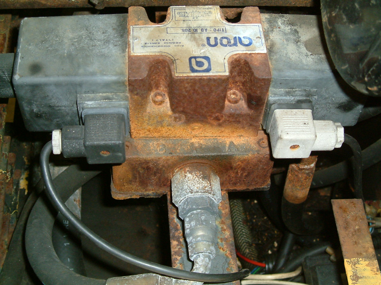

// PowerT1850
Oooo, Sorry i missed that......having a solenoid valve changes everything...is the output of the pump going into the inlet of the solenoid valve base??...maybe the variable pump is changing it's direction thru the solenoid....if that's the case then there should be a manual override on the end of the solenoid coils......best to try those overides while the drive wheels are off the ground
/ Hydraulic problems Power Trac 1850 #13
also, another tip......to check if the solenoid coil is electrified, use the steel blade of a pocket knife (one that a magnet will stick) and touch the end of the solenoid coil to feel the magnetism when engaged, if the coil is energized your feel it
This will not show if the valve stem is stuck in the housing, but the manual overide push pin (if it has one in the center of the solenoid coil area) may clear the condition if it is stuck.........the valve stem should be spring centered when not engaged electrically

Looked at the solenoids. You are right! The magnetic power workes but they seems to be stuck, have removed the colils and iron unit to make them move again. It is the solenoids that switch forwar/rev. If this dosn´t help I will lift the lid under the "speed control arm" and have a look!

I have removed the pump. It was just the manual overrides that was stuck on solenoids, the electrical function is ok. I really need to know the brand of this pump ( Se picture ). Is it a good idea to have a look myself inside this or let a profesionall gay handle it?.Hydraulpump 2012-10-12 008.JPG
