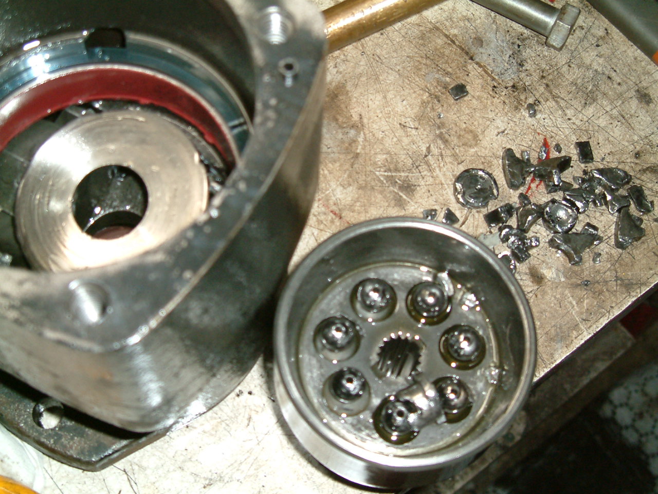

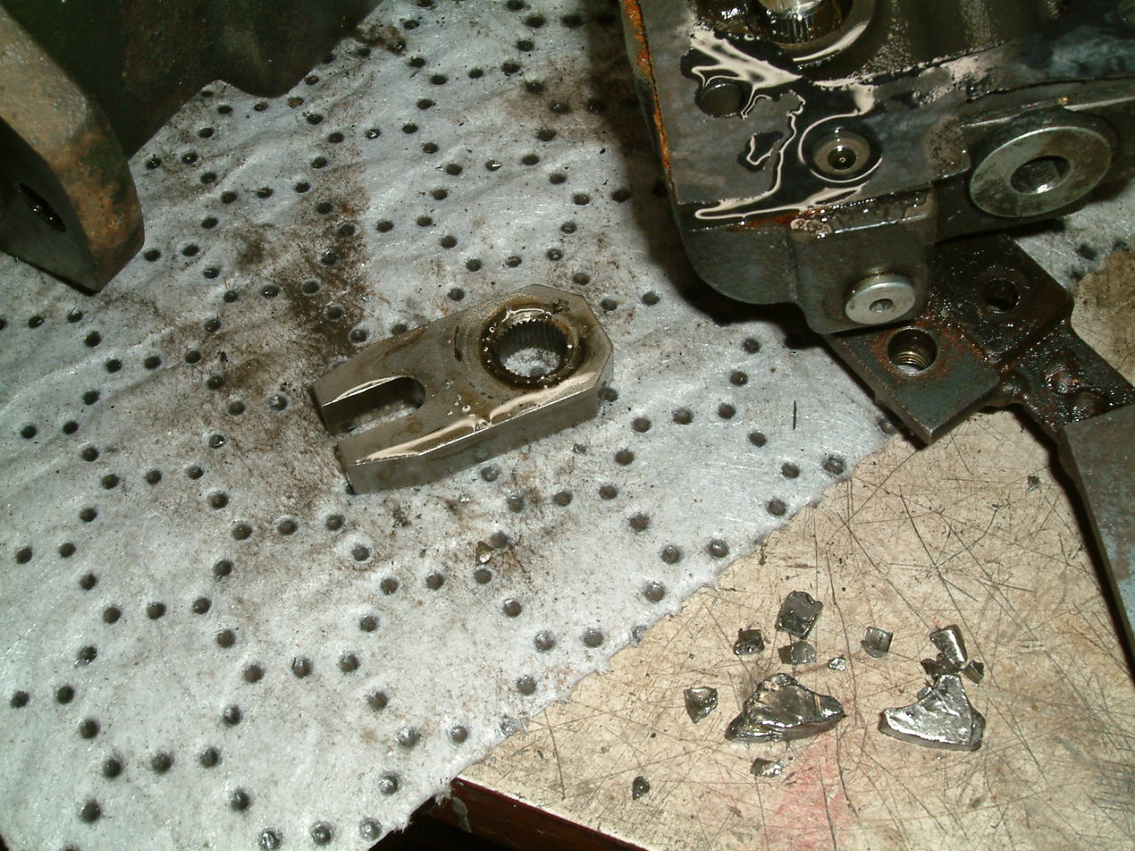

the best is to tear down the pump completely......assess the damage, look carefully at the mating parts on that rotating barrel (you'll see where the valve plate meets the barrel) those surfaces need to be not scored......
Look at the pistons.....the shoes on the end should not be flopping loose
Please take a bunch of closeup pix of more damage......
Those parts are avail but depends on just how much is needed to repair
Even after you rebuild or replace pump, the components connected to this pump need tearing down and rinsing (including the hyd motors), if not the debris that is floating around between the pump and motors WILL do more damage if not flushed out
It's entirely possible the hyd motor damage from the original repair was was the pump coming apart and throwing debris into the hyd motor

Did not look good when I shared the pump.(See attached). Wondering if anyone can tell if this pump works in conjunction with these wheel motors? I dont think I have original now, in front (not connected) Danfoss and rear Roller Stator. If I buy a new pump I want new wheel motors aswell. Also need a simple circuit to connect this right. 014.JPG

That doesn't look good, needing a new rotation group at the very minimum, pricing out a new pump may be wise
Was there any original pump ID number on your old pump......the new pump you have a link at Surplus Center looks like the rear aux pump has the wrong mount and a different gear pump (smaller)
Don't forget these pumps are put together using different displacements, mounts, shafts and ports......sometimes you'r just as well not getting from a place like Surplus Center cuz they offer "surplus" excesses from other companies that cannot sell them, that way the price is cheaper but the model codes are different

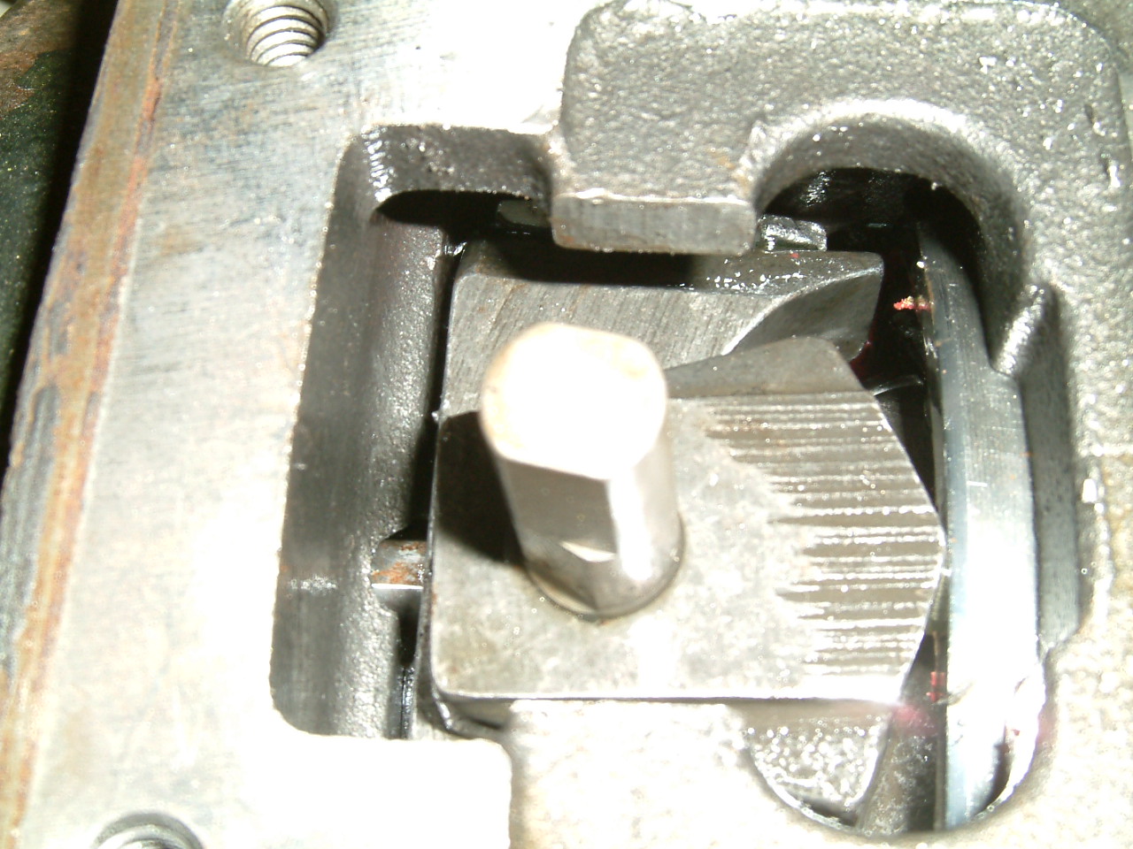

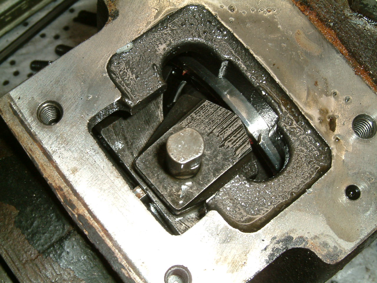

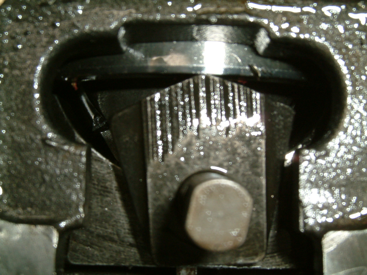

I use a solvent based cleaning tank w/air to clean hoses while off the machine......looking carefully you'll probably need more parts than just a rotation group to renew the pump (swash plate, valve plate, bearings ect)
Any way you can get the factory people to come up with a model code..??......with that you can figure out what the displacement is and possibly change it over to a different brand if parts not avail
That link on the Tennant sweeper may be helpfull as far as an exploded breakdown sheet but not for part numbers (cuz they may be from a different size pump)
