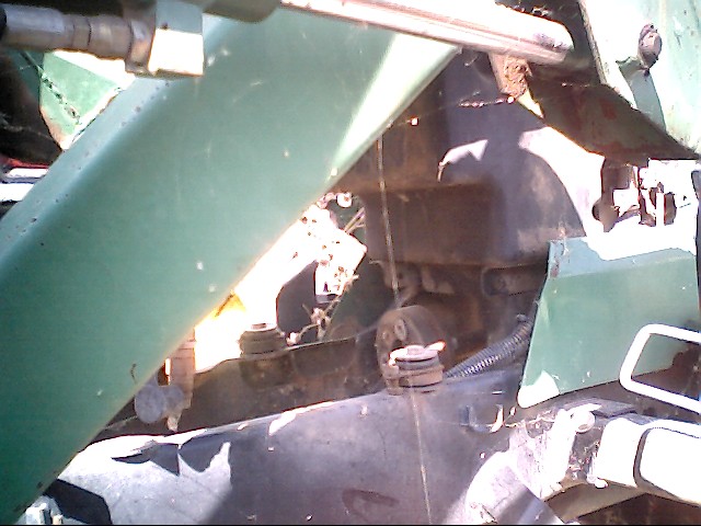

To remove the driveshaft, I'll have to remove the fuel tank.
As I recall, when you remove all the sheet metal, you can detach the
driveshaft at the U-joint just above the filter between the frame rails. Or
you can disconnect the shaft at the rubber coupling below the fuel tank
without removing it. That allows you to keep the HST/gearbox all together.
If you take all the linkages out, you can toss the levers used as a
mechanical interlock system for the go-pedals.
