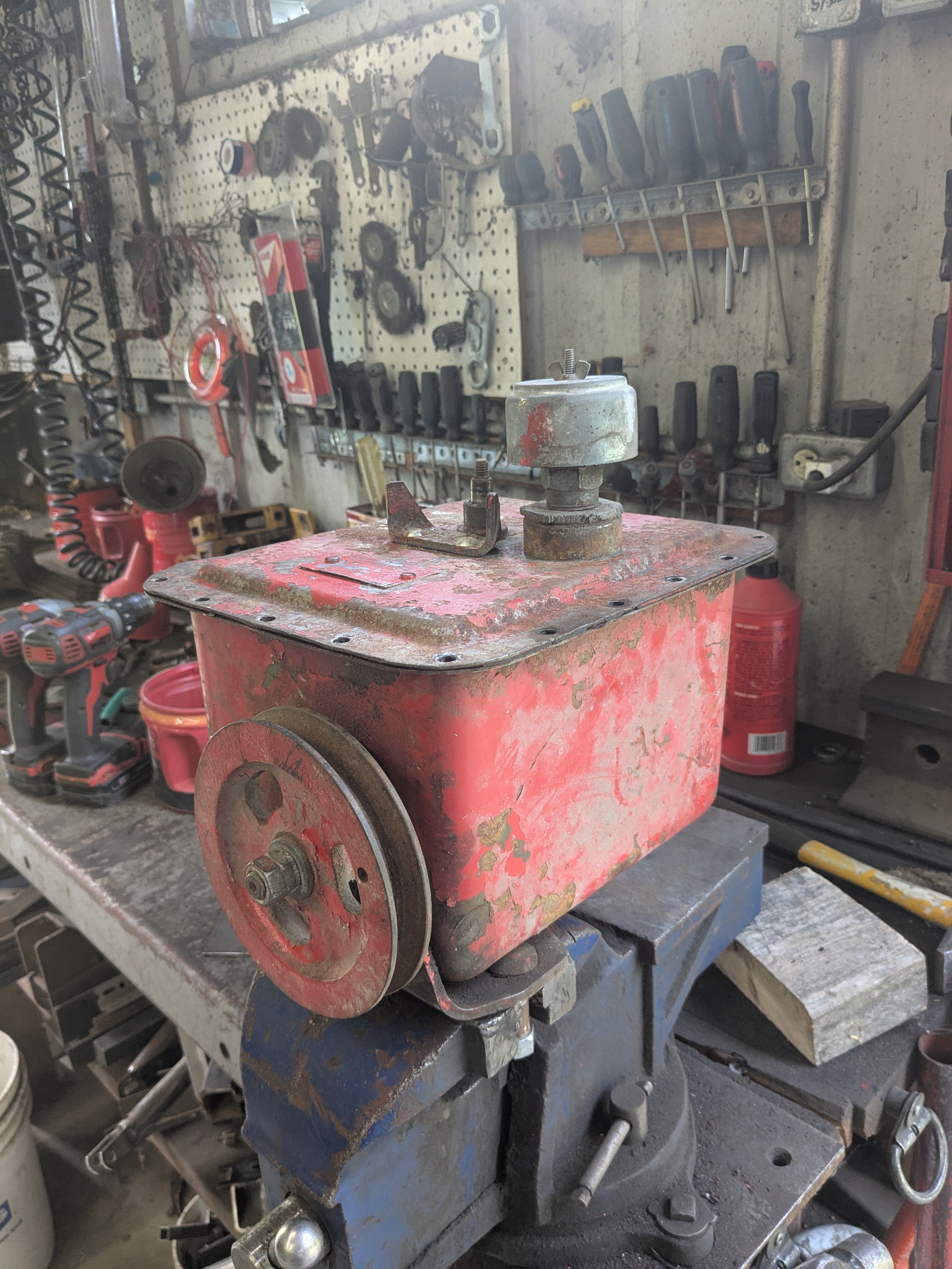

Does anybody know what kind of hydraulic pump this is. And is the valve double acting, it is a spring return to neutral. The label on the reservoir says Bendix Lakeshore division but that's about all I can read.

Yes it’s a pump, valve tank off an old combine. It was used to raise the header I have a couple of them I bought at an auction. They are single action power to lift the header and gravity down.
/ hydraulic pump #3
If gravity down the valves are not double acting.
