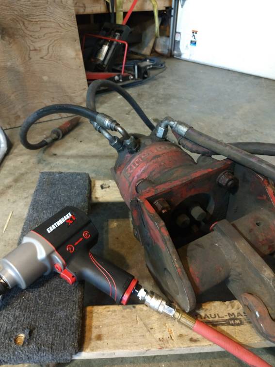

I know nothing about these. Why 4 lines? What should I be concerned about? Just looking for a little education.
Luke,
Is the lifting hook welded onto the lower stub shaft? I suspect that this was originally set up to have two ports for the rotate function and then two connections on the lower rotating stub shaft for an auxiliary function like clam shell grapple.
   / Hydraulic rotator
#26
Luke,
I'm not smart enough to know which is the lower stub end. :D
There are plugged ports down low on that end which I now assume are for a rotatable auxiliary function. I plan to call about schematics tommorow. You can see one in the first pic.
   / Hydraulic rotator #27
I am wondering if that rotator is a full 360* rotator. Some of the older stuff wont do a full 360 degree spin and hoses for aux functions are plumbed using lines going all the way to the other function instead of passing thru the rotator. These types are not as desireable, (well as least not too me), as the full 360 rotator models as you have to be very careful using them so as to not wind your hoses up in a knot. It it has 4 hose connections at the top and then two connections at the bottom, then it should be a pass thru design. I can only see two hoses at the top in the picture, doesnt mean the other two ports are not there or that they are there and maybe just plugged. I passed on a complete grapple assembly for $200 before buying my rotator because it wouldnt rotate a full 360*, plus it was way bigger than what I needed or wanted.

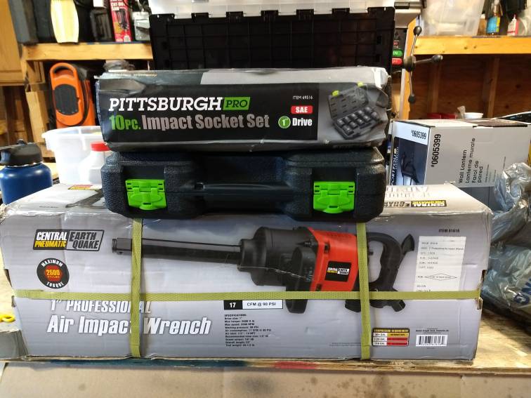

So I have been unable to break these bolts. Including with the nearly new Impact driver in the pic and propane heat (don't have OA right now)...
So looked on FB garage sale page and bought all of this along with some 1/2" hose for $150 total...
I will report back. I think I need to play the lottery. And yes I have enough compressor.
   / Hydraulic rotator
#29
Yup, that did the trick. Much more manageable weight now too.
Fittings look to be some kind of ORB to JCB. The partial manual I got is nearly all in German and the bolts were metric so I was happy to see what I think are JIC fittings (haven't looked closely yet).
