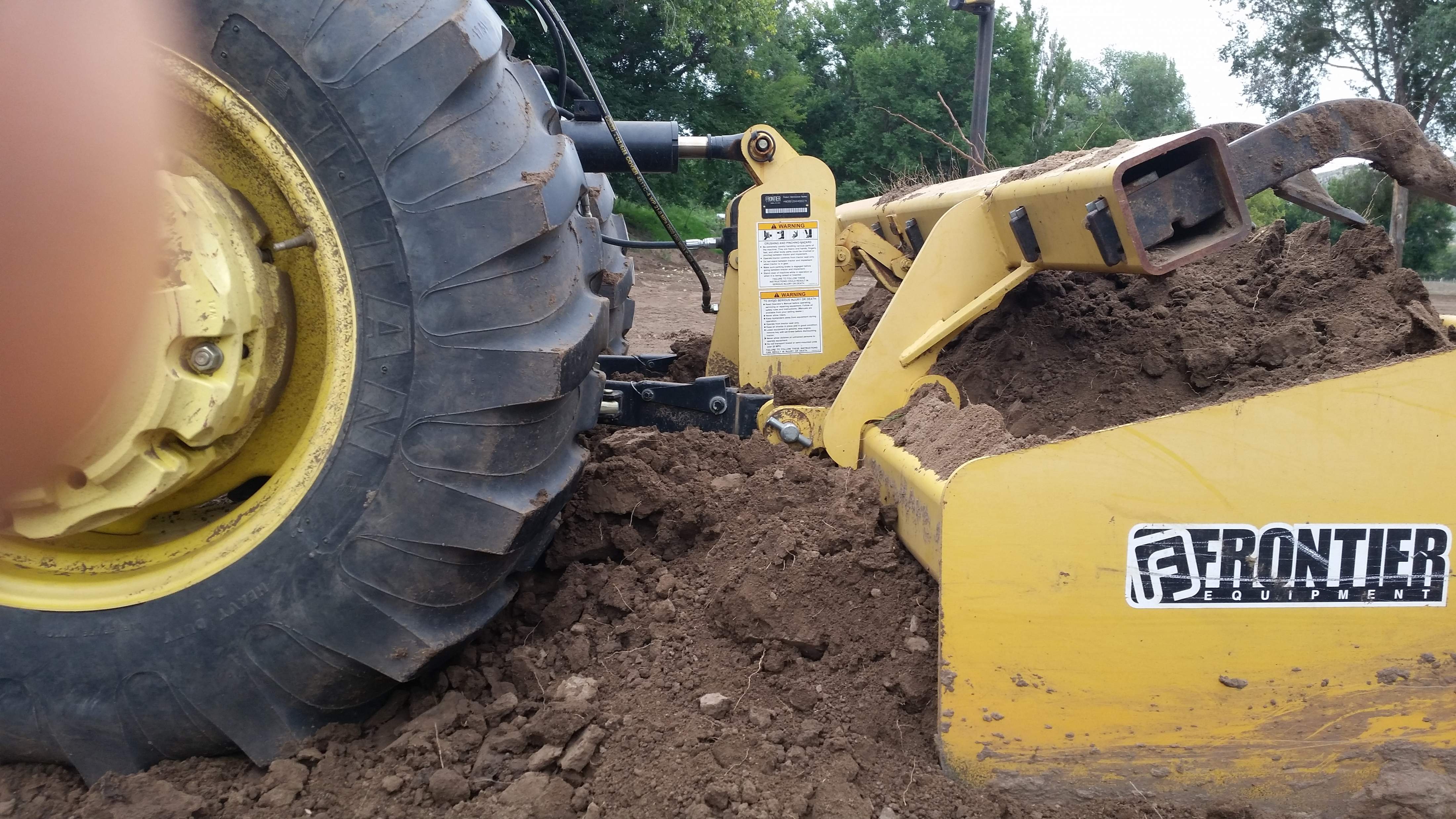

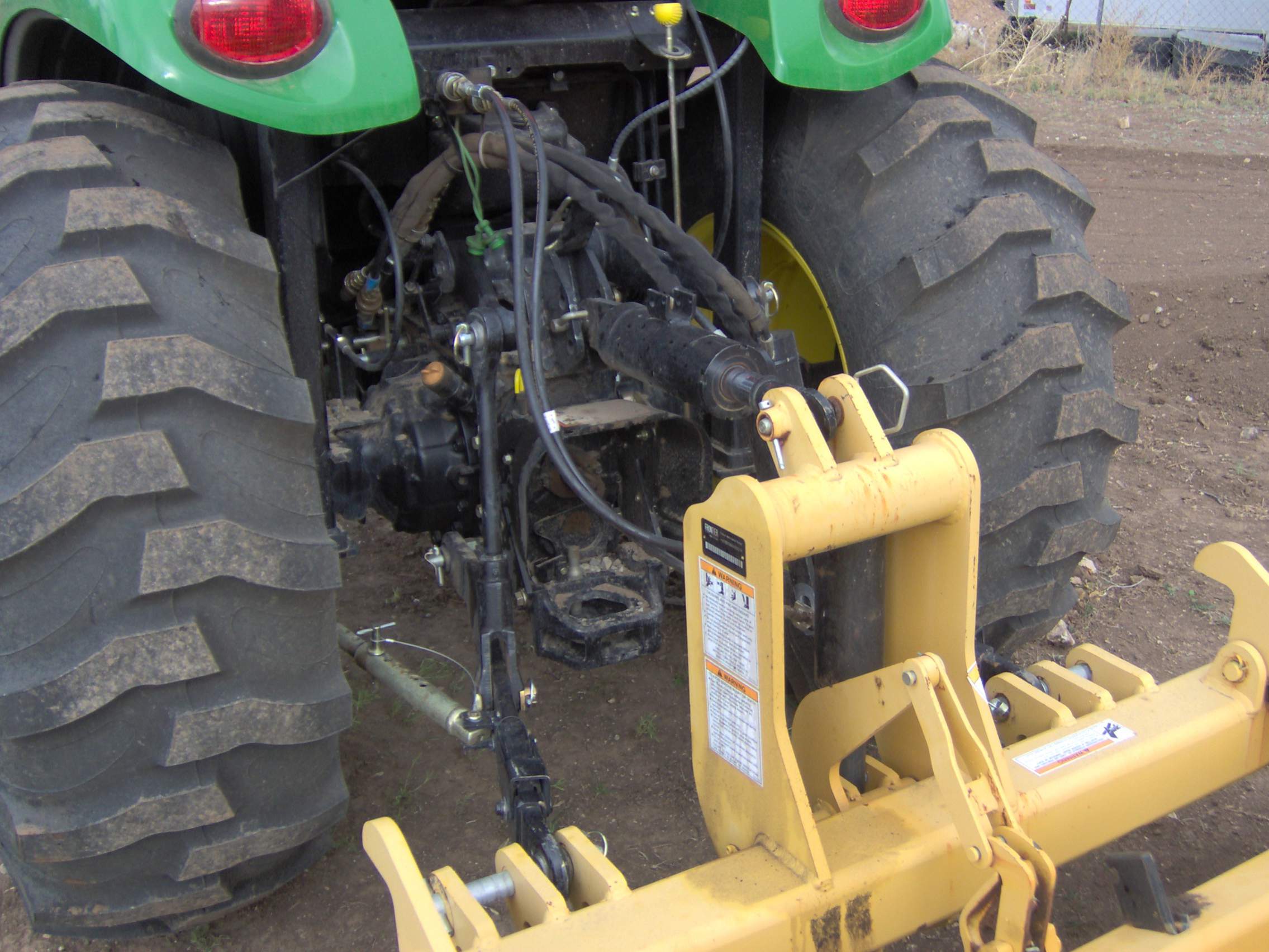

I have an original older Gannon, 80" with hydraulic rippers - bought it along with an original Case 3ph that replaces the hoe on older models - the hitch has TnT, power down, float, etc, but is a PITA to swap for anything less than moving several 100 yards at a time :mad:
Now I just run the BB on one of the other tractors, but ran into the "too tall tower" thing when I started setting things up for QH - Since the object of the Quick Hitch is obvious in its name, I decided to mod the Gannon rather than my brand new 6' tiller, etc... Here's the sketch of what I did, works fine.
OK, for some reason the board doesn't like my jpg - this one's a newer Gannon I had a pic of, and that one loads fine :confused2:
Basically, I made 2 pair of form fitted add-ons out of 5/8" bar stock using a cardboard template, then made patterns out of masonite to cut them with the plasma, and full penetration welded them on top and front of the existing Cat1 hitch ears. New holes 2" up and an inch forward and the QH now works fine. (YMMV)
Still don't know what's wrong with my Paint sketch, sorry... Steve

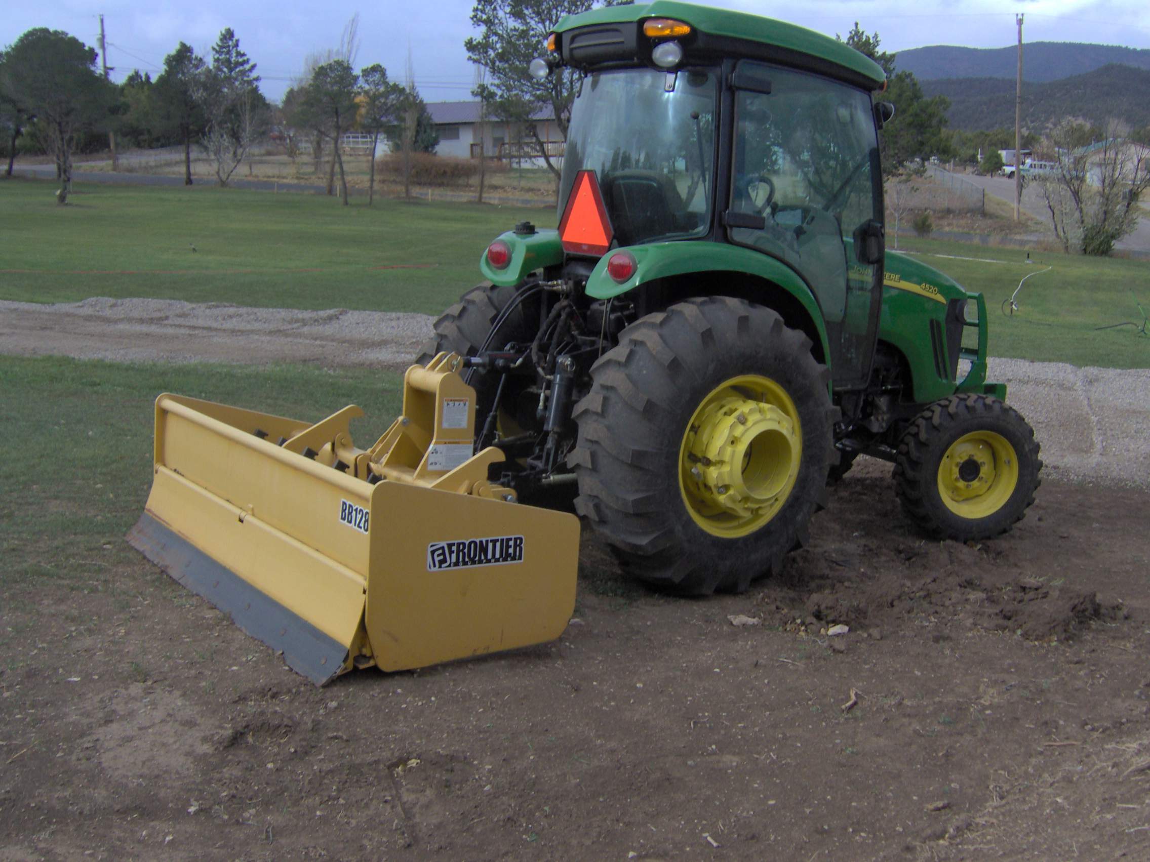

Will be very interested in seeing this modification when possible. Everything I have is quick hitch except my Frontier/Gannon BB1284. I need to fix this right away.

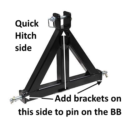

With the size and power of your tractor, I would make an adapter that would pin to the BB and fit the quick hitch.
