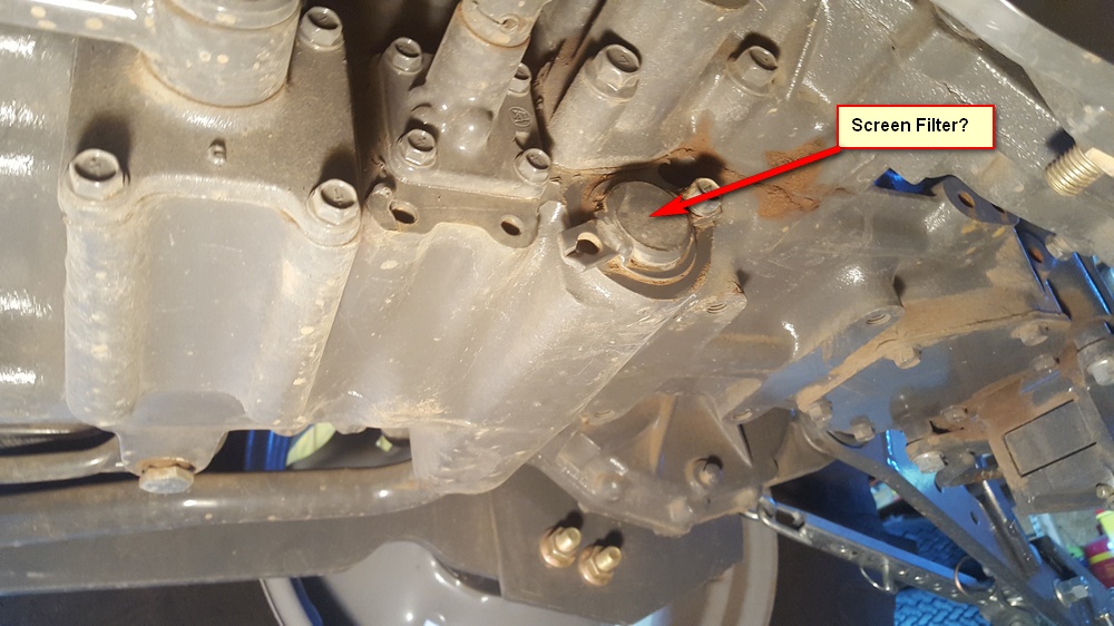

Not sure where the screen is located on your machine, but I scratched/cut the screen on the threads when I was removing it (and it was a little pricey to replace). It was held in place by O-rings and I kept trying to turn it to continue to back it out, so I was spinning the mesh part on the threads. Learned my lesson and the second change was a lot more successful.
So be extra careful if you are removing it.

Thanks Johnny B. I will be changing the oil and cleaning the screen in the next week or two. I will report back what I find out. Hopefully it is the Traveller fluid and not something else. If it is that will put to rest the old debate about the different brands of fluid.

Got everything ready to change the fluid tonight after my day job and wanted to make sure that this was the screen filter that I need to remove and clean. 20160606_180212[1].jpg

I changed the fluid tonight and cleaned the screen filter. There weren't many metal shavings on the screen. I took it out after changing the fluid and moved a bunch of gravel with no squealing at all. The squealing was clearly caused by me being a tight ***** and buying the cheap TSC hydraulic fluid instead of the permatran III.
