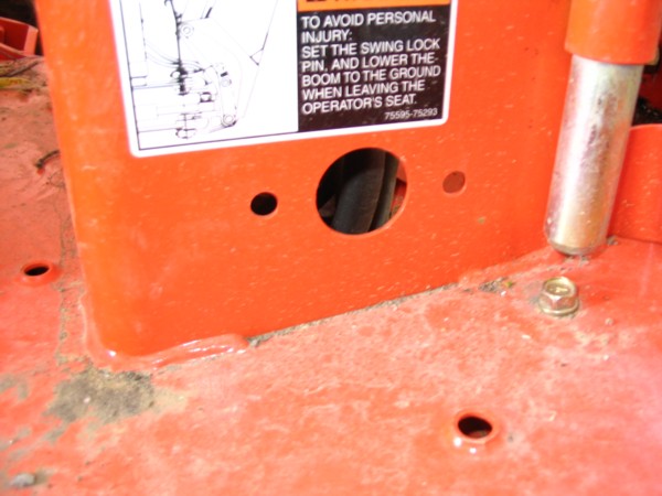

Upon further inspection, here is what I found for attaching some kind of control petal or stick. I'd love to have a foot petal for the thumb.
Below is the exterior view /forums/images/graemlins/cool.gif

Here is the interior view. You can see where the hole to the deck is in relation to where the extra spool is supposed to go (holes on the top to hold the valve in place).
I wonder what they had in mind for that hole with the little bolt holes. I think I'm off to the local dealer to find out. They just got their first L39, so they're not too familiar with them yet.

So I just spoke with the local dealer and they were little to no help, aside from the fact that the side hole is definitely for foot petal. Apparently the L48 has the same setup. This is good. Now I just have to find the parts. Not sure if Kubota makes them yet. The dealer said "aftermarket" only. Not sure if they were too lazy or just didn't want to deal with me because I didn't buy the machine from them.
Good to know that there was thought put into the situation and they planned for it. Now I only need to find the parts.

Probably a lazy dealer. The valve that was in mine was a nabtesco. I searched high and low for spools for this valve. Nobody carried them. I was told in another thread they are built just for Kubota. Talk to another dealer. We ordered it as a replacement for a defective one but not under warrantee.
Typically foot pedals are for extend-a-hoe operation but it could have just been forsight for another use.
Is the hole lined up under where the would be thumb valve would go? If it is it would be fairly easy to fabricate a lever that would be foot controlled.

Yes, the hole lines up perfectly under where the extra valve would attach into the bank of valves. We'll see what Sky's dealer comes up with soon.
When you added a valve to your bank, did you have to take apart the complete valve bank, or just remove the last in line and put antoher in? Can you give me some details on how that operation went......
