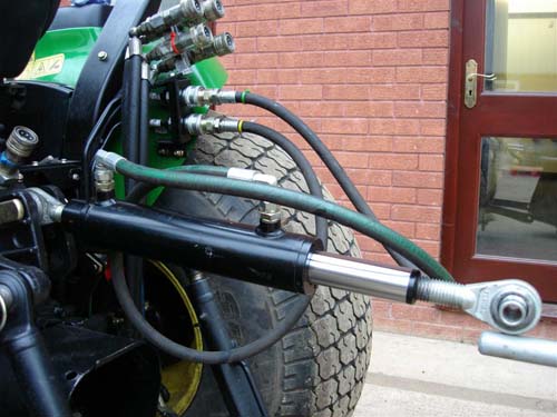

However, I have found a slightly different kind of hydraulic top link. I think this allows you some manual movement as the ball end screws in and out. So, if I get the length nearly right on the hydraulics from the cab, I can should then be able to make a small adjustment outside. Saving a few trips back and forth to the cab! The only trouble is this version is much more expensive.
That one looks like a good alternative.

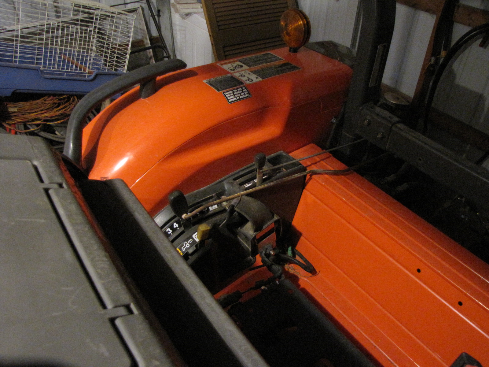

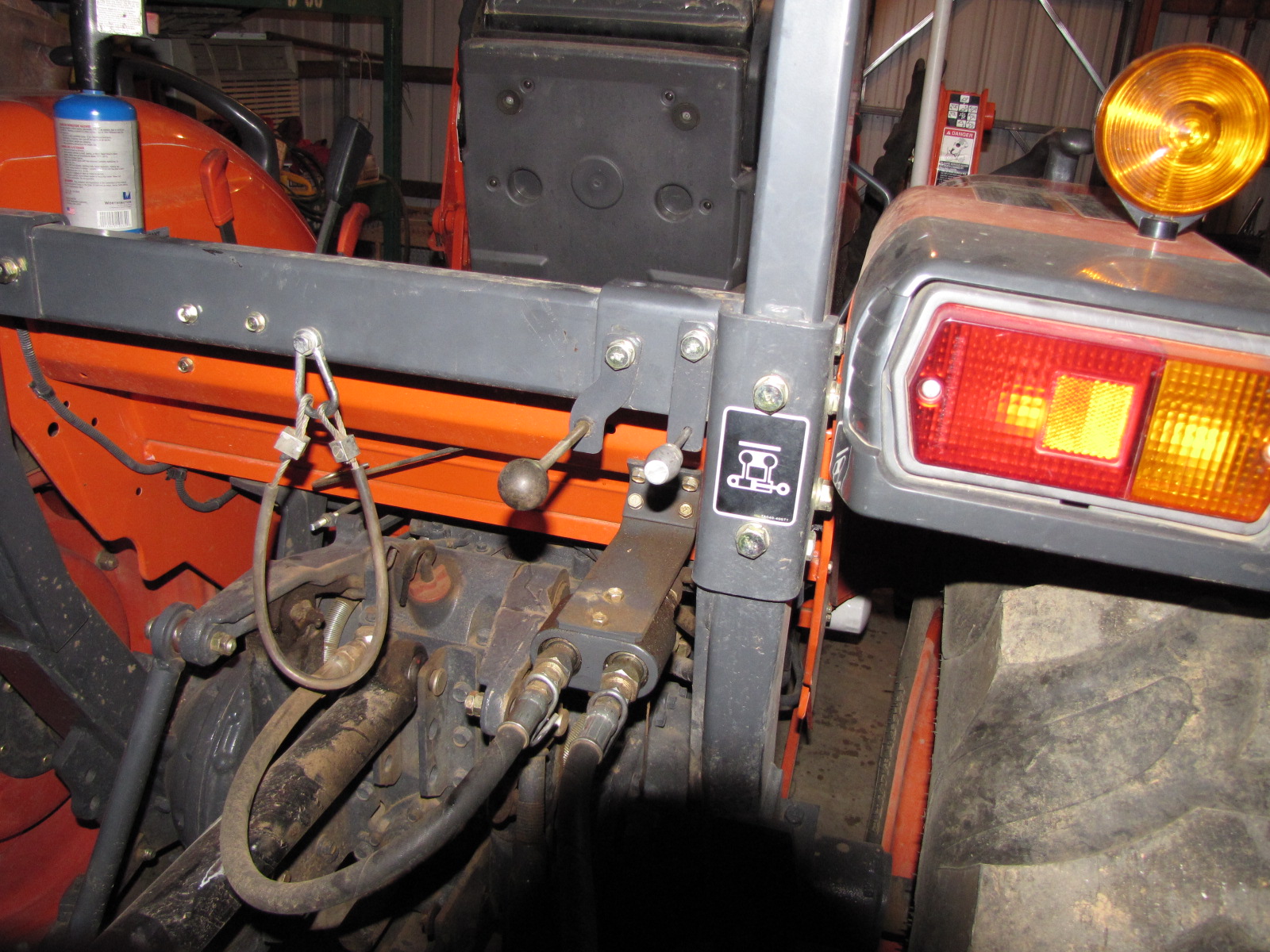

This is how I did mine. Was going to put nicer knobs on , but haven't yet. You well be so happy when you do it.

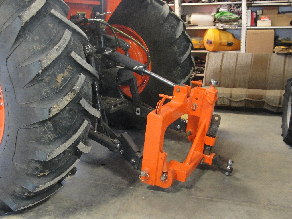

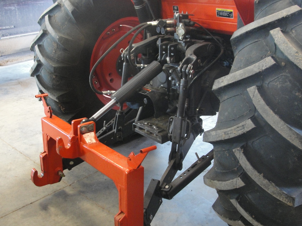

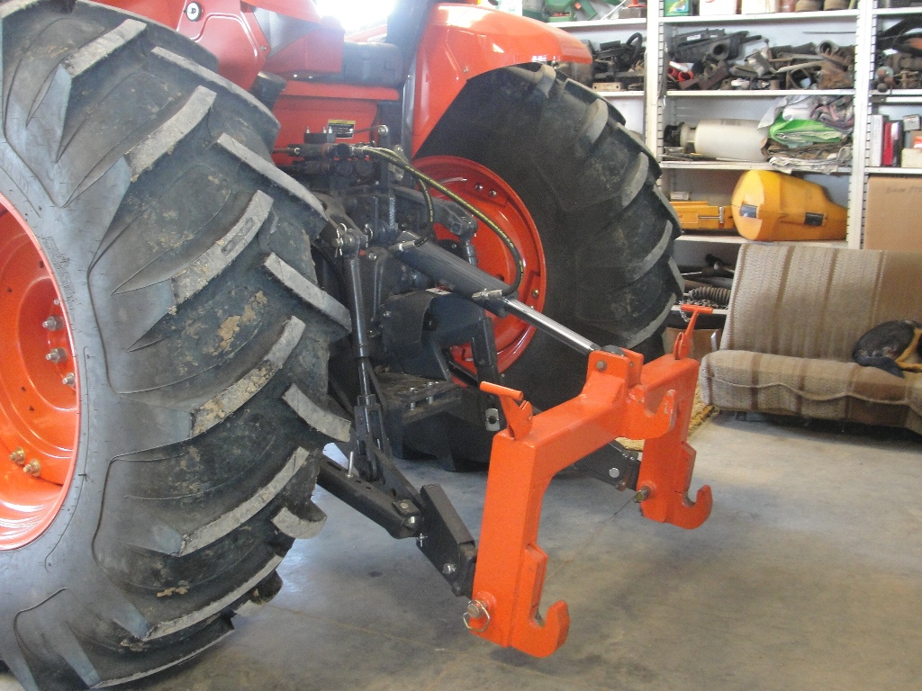

4. Add a Quick Hitch to the 3pt and hook up while setting in the seat.
Here's what SSdoxie is talking about in regards to a Quick Hitch. Your implements must be compatable. Allows hitching without leaving the seat.
ahhh, right, got you. That is a cool idea. I can see how it would be a lot of work (or in fact impossible) to alter my existing implements though.
There doesn't look to be any locking mechanism, how does that work on the quick hitch?
There are spring loaded hinged tabs that swing out over the lower pins to keep implement locked on. In the picture those T handles on top are pulled back holding the lock tab open. Once you get back in and all 3 hooks engaged get off and snap the lock levers closed.

I like the looks of the top link in your picture with the ball end that screws in or out. Would you mind passing along the website that you found that top link on? Thanks.
