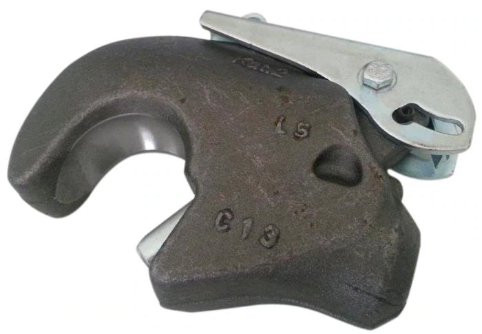

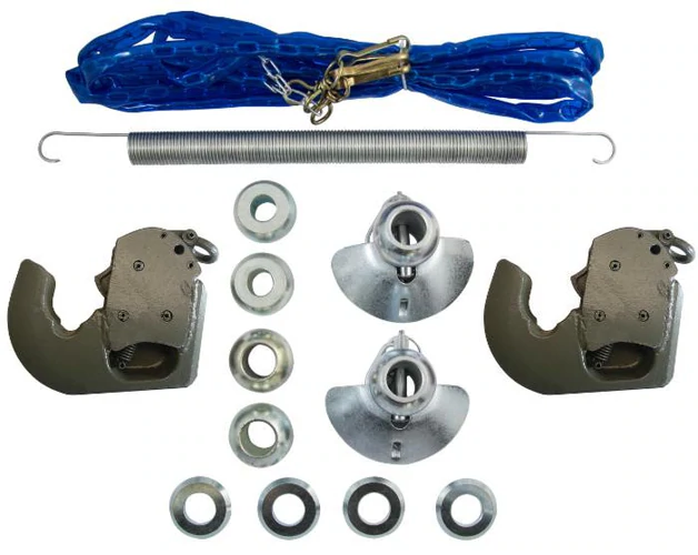

if you're going to the trouble of welding the link - look at a quick release!
I bought mine from FitRite after learning of Euro Style 3pt quick release fittings here (but i can't for the life of me fine the thread!)
here's a pic of top & bottom; I see some vendors online, but out of stock.
and the bottoms: (so you can see the balls, which slide on your normal pins)
I needed this system so I could still have "quick hitch" functionality while being compatible with attachments like the post auger which require removing the top link (but still use quick release for bottom), and not needing to remove the quick hitch to install the backhoe.
these have the same functionality of "pat's quick hitch" and none of the limitations: has a top-link option, and retains articulation (pat's changes geometry as you raise/lower the links)

This is one thread on Euro style.
