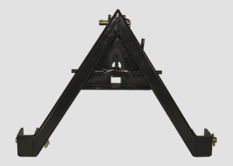

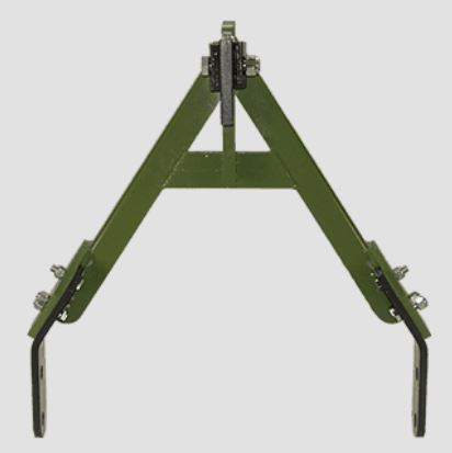

Jiffy Hitch has been around for 30 years, the one with the built in PTO is new.
This is the basic system: https://www.jiffyhitchsystems.com/how-it-works/

I started with the most basic 3 point arms, moved up to an adjustable 3 point arm system and then to a quick hitch. The quick hitch is worth the cash for sure. My only gripe is with bushings or adaptors to make it fit right. This is me saying this in my 40's.
I bet something that hooks up both when I'm deep into my 60-70s would be worth every penny, but not now.

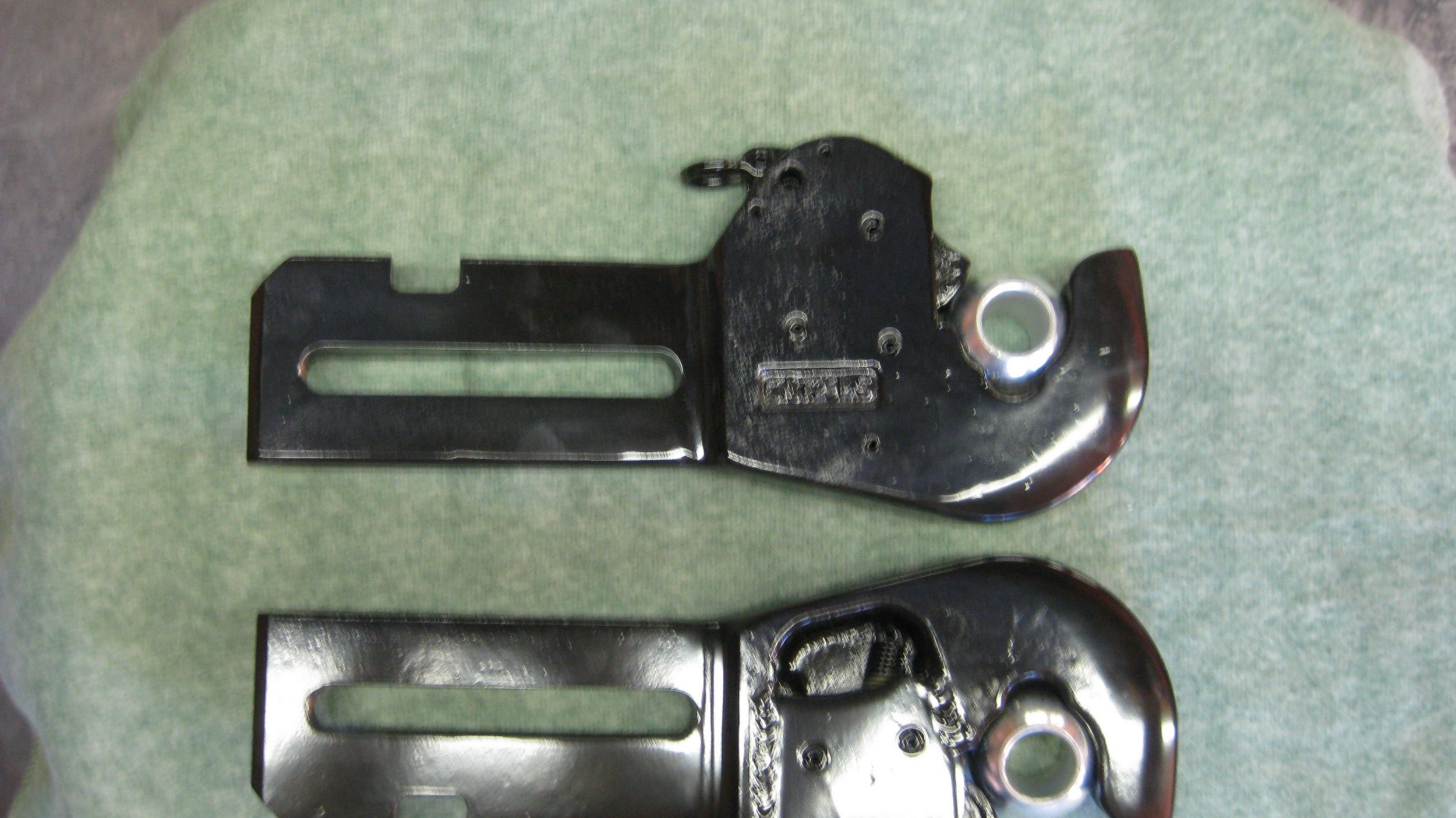

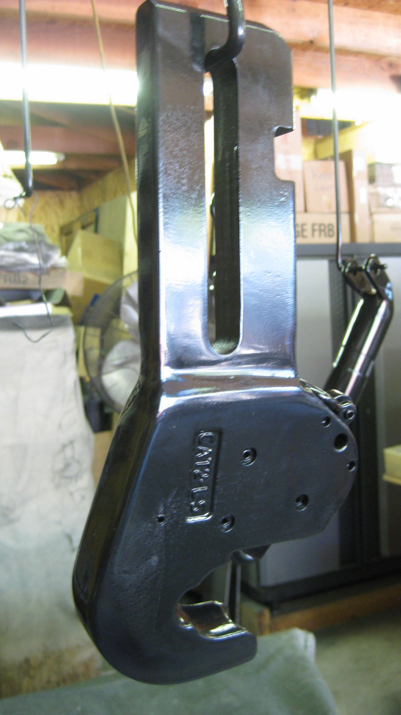

Anybody use the Euro QH that uses the ball on implement lift pins?
I bought PAT weld on and they work but not as well as I expected.
/ Jiffy Hitch System #8
Yes, it came standard on my tractor. In my opinion, the only QH that is worth getting. No breaking bolts like Pats or frames getting in the way, it just works. The issue with PATs is that it removes with ball joint of the lift arms and then puts everything on a bind till something snaps, usually the bolts.

In Europa welded Euro hooks with balls are standard in most tractors.
These hooks do´t move the attachment backwards.
There is no change in lift capacity.
So you can use same PTO shaft as before.
There is no heavy frame as in QH. So you have more room to join the PTO shaft easy.
You can use Cat1 and Cat 2 attachments because there are two hole size balls. Smaller holes for cat1 lift pins and bigger holes for cat2 pins.
The width of lower links is freely movable. So it is easy to move from Cat1 to Cat2 attachment. Or to older not standard attachment.

And lower arm with Welded Euro hook and its opening linkage.

Euro hooks
QH
To day I like most of my EURO HOOKS
Lowering of lift arms was more rapid with QH (big WEIGHT) than Euro hooks in winter.
