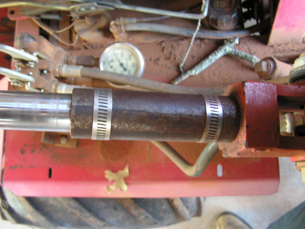

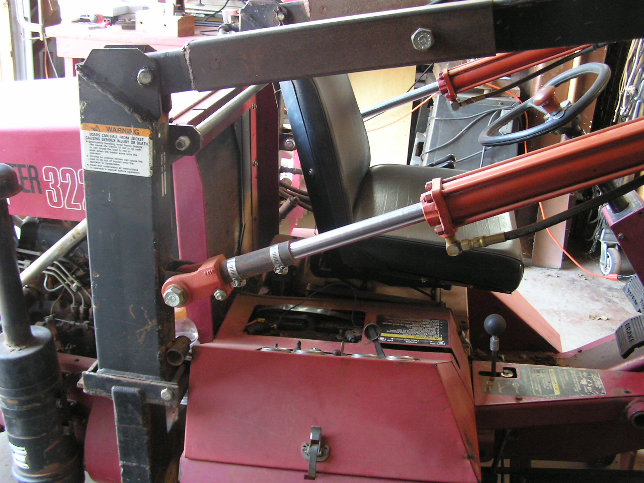

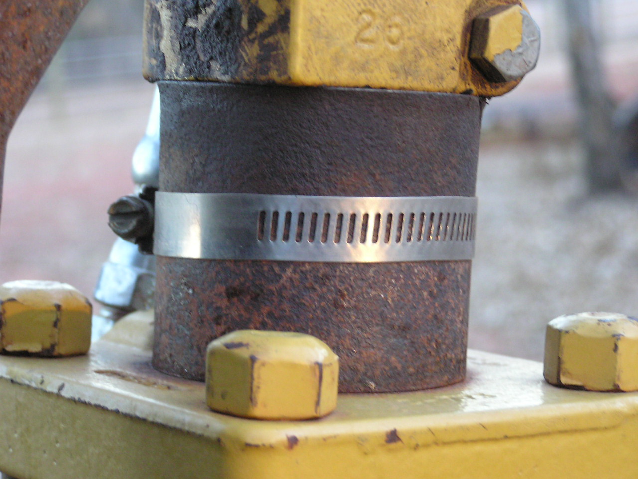

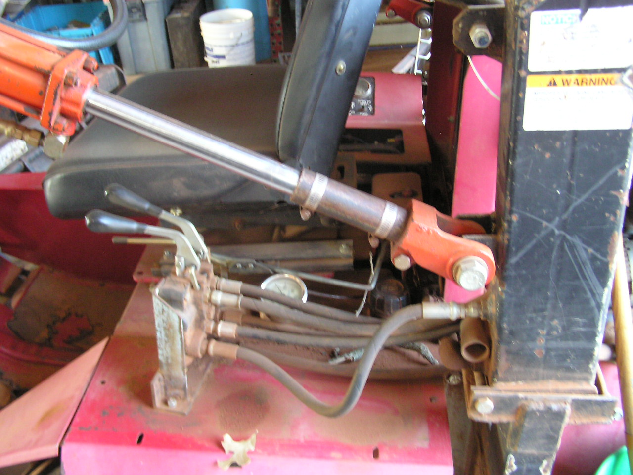

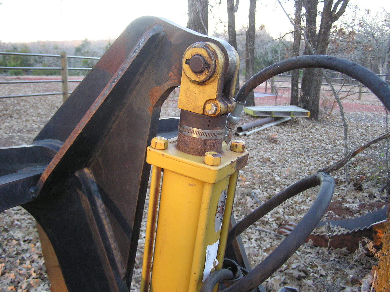

Good point on roading as I do a lot of that, and at speed too. Although my hydraulics do not sag, I'm always afraid of a sudden failure, so when transporting anything, I raise the implement as high as I can, run a chain from it to part of the upper link framework and make sure the load is mechanically suspended, not just hydraulically suspended.
Nothing like having a two thousand pound tiller hid the road surface when in traffic.
