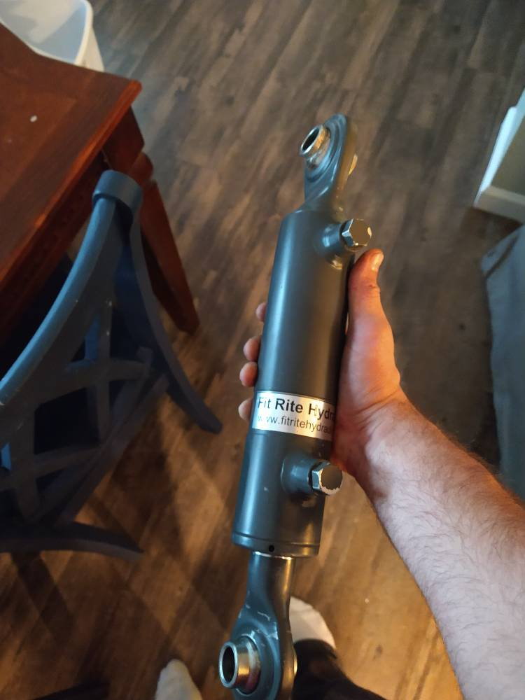

I've been digging into this a little more.
Most of the HTLs I see listed or mentioned that will work only have a 4-6" stroke. My oem manual top link has about 10" of adjustment.
Without having done a lot of ground engaging 3ph work before, is that little bit of stroke going to suffice? I'll keep the original top link too for oddball situations I might encounter, but on a regular basis is that going to be fine with, say, a box blade, a set of 3ph forks, a rake, or a rear blade?
Also, I have found a top link with almost perfect closed/extended lengths, but it is a 1.5" bore as opposed to a 2" bore. On my BX would a 1.5" bore cylinder be fine?

Check where in the adjustment range of your top link an attachment would be level. I found my factory top link on Bobcat CT2025 allowed way more back tilt than forward tilt and was longer than needed. The hydraulic cylinder I purchased is a little over 8" stroke, everything is level a midstroke and it has made using a box blade a totally different experience. I used that entire range when grading my driveway, I wouldn't want it any shorter. 4" would be too short in my opinion, 6" might be fine if the center point is perfect.

I stumbled across a FB marketplace listing for a Fitrite top link made for the BX tractors for 325 shipped, with hoses. Assuming the deal goes through as planned and it arrives in the shape it appears to be, I'm quite stoked about that!
It is not sized to accommodate Pat's, but I have been on the fence about whether to spend the money on Pat's anyway. Implements for a BX are relatively light, and so far I don't mind hooking them up the "hard" way.

I definitely got lucky! In the FB thread where the guy advertised it for sale several people were badgering him about how his price was too high, you can find a $100 cylinder that works blah blah blah, but all the while I'm messaging him saying I'll take it IMMEDIATELY! Haha
I was going to order one from Fitrite sized to work with Pat's, or source one that I thought would work from Surplus Hydraulics. However, when I saw this available and available NOW I decided I'll be fine without Pat's! If I ever desire I'll just go with a quick hitch now I guess.
However, I'm finding I don't mind using the 3ph directly so far. Implements for this tractor are light, making hookup no big deal (so far). Edit- OOPS, already said all that. Sorry!
