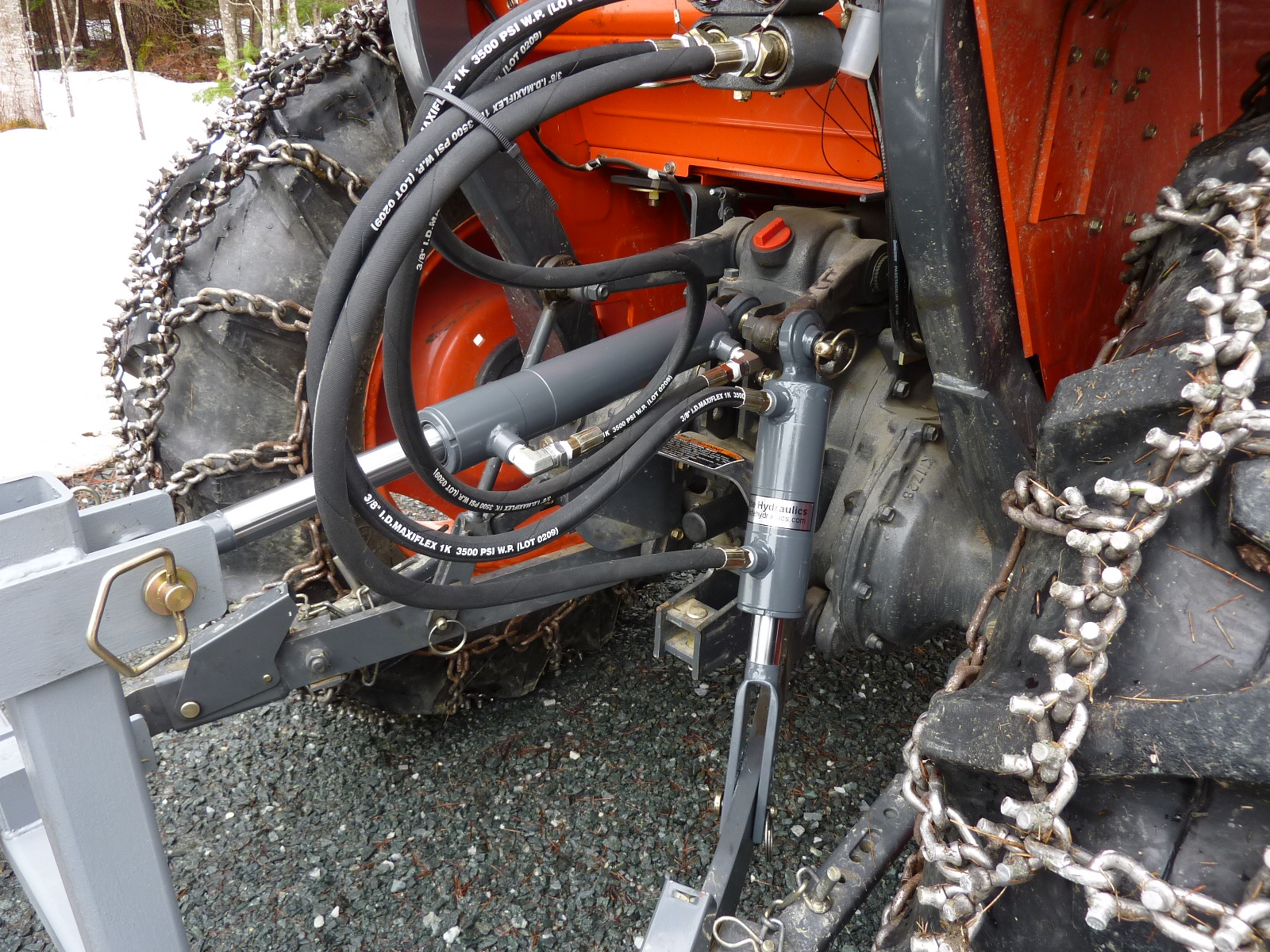

I can attest to the interference issue. when I first installed my HTL. I was so excited, didn't even think there could be trouble. I proceeded to lift the 3 pt all the way and actually watched it get crushed :ashamed:
I ordered new tubes and nuts but was able to straighten the bent ones and have had no trouble since.
I fooled around with the lines going different ways and settled for this setup (in 2nd picture), no problems in over 2 years now. even with rear snow blade riding up high on snow banks etc.
I like Beenthere's though and may look into some 90's

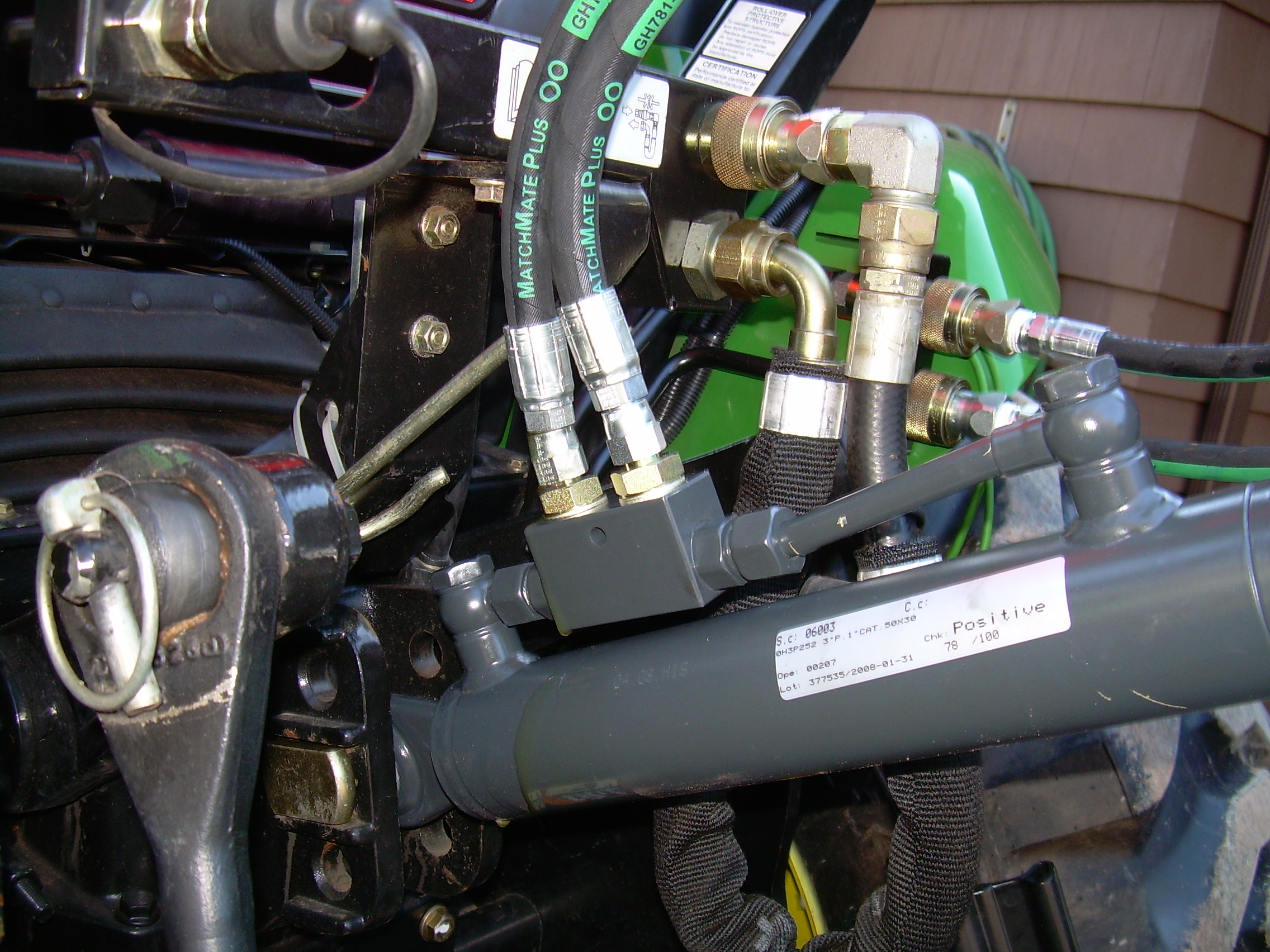

Before and after pics.
JB.

What about a hydraulic banjo or swivel attachments? I looked at Princess Auto and could not find them but this seemed a solution to the hoses coming straight out from the tube.
   / Hydraulic top link use and limitations #19
I couldn't operate my boxblade without it....or the landscape rake.....or the road grader....I guess I could get along without it on the mower...but why?
   / Hydraulic top link use and limitations #20
JB4310,
It appears that we have the same cylinder and I see that you flipped the whole DPOCV. I also thought about doing that but not quite brave enough. Was it a painless modification?
