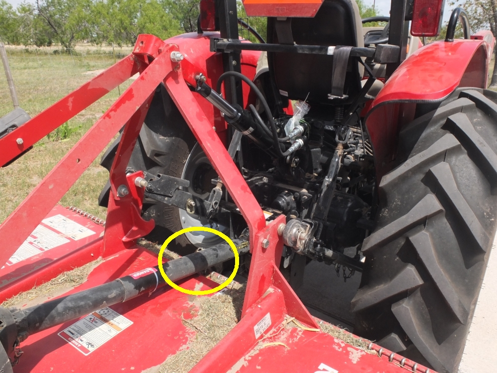

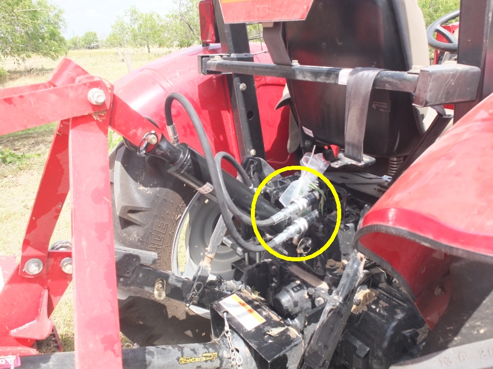

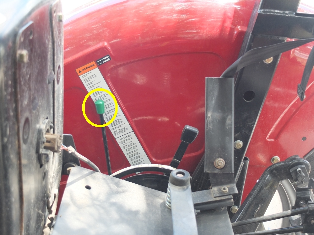

The Case IH 45A comes with an auxilliary hydraulic valve; the control lever outboard of the 3-point hitch control lever, and the hydraulic line ports behind the seat.
Hydraulic top-link immediately came to mind. Research on this site showed fitritehydraulics.com had good recommendations. As Brian notes, however, his top-links are custom made - so expect to wait several weeks.
The part arrived a few days ago, and mounted easily.

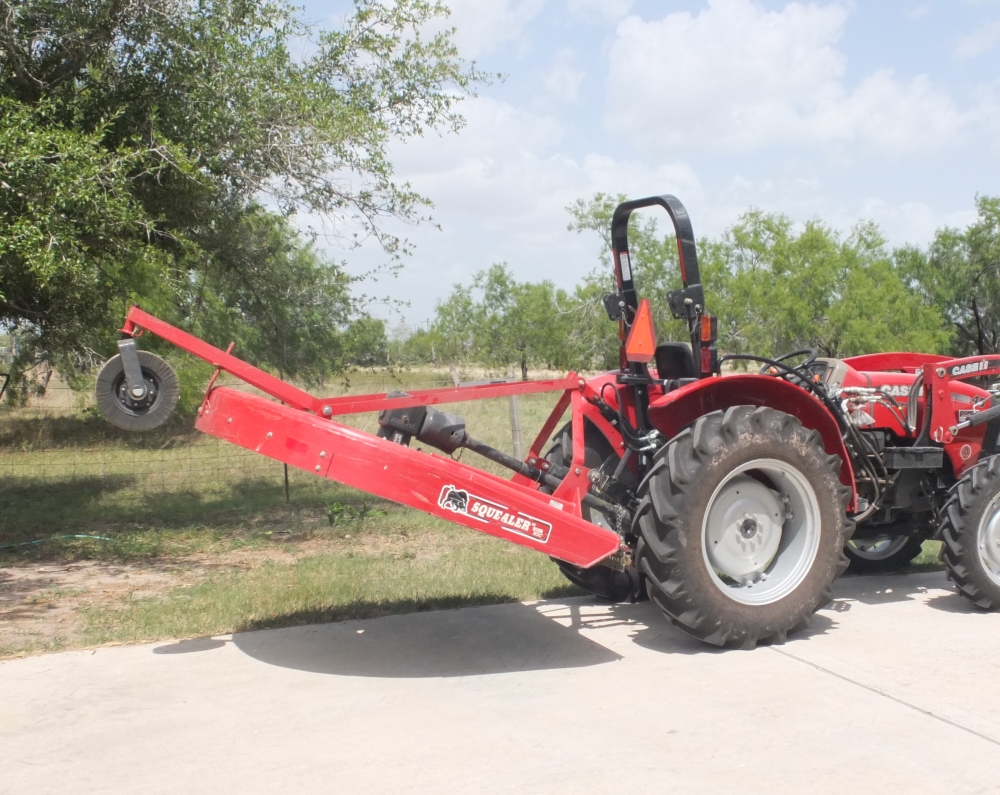

As I expected, range of motion is wider than with the factory manual adjust top-link. Access to the underside of the mower for washing and blade grinding will be easier.
Of course with the wider range of motion there may be mechanical conflicts - as with the hitch full up and the top-link extending full out. Best to check the full range carefully with each attachment.

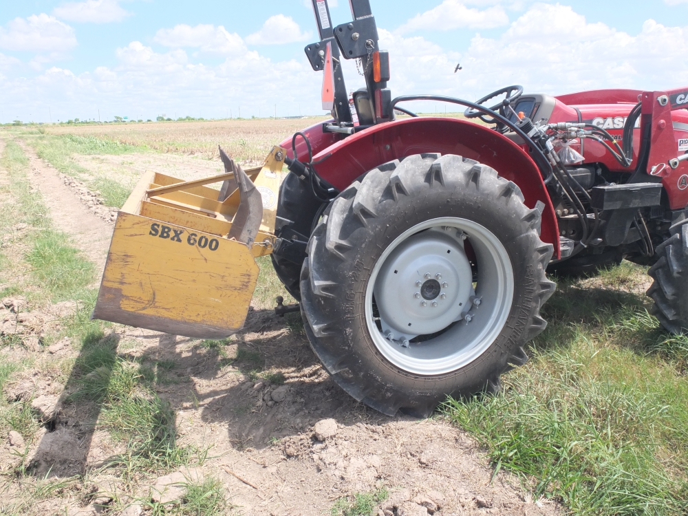

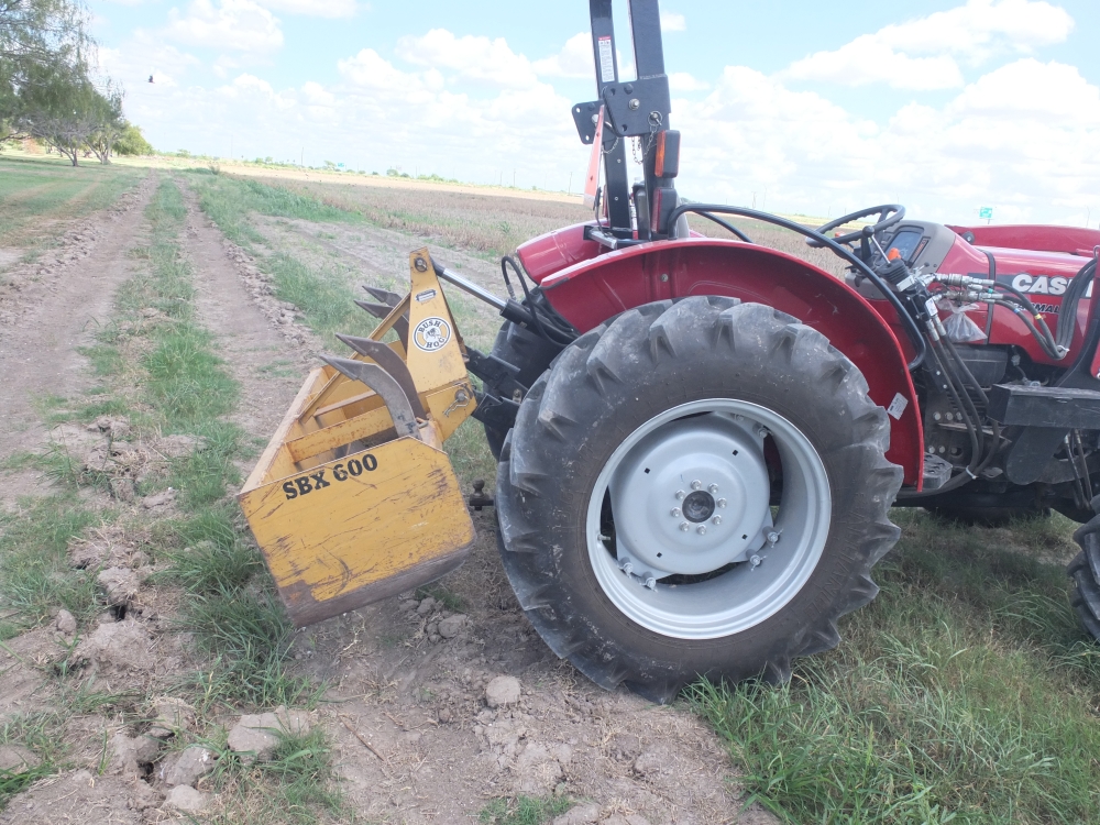

I've tried the hydraulic top-link with some dirt work also. The extended range allows for a much more aggressive bite angle.
Also, compared to using just the 3-point hitch lever, there is finer control of the opening when feeding out material from the carry - once I've got past the learning curve on that(!).
