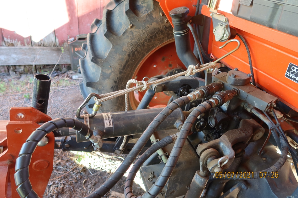

How does one go about adjusting the hydraulic top link length to allow insertion of the pin?
There is no way I can support the top link, hold the pin ready to insert through impliment and rod end run the hydro control for extension and retraction. At least with a screw type top link, I have hands enough ;-)

My tractor has a 3pt height lever at the rear, so I just carefully raise or lower the bottom 2 arms until the toplink pin lines up. I suppose if your tractor shuts off when you get out of the seat, then its going to be a PITA... I guess you could raise the 3pt too high, and then get off the tractor, see how close you are and then you can lower the 3pt slowly without the tractor running. For your tractor, the implements shouldn't be too heavy, a spud wrench can probably move any implement and line it up as well.

Curiously The Hurlimann does not allow lowering the lift arms when the engine/ hydro pump is not turning. Not sure why. And the position/ draft control levers are around the fender anyway.
The action of the lift on the B7200 is so violent and abrupt even with the engine at low idle, that lifting the arms to obtain top link position is a fools mission, Dangerous as well!.

We added a hydraulic top link years ago, it has saved lots of cussing and bruised fingers. If you can get one with the pilot valve so the cylinder doesn’t leak down

My Fit Rite Hydraulic top link is eleven years old. Still as good as the day it arrived.
I experience the same situation as CalG. Holding the top link UP - while extending to engage the implement.
I have a solution. A short rope to hold the top link up until it's extended far enough to engage the implement.
WoW!! I even have a pic. Showing how this works.
Initially I was going to lean over the seat - grab the rope and hold the top link up - while extending it. This didn't work so very well. So with the mods you can see - I tie the top link up and then extend it. It all works very well.
