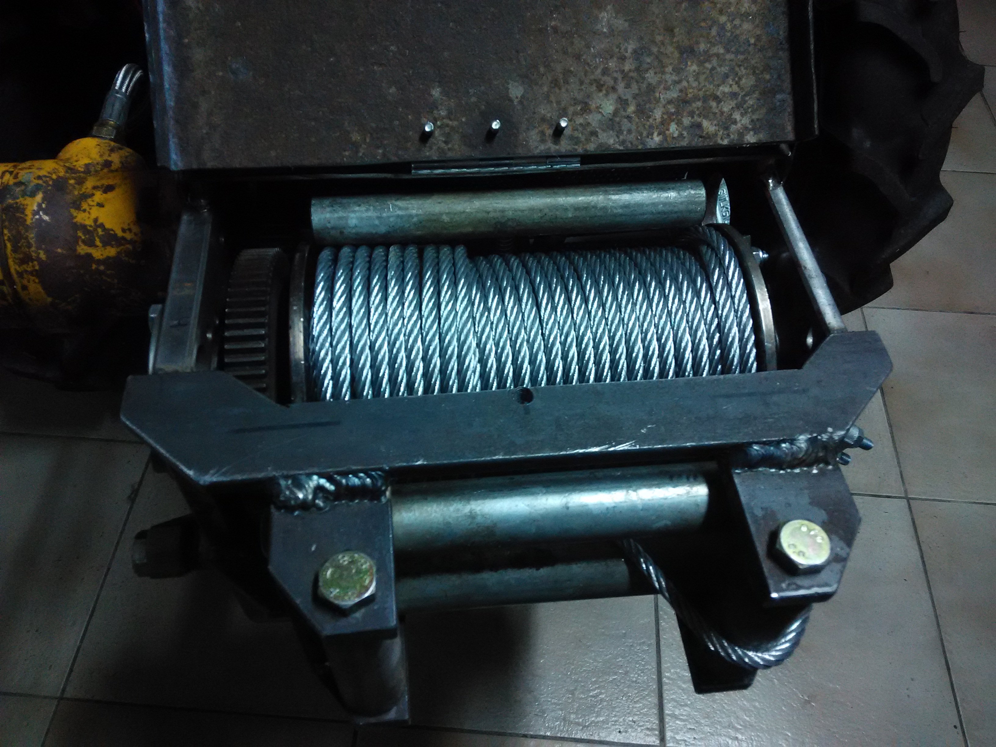

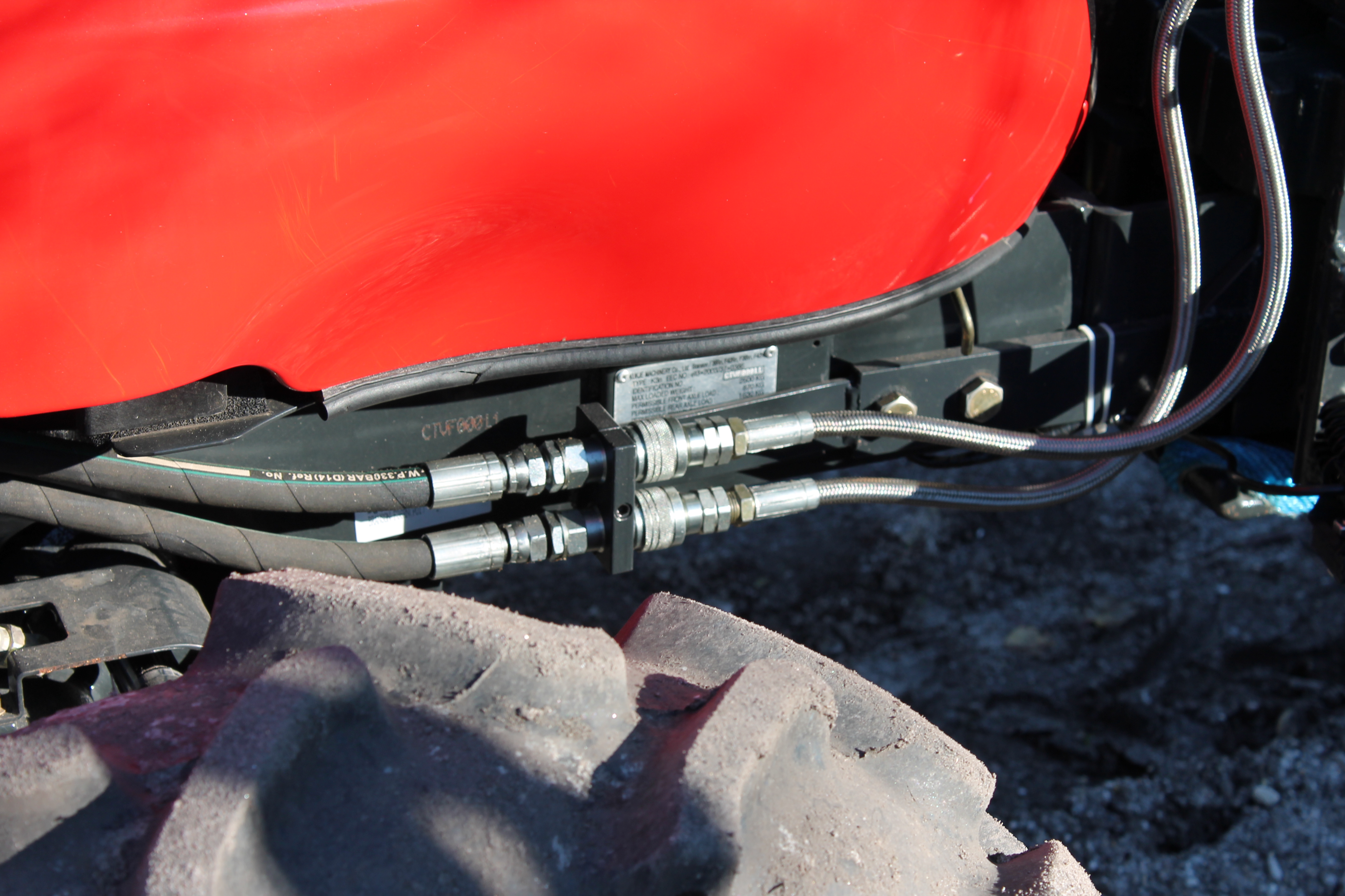

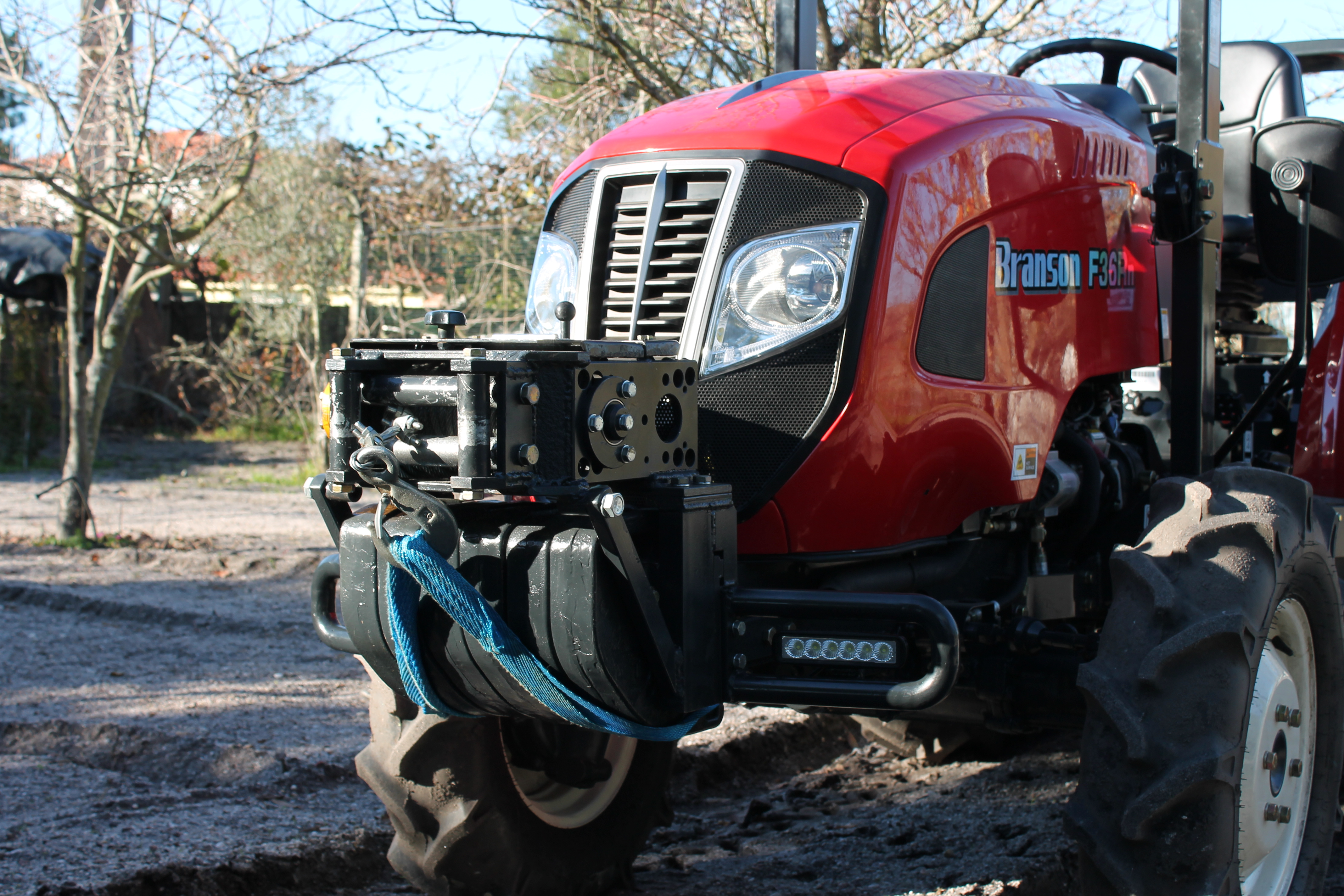

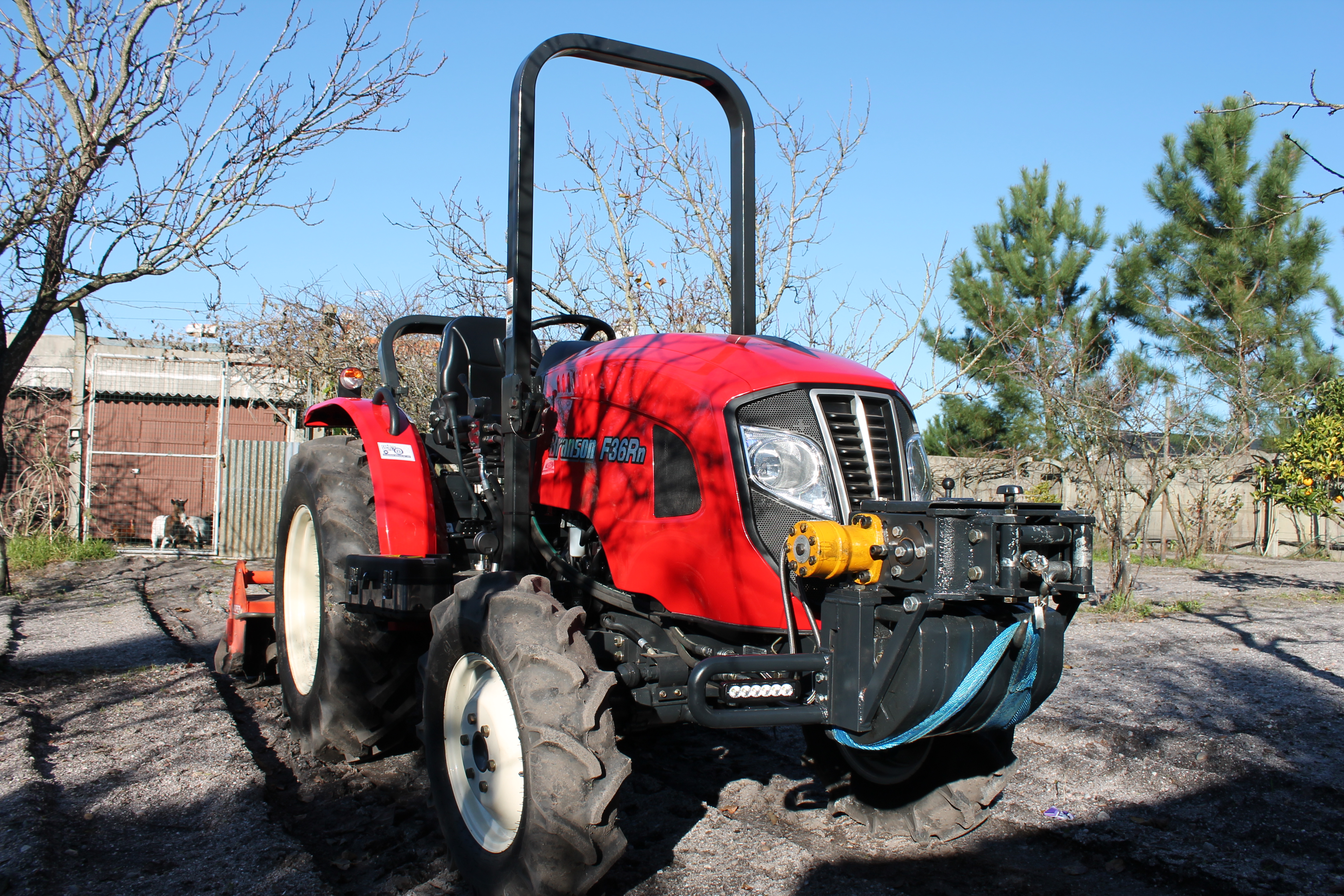

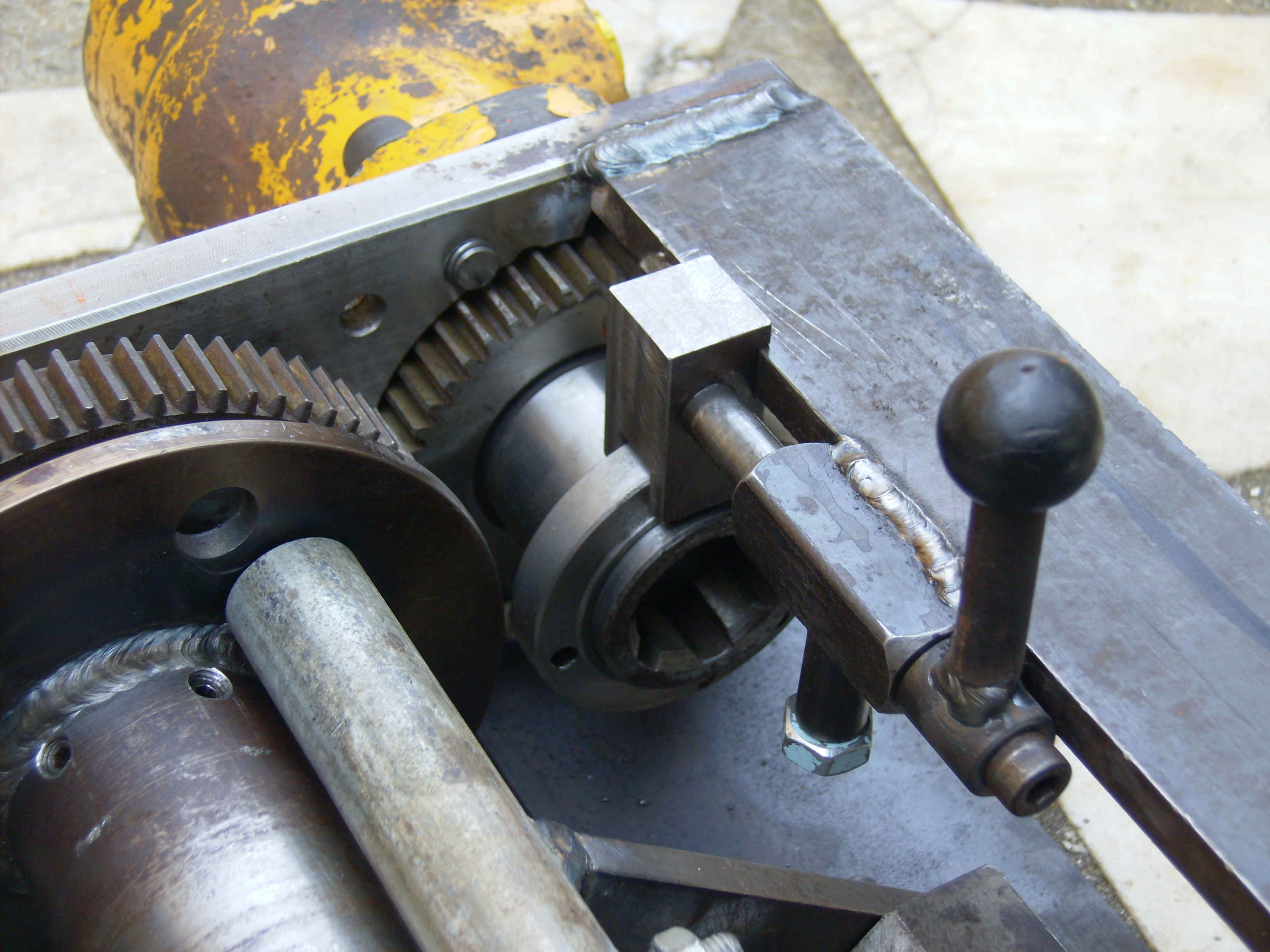

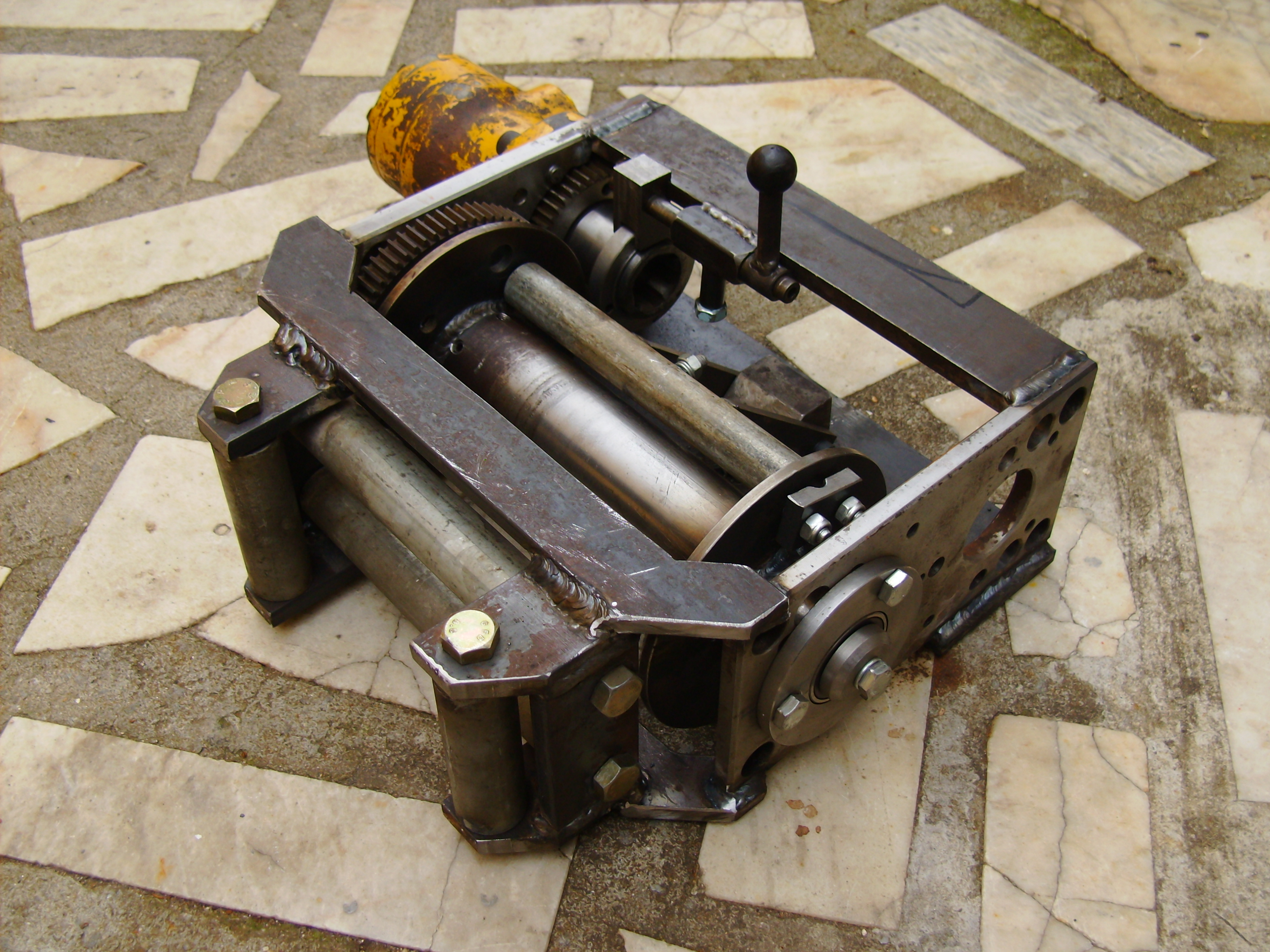

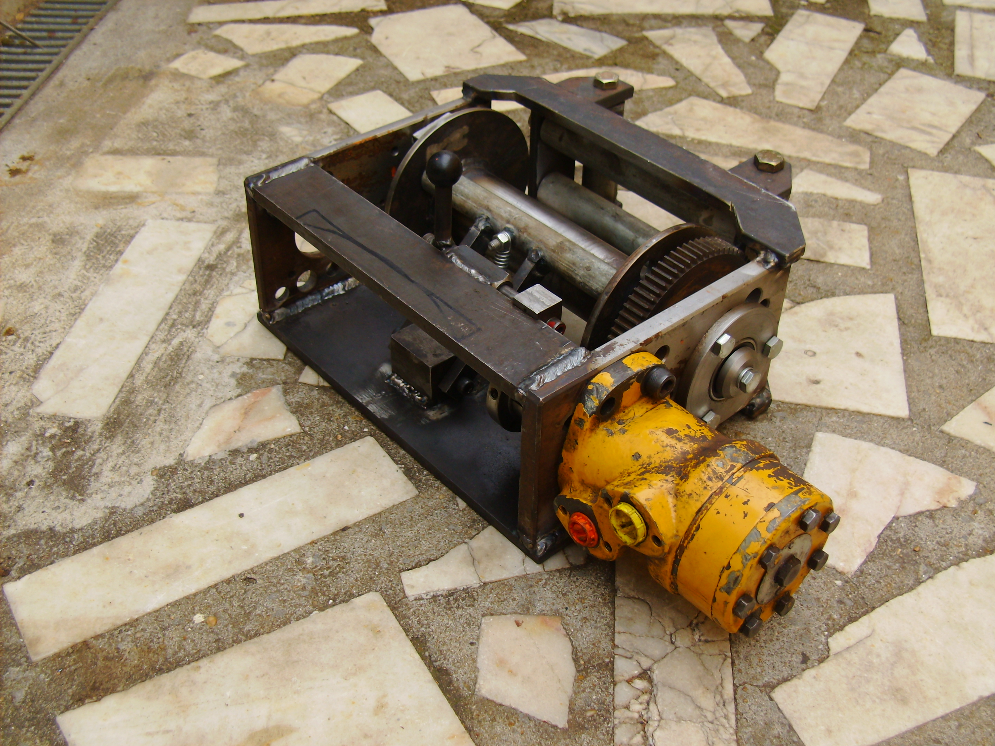

Most of my work is done on some steep hills with some hidden holes and such, I find my self on situations that requires a lot of diff lock work and I've been getting away with it but I want to have another place in case the diff lock doesn't make it.
So I decided to build a hydraulic winch for my Branson F36Rn tractor since I had most of the stuff anyway. Just need to buy the cable and the hook.
Ended up being a 6000 lbs winch with a weight of 130 lbs that will work nice with the 224 lbs weights that came with the tractor. It was still a bit light with the brush hog on. I won't use this as a logging winch. This is purely for get tractor out of a stuck situation. It has about 160 feet of steel rope and free spool option with a brake so it doesn't unwind like crazy. The drum is supported by 2 bearing on each side.
I also made a bumper so it pushes the brush away from the hood of the tractor preventing from scratching the paint which also made the perfect spot for a couple of small LED light bars.
Everything works awesome, I'm really happy with it.
HPIM5260.JPGHPIM5262.JPGHPIM5264.JPGIMG_20171109_181521.jpgIMG_5695.JPGIMG_5697.JPGIMG_5700.JPGIMG_5701.JPGIMG_5724.JPGIMG_5725.JPG

Thank you all :thumbsup:
I wanted something compact that would fit nice on the front of the tractor.
I only build this front winch because the tractor comes with a middle ROPS installed, therefore there is a 4" by 1/2" flat bar all the way from the front weights to the gearbox. This tractor is really well built with really heavy duty castings. I think it spreads all the forces trough the whole tractor instead of just the engine block which is not desirable.
I had take a look on buying the winch instead of making it, but it is a lot of money. Even for the electric ones and since I had most of the stuff, I just decide make it. That Power Trac unit looks really neat also.

The additional reinforcement you NOW describe was omitted from original post. I am NOT an engineer. My comment was a FYI to others seeking to duplicate your build.

Yeah mounting on the FEL cross tube might work however be very careful and never ever pull it's side ways. It might bend the FEL arms. Have you considered a electric or small hydraulic winch? I mean, mine is way overbuilt since it's homemade and it has way more power than I need.
