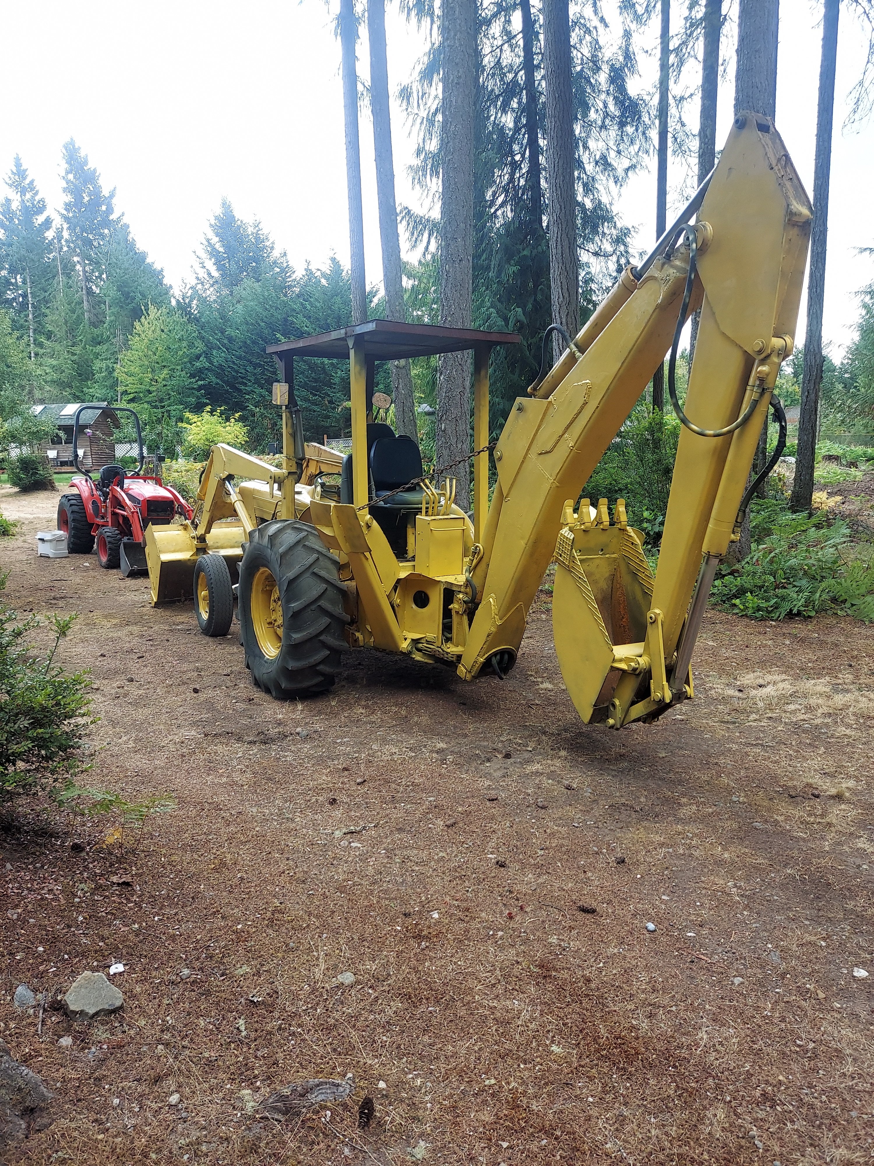

I need to change all my hydraulic fluid on my 4500 industrial.It shows drain on port side frame Mine does not have one .How do I drain frame resevoir?TIA.

I had quite a few views to this question but no replies. I just wanted to say I continued to search for the drain and I found it. It was a recessed plug full of mud female Allen head on the side of the rail instead of the bottom where it shows in the service manual Problem solved. Hope it helps someone else.

Did you change the filter while you were at it?

Yes, $70 filter had to cross reference it from new Holland to Napa had a filter sent to me from Steiner. It was 2“ x 3“. My hydraulic filter is 6“ x 6“ but that’s close I guess.

Yes, I’m still working on it waiting for some cheap hydraulic oil to rinse everything out my hydraulic oil I don’t think had ever been changed. It looked like milk and my transmission fluid looked like mud new transmission gasket going in gonna finally put in the neutral switch and hope it’s a little more powerful Now? don’t know how to drain a differential. It has a site plug and a filler cap but nothing on the bottom I may siphon out what I can and then fill it as best. I can any other advice you may have I will always appreciate I’m new to all this 70 years old and got my first Tractor about five years ago so much to learn so little time.
