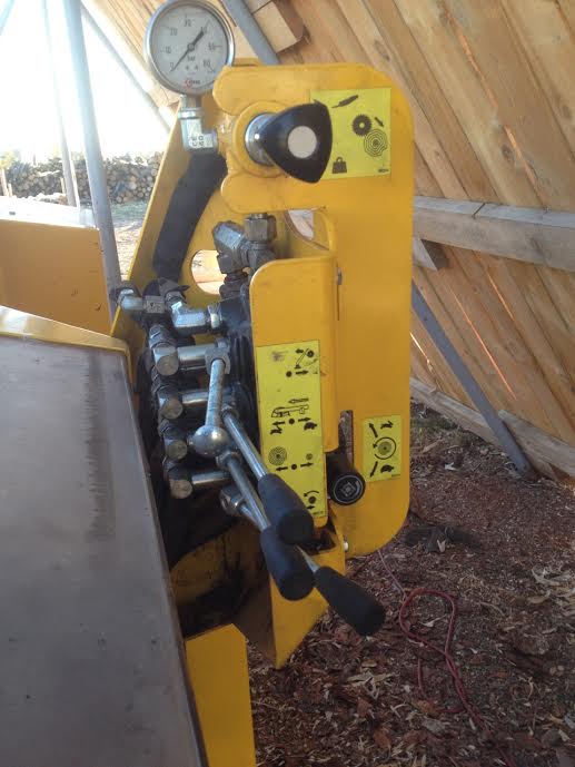

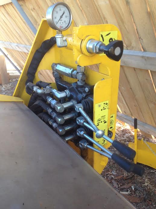

I have an attachment that is building an incredible amount to heat in the hydraulics when I operate. I don't' exactly understand what causes heat in hydraulic systems so I thought I would throw this out there and see if anyone can shed some light on this subject.
The machine only has 4 hydraulic circuits.
#1 controls the drive wheels. This valve is always open and has an adjustment to control the wheels speed.
#2 and #3 adjust the spacing of the drive wheels and the angle. These only operate when the handle is pulled
#4 operates the arm on the top drive wheel and has a pressure regulator to adjust the down pressure on the cylinder.

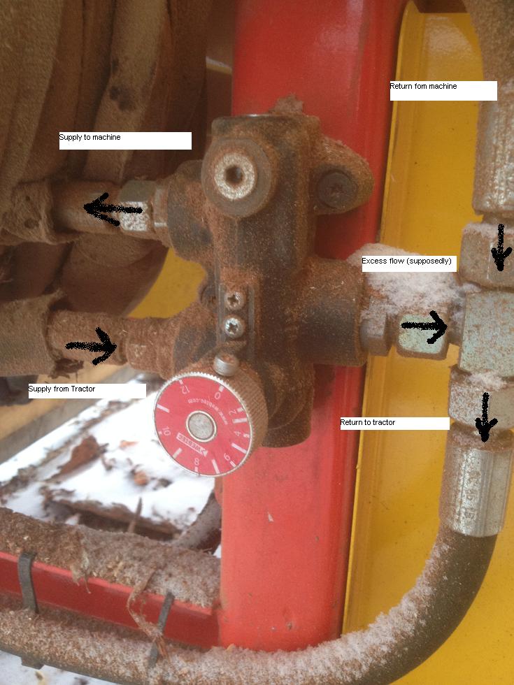

According to the manufacturer this requires 8 GPM of flow to operate. The unit has a pressure regulator and a flow divider installed but strangely I can still build over 2,000 PSI if I open the valve on the tractor even at idle. That makes me think the pressure regulator and flow divider is not working as taht should not be possible. Makes me think there is a restriction in the system causing all the back pressure.
I tried operating this with my old famrall with a PTO hydraulic pump. Input pressure was 900 PSI and the oil overheated to 190+ in less than 10 minutes with no load. IT only has about a 4 gallon tank so the heat had nowhere to go.
When I operate it with my JCB wint 900 PSI of input pressure the oil goes to 175+ in about 20 minutes. Keep in mind this has a large reservoir and oil cooler on the motor.
According to the manufacturer, Rabaud, they say this is normal for the Robopel 250. Everyone I have talked to said that building that much heat is not normal, especially when not under a heavy load.
I guess I'm trying to figure out how hydraulic oil builds heat and where I should look to try to pinpoint the problem. Here are some pics of the machine and valve.

#1: What type of flow control is being used for the wheel speed? Where is the excess flow directed or diverted to? Depending on the flow regulator style this could be causing a heat issue.
#4: Pressure reducing valves are heat generators IF their is flow across them. In this case I presume this is just keeping a load on a cylinder so there would be minimal flow but then the question becomes what is happening to the flow? If this is a fixed displacement pump it has to go somewhere and it will be dumping to tank at some pressure greater than your reduced pressure. This will create a lot of heat.
simple method for finding point of heat generation is to either touch the components during startup if this can be done safely or use an infrared thermometer and look for the hot spot.

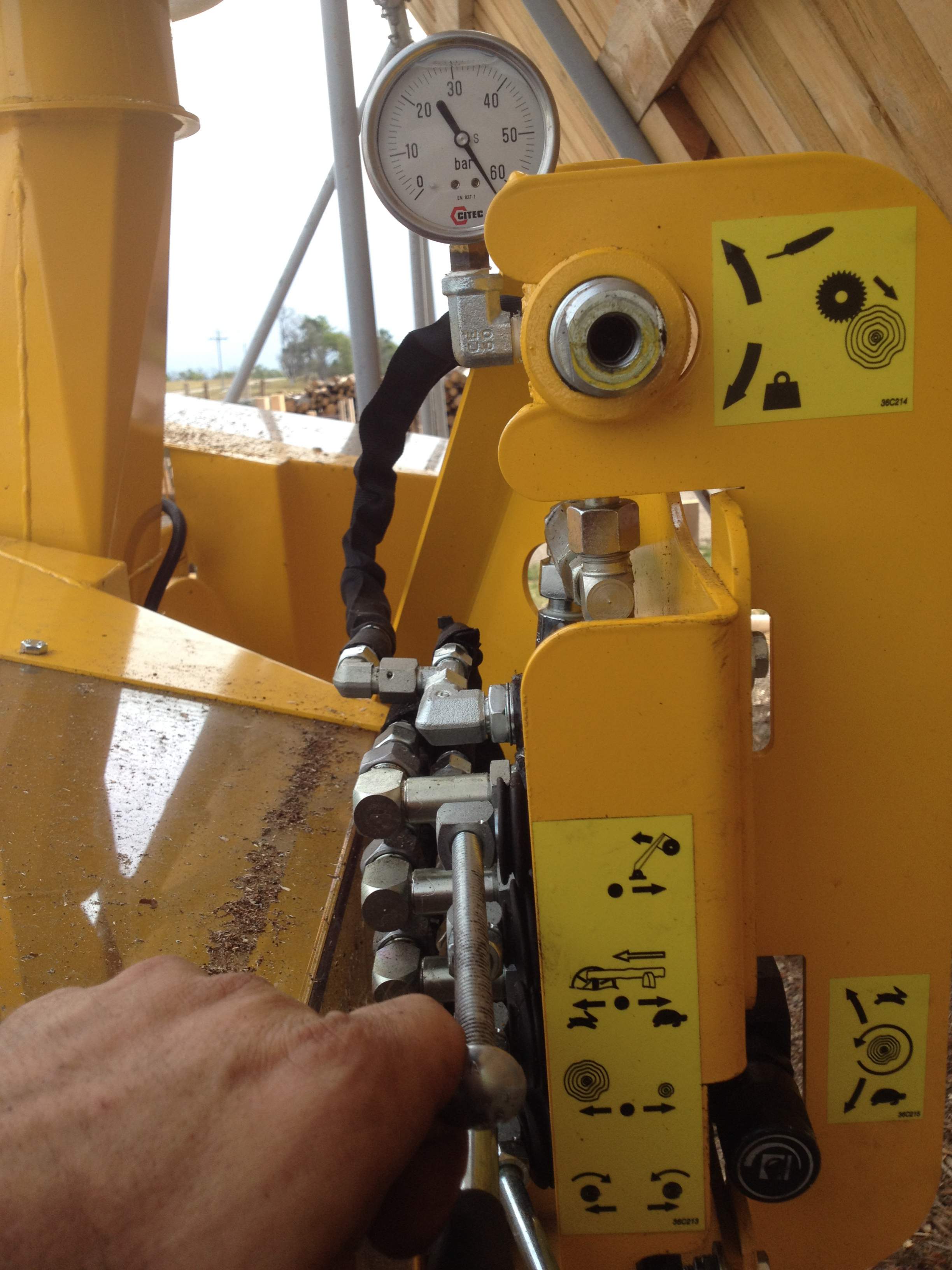

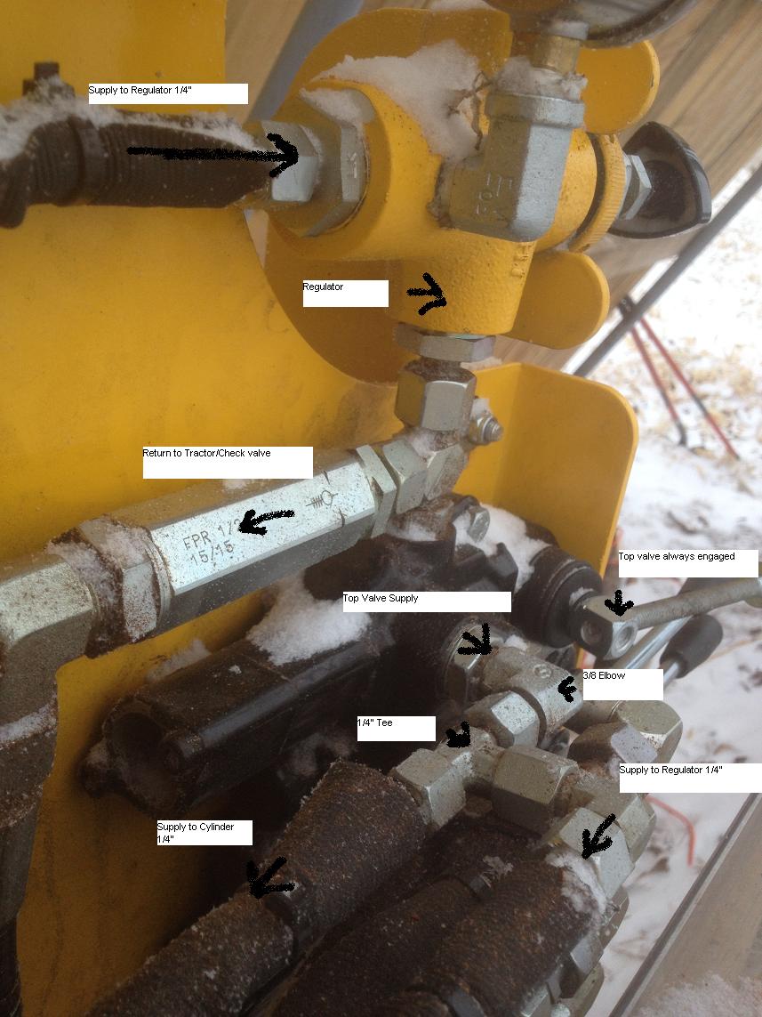

I got to looking at the valve. It appears to be supplied with a 3/8 hose and the first circuit (bottom) runs the drive wheels. There is a dial just to the right that adjust the wheel speed. IT appears that the lines to and from the drive wheels are 3/8. This valve is always engaged as the wheels are always spinning. You can hold it in the middle to stop them or hold it in the opposite direction to reverse wheel direction.
The next 2 circuits are just going to adjustment cylinders and have 1/4" lines. Both are in the center position unless engaged.
Then we come to the top circuit. It controls the arm. This has a pressure relief valve tapped into the supply line with a T. The T and lines are 1/4". This valve is always engaged.
According to my thermometer the heat is coming from the top pressure regulator. It appears to me that all the supply lines on the machine are 3/8", the first valve that receives flow for the wheels is 3/8", but when you come to the top valve the Tee is only 1/4" and the line to the cylinder and to the regulator is only 1/4". So is appears to me that the system is all 3/8" except for that tee and line to the regulator which are only 1/4". The regulator has a much bigger opening that has been bushed down from 1/2" to 1/4".
Could that be the restriction causing issues in the system? I'm no plumber but it sure seems like that is a restriction. Once that oil leaves the regulator there is no backpressure so there is a huge pressure drop. It has to go through the regulator because the valve is always engaged.

A 'nominal' 1/4" fitting (male) has <45% the cross-sectional area (thus, presumably, flow capacity) of similar 3/8" pieces. In an open center system continuous flow to/thru' any/all circuits must contend with any restriction in each. (8 gpm :eek:)
If the gauge is upstream of the pressure regulator it would show the pump output trying to maintain downstream pressure (to the reg) beyond the 1/4" bits, esp when nothing (cyl, motor) is activated and circuit back-pressure at its lowest.
Anyway, IMO the 1/4" parts should go before you can find any other possible problems. tog
