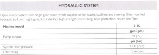

Thanks for the replies. I've been doing some research and a fella on heavy equipment forum was kind enough to give me the hydraulic system information.

I agree. all goes through 1 hose in and 1 hose out. Tractor and machine are open circuit. Tractor is rated for 19 gpm and the machine requires 8 gpm.
