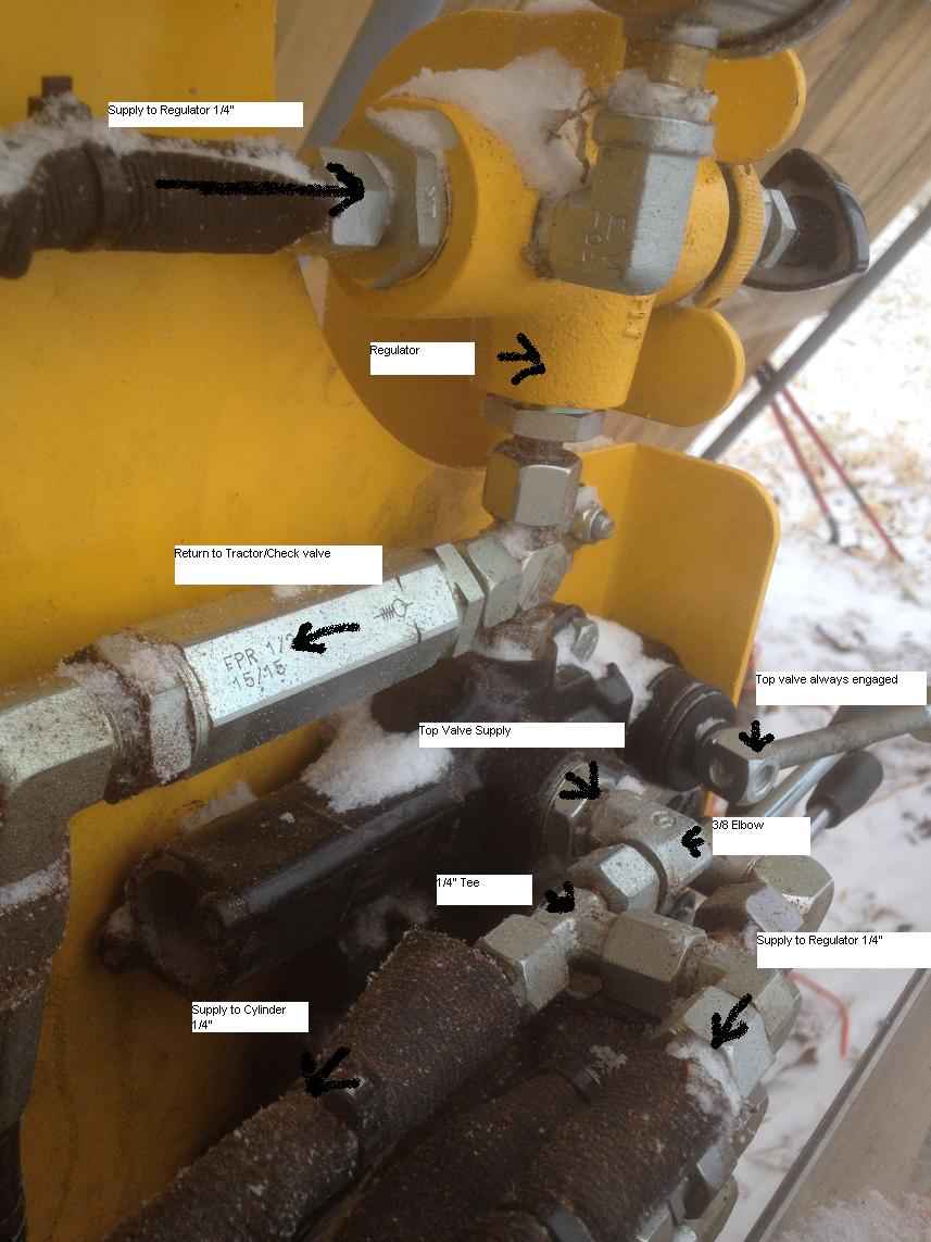

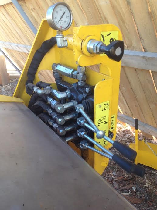

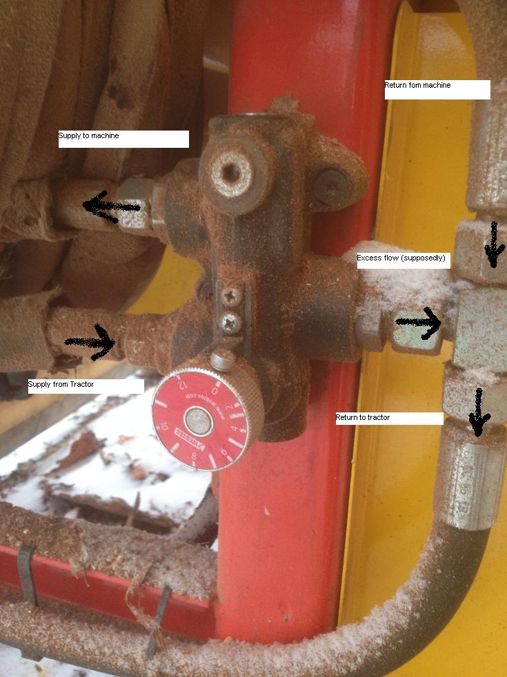

Here are some pics of the machines hydraulics.
This shows the top valve and how it connects to the cylinder and tees to the pressure regulator. This valve is always engaged.
This shows the flow divider that was installed

I did some crude drawings over pics to show the flow as well as the flow divider.
I do not believe the relief works properly as I can build over 2,000 psi at idle if I open the valve on the JCB tractor all the way. The farmall only builds about 900 PSI when it's valve is opened all the way.
I'll do some looking at the valve block and see about brand. It was replaced when the service man came out.

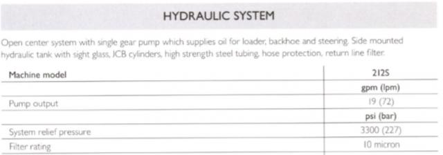

There was no mention of the unit needing a hydraulic input in the marketing so I didn't even know until it arrived. I was planning on using my hydraulic chainsaw on the tractors hydraulics (The chainsaw you helped me set up a while back, thanks again for your help with that. It works great). I have the saw setup for open center and it works great on the JCB as well as on the Bobcat tractor I used to have.
