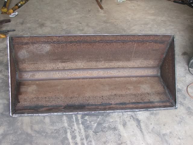

I just stumbled in here by accident but an easy way to build a bucket is in a shape of a V. This is how I formed my bucket. I hope it helps. Otherwise, sorry for intruding.
