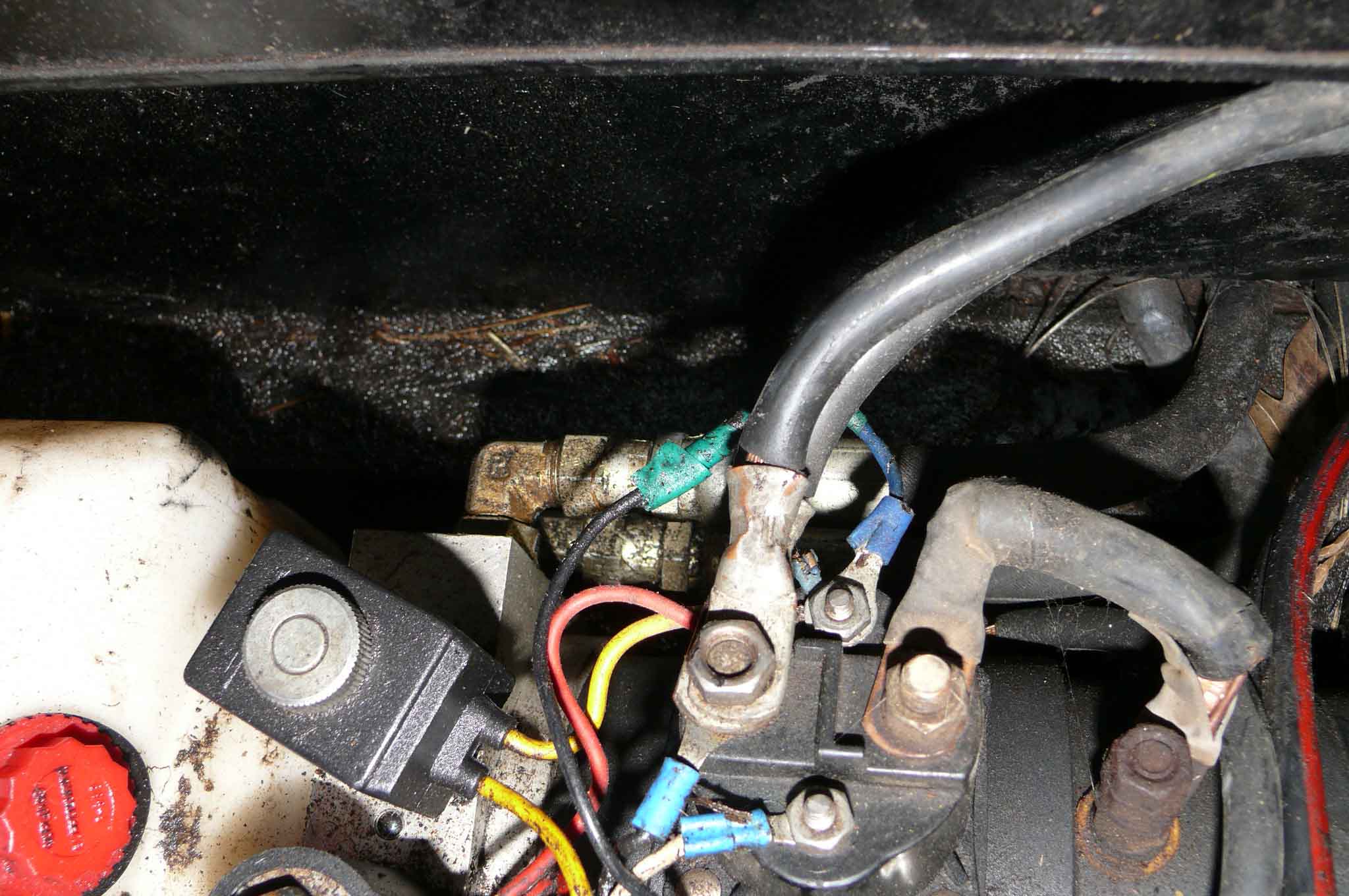

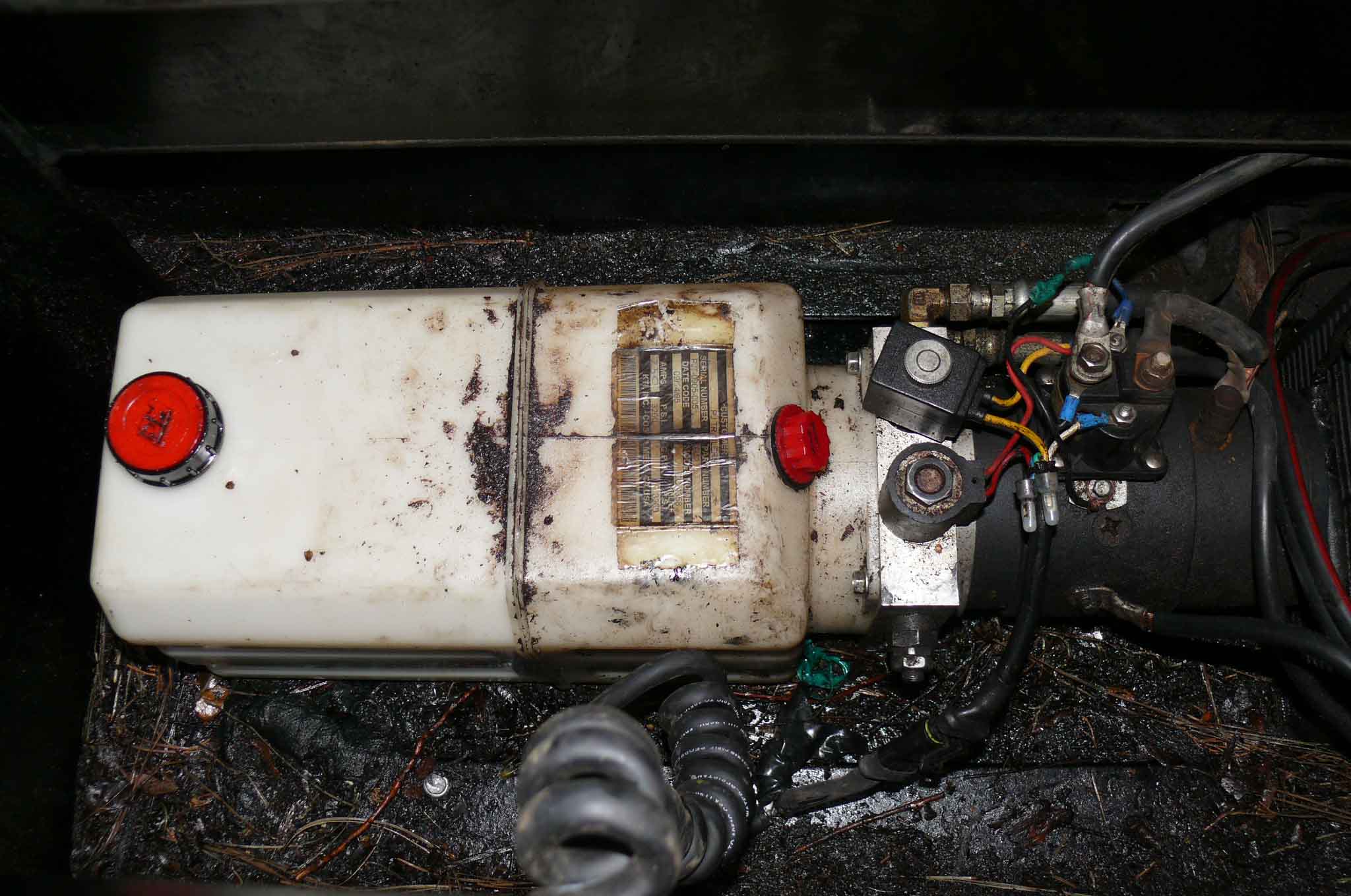

OK... photos are taken, looking into the hydraulic bin in the front of the trailer, in order of increasing detail.
pump and connected motor and tank
pump connections
two hydraulic connections that go back to the big lift cylinder... they are the brassy looking fittings connecting into the steel pump housing

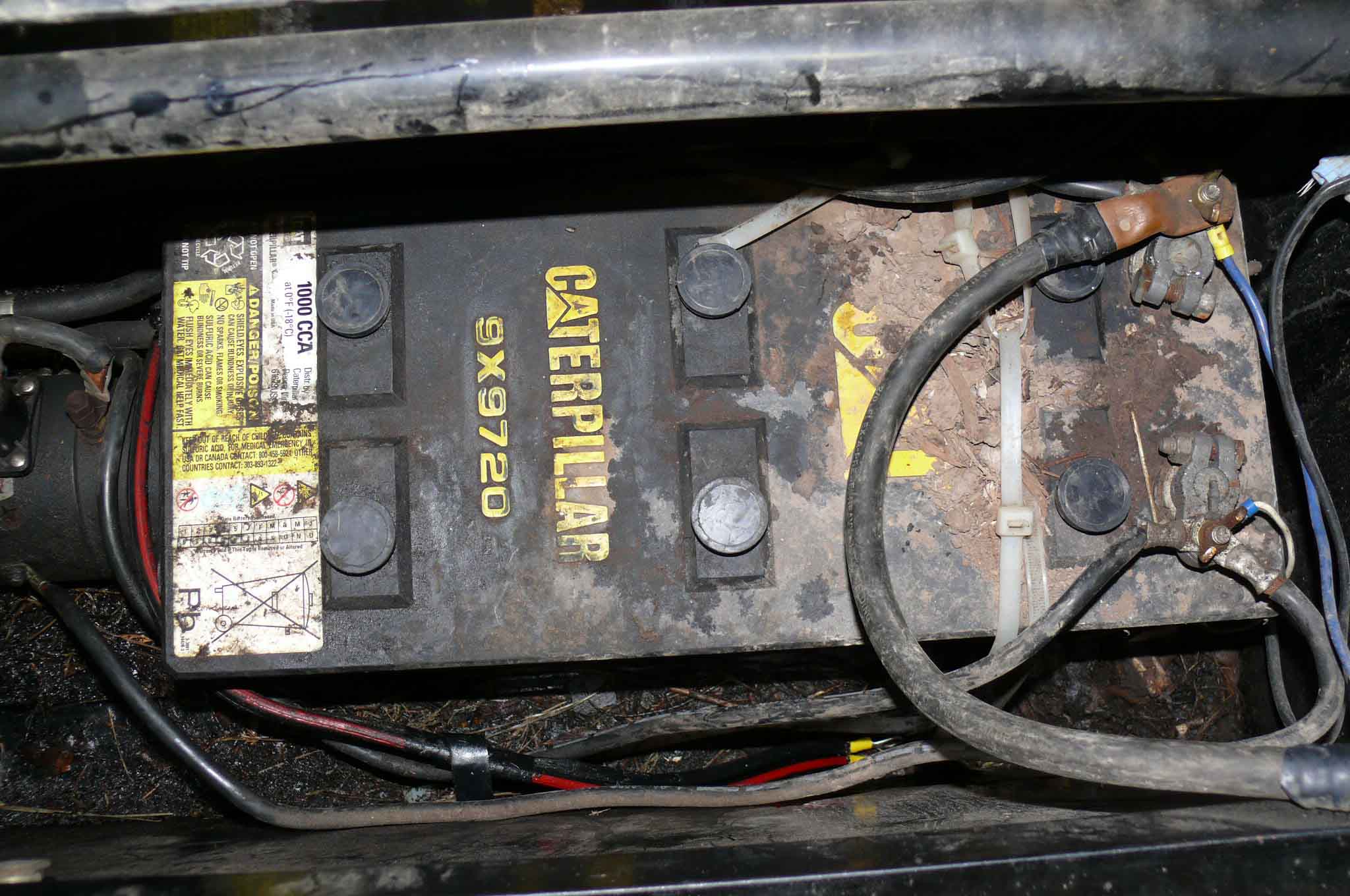

I have not yet tried a replacement battery, however, I put a voltmeter on the battery, which has had a trickle charger on it all day... 12.5 volts, no load. Then, I started raising (all too slowly) the dump and voltage dropped to 11.4 volts after a minute... front of dump had raised 4 inches. Does this voltage drop versus work done seem reasonable? Anybody with a dump trailer have any time versus distance traveled versus voltage information?
The above was without having the battery connected to a charging pickup alternator, or other charger, just running off of battery only.
The battery is a biggie, CAT 1000 CCA, 9X9720, 275 reserve capacity minutes at 25 amp output at 80 degrees F (about today's temp)

That is one big ***** battery...
Mine is a Wally World special average size car battery, mine takes about two minutes to go to full dump position....and I thought that was slow..This battery has been working for three years.
You need to check the electrolyte level in each of the cells to see the specific gravity level, this will tell you what shape the cell is in.

The battery weighs 101 lbs wet according to the Cat specs. Fluid level in all cells was above the plates when I got the trailer and I've brought the level up to just under the filler cap with distilled water.

Yesterday John and I spent several hours working on his trailer. We pulled the pump assembly out of the trailer, dumped the fluid, removed the tank, cleaned all the crap out of the tank, replaced the filter, put it all back together, filled it with fluid and hit the "up" button. About 1/3 of the way up, it was getting low in fluid, so we stopped and topped off the tank. When we started up, there was much bubbling of air in the tank. We had to stop again and top off the tank before we got all the way up. Much air came out while going up. As we lowered the bed, we lost a small amount of fluid because we had no idea of how much to put in, with all the air that was coming out. We then cycled the unit again, without having to add any more fluid. When it was all the way up, we stopped while we sat down and drank some cold liquid. It didn't creep down so the seals all seem to be good and the check valves work. The comments about the tank only needing to hold enough fluid to account for the size of the piston rod also seem to be true.
This is an end view of the filter:
One side view:
Other side:
Anybody have any ideas why this filter didn't pass fluid. :D
The filter appears to be of the "fine brass mesh screen" type.
There was a magnet in the bottom of the tank. I'm not sure what good it does because the pump is made from aluminum. (Maybe the pump rotor is steel.)
/ Hydraulics overflow and a slow dump
#20
James, good post.... dunno why photos didn't show.
All... had you seen the photos, you would have simply seen a glob of stuff completely covering the filter... preventing entry of all but an extremely small amount of fluid. I think that moisture/condensation over time got into the hydraulic fluid tank and turned it into mayonaise... it was creamy yellow, anyway, and there were lumps in it like curd...you know, like curds and whey:eek:
Conclusion... clogged filter resulted in all the problems. All seems fine now.
