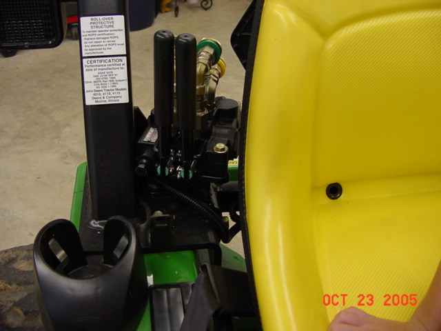

I also think the 2 or 3 spool valve is the way to go...
As far as hoses, they can be managed like MAD said, it's all in the planning.
Here are two pictures of my 2 spool valve:
Here is a link to the whole thread:http://www.tractorbynet.com//forums/showthread.php?t=69599
You could add just a 2 spool for the rear, and a diverter on the FEL to operate your grapple, here is the thread on my install:http://www.tractorbynet.com//forums/showthread.php?t=48310, you can also find a lot more if you search for "diverter"

1) This is probably tractor specific, but what do I connect these two new valves to? Do I need to buy and install a manifold or something to get the extra ports to connect these valves to the existing hydraulics on the tractor?
How is your 1 spooler plumbed now?
I used the JD PowerBeyond kit to hook up my remotes as detailed in the link I posted in the previous post. If this is the way way yours is now, your just need to replace the 1 spool valve with the 2 or 3 spool valve.
Some pictures of your setup would be worth a thousand words, literally!

It's one valve with 3 spools. Your existing 1-spool valve is connected in series with the loader valve. The loader valve power beyond line goes to the inlet of the new valve. The power beyond of the new valve goes to the 3pt. The tank return outlet of the new valve tees into where the loader valve tank line goes. All the plumbing can be virtually out of sight.
