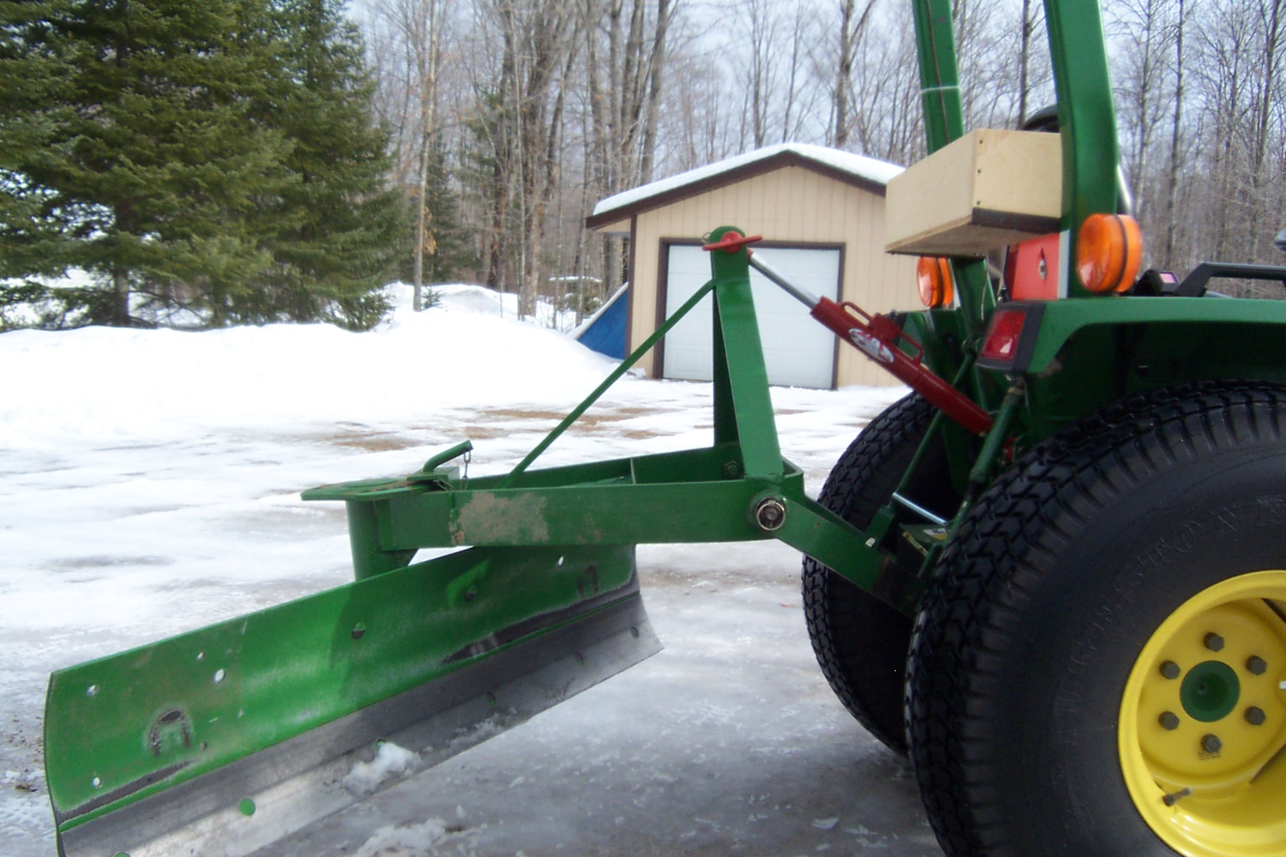

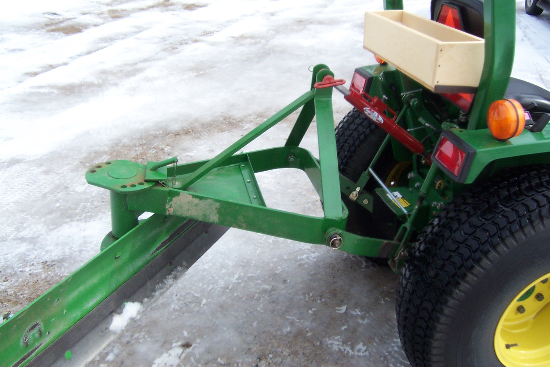

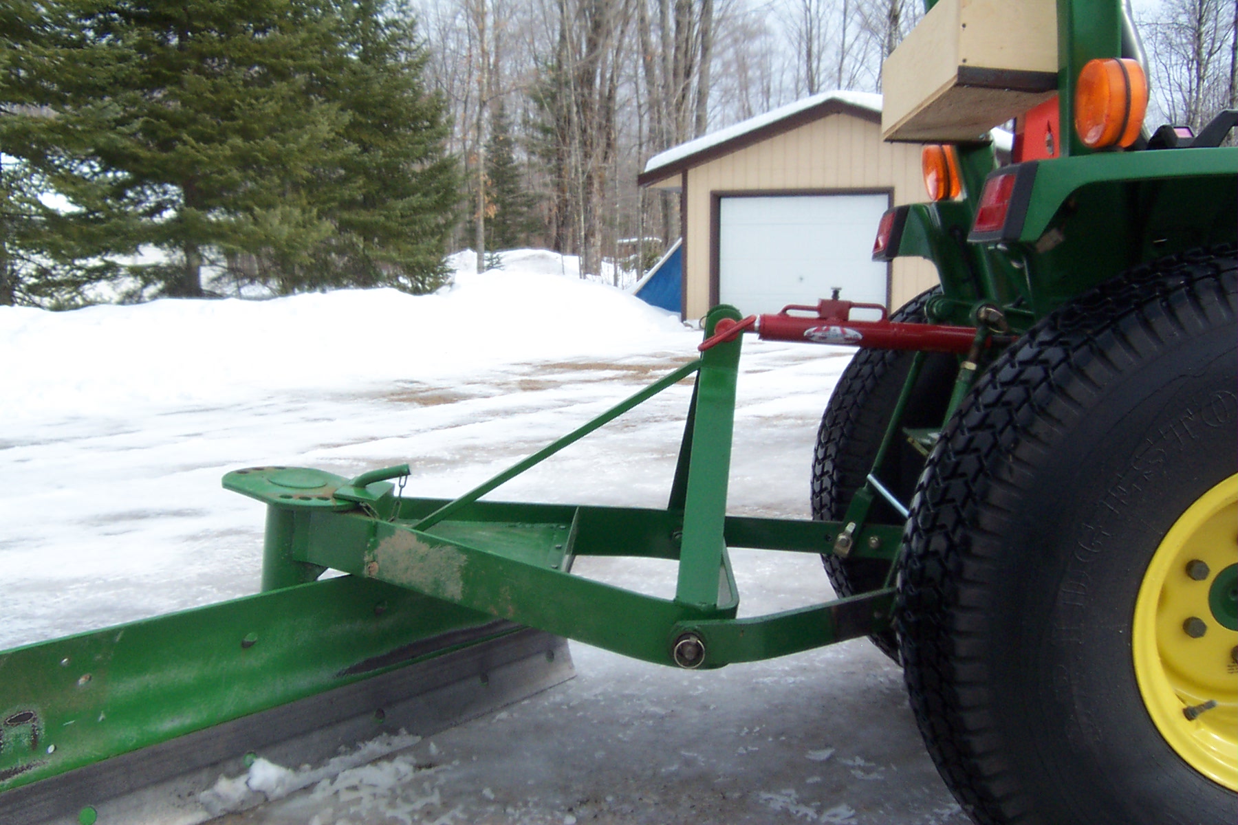

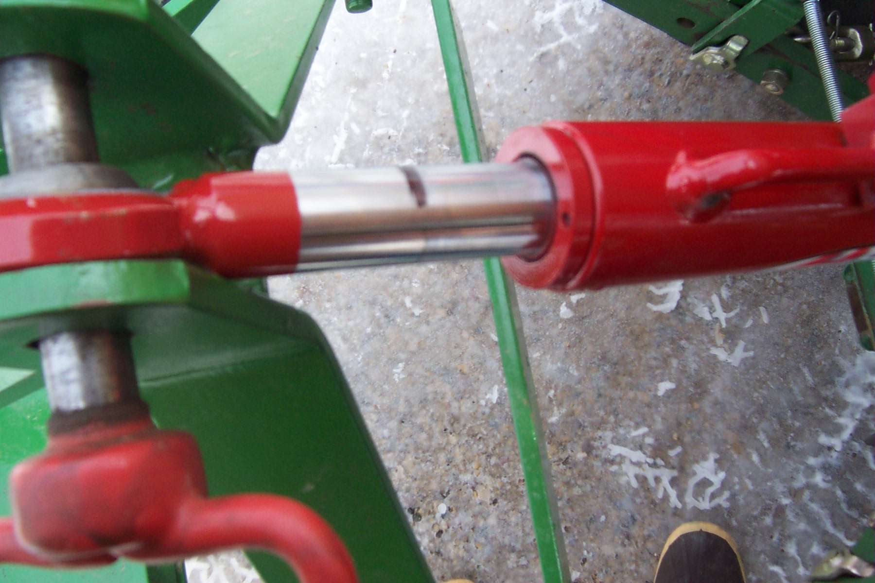

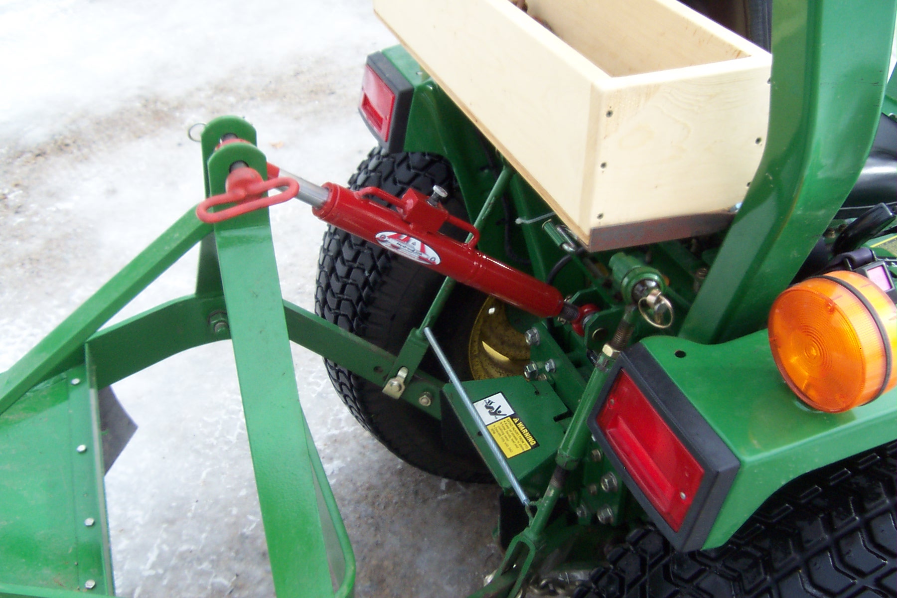

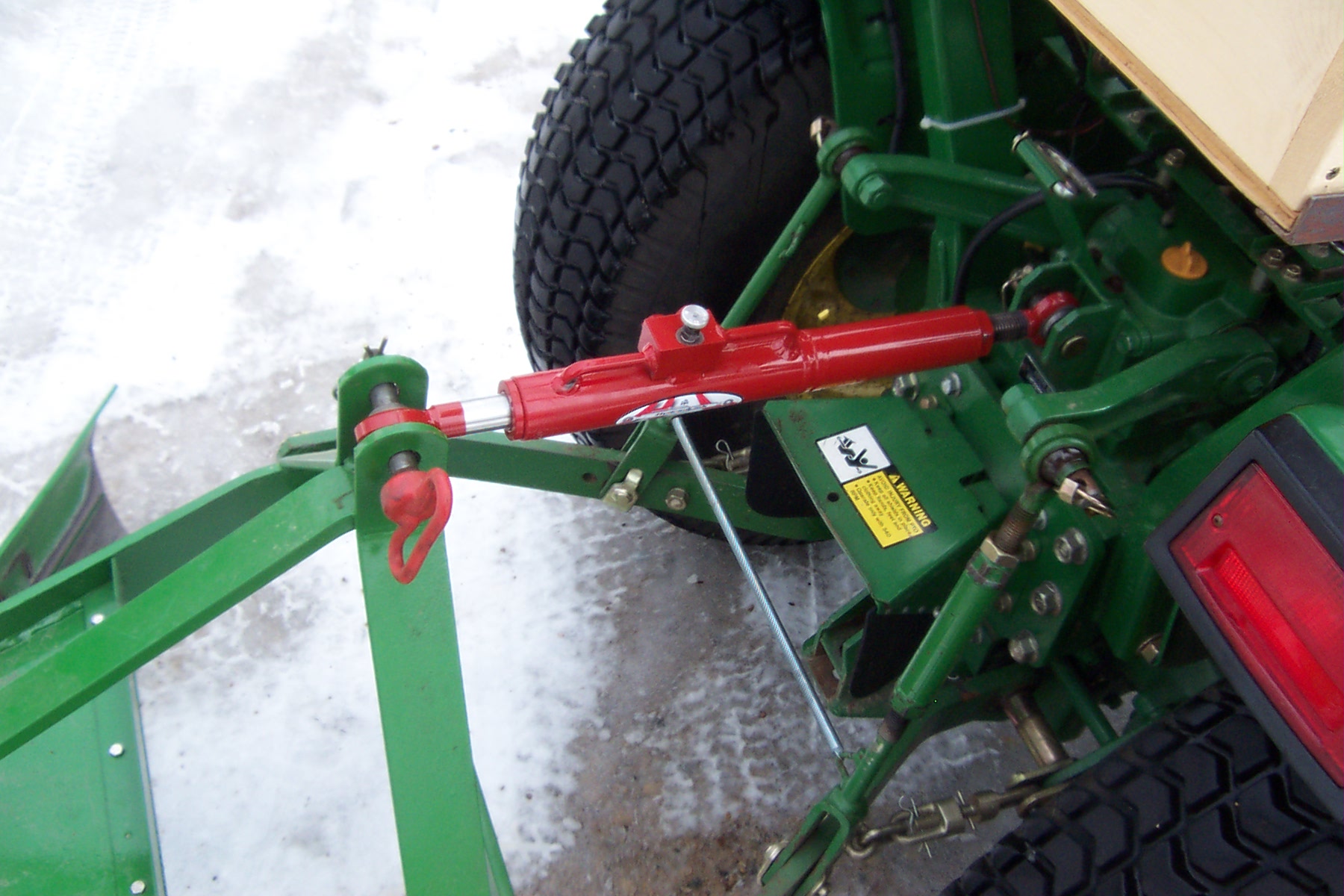

I have read this thread from front to back and visited the website. There was a lot of opinions both for and a lot more against. I decided to make up my own mind. I have just bought one on Ebay for 231.98 with the shipping. For that price I thought I would try it. I will let you know how it works and some pics if I remember to take them.
Well it's been a while since I installed the HydrauLink on my 770. I didn't want to report on it without much seat time. This is my opinion of it. It works just like they said it would. It gets some getting used to because of the 1 1/2" travel/float it has. Now that I am used to it it's not a problem at all. I have only used it with my back blade so for someone that uses other attachments it might not work as well for them.
Before anyone asks, the last pic is of a blade extension I made for pushing the banks back on my driveway. Works good.
Overall I give it a thumbs up. :thumbsup:If I had another tractor I would buy another one. Especially now that the price is dropping.
