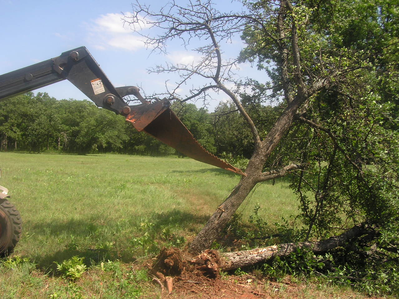

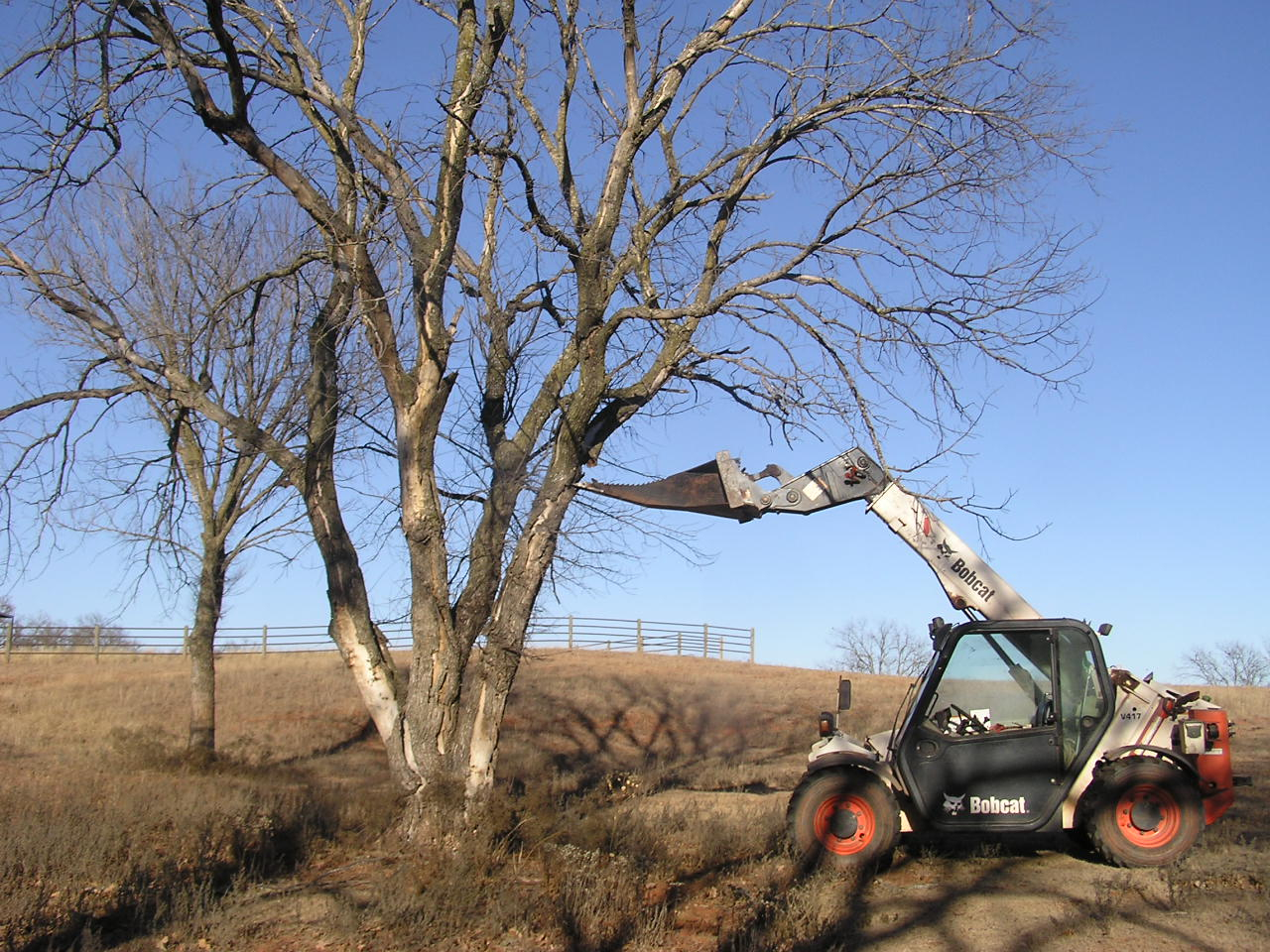

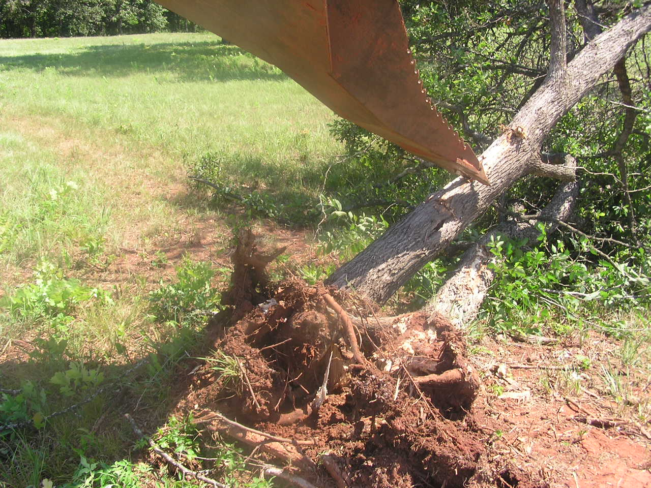

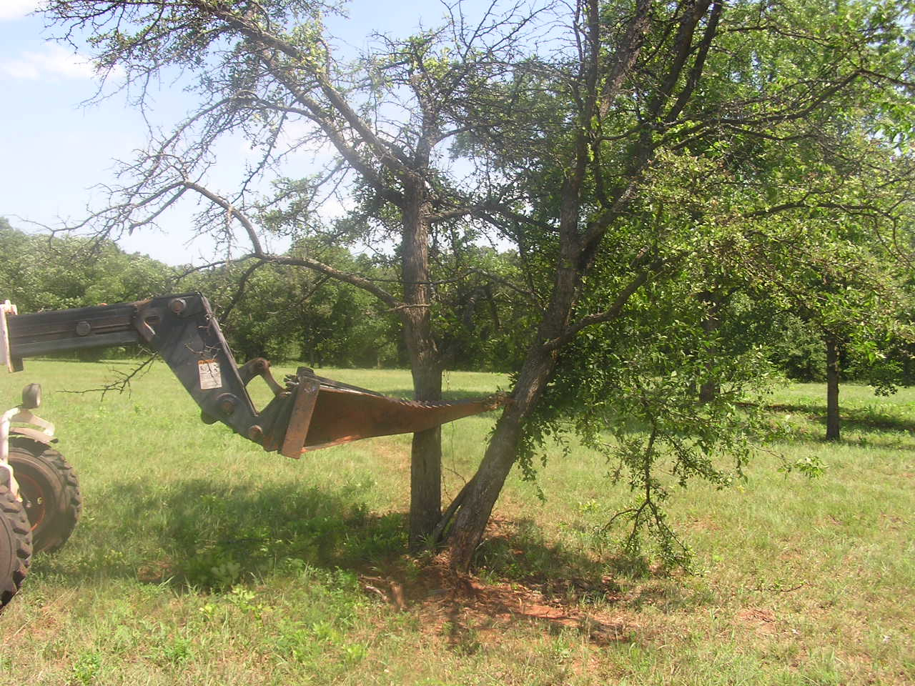

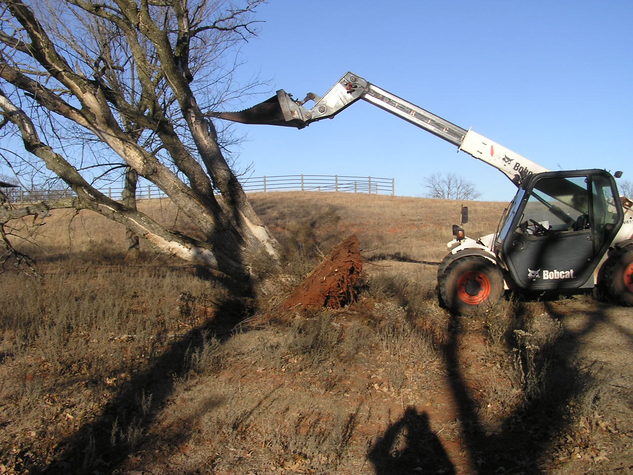

I use a stump bucket:
   / Hydro Ax for Pushing Trees #10

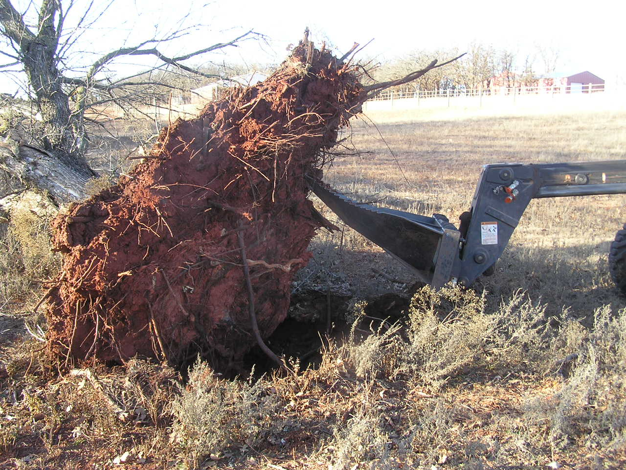

Dead trees are easier:
Balanced on the stump bucket:
