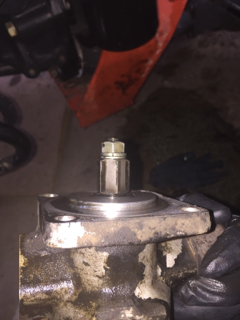

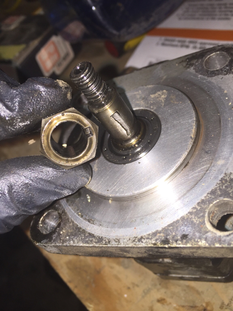

Both sides of pump. No key slot. Taking that nut off now
/ Hydro help #113
Good thats better. Go and get you loop made and your be back in business.:thumbsup:
/ Hydro help #114
I've been following along and learning by everyones comments. I am glad you found the issue. Hopefully it is a simple fix from here. Granted, you need to clean up the keyway slot on the pump shaft. I am wondering if there is some sort of relief safety that can be put in place so this doesn't dead head the pump again. I am relieved for you too!

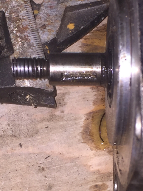

I am relieved to but this key is stuck in the shaft bad. Best way to remove it with out breaking the shaft? Drill? It's not magnetic ImageUploadedByTapatalk1457018597.783162.jpg
/ Hydro help #116
Try getting the shaft Hot and use a Chisel. Worst case take the pump to a Machine shop while your out getting the loop made. They can get it out and also will most likely have a key. :D
/ Hydro help #117

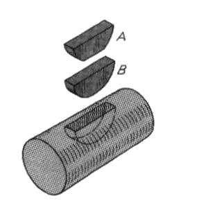

It is a woodruff key. Support the shaft, tap one end down with a pin punch, the other end will come up. Grab it with a pair of vise grip pliers.
/ Hydro help #119
Yup! seen that also. Plus there may be wear to the outer grove in the Hex bolt. I think a Machine shop is sounding like a smart thing to do. The outer Bolt has to have or most likely has wear from spinning. That's evident, that way you know that the key is snug fitting and the bolt also. It won't stand a chance of not shearing again if it's loose.
