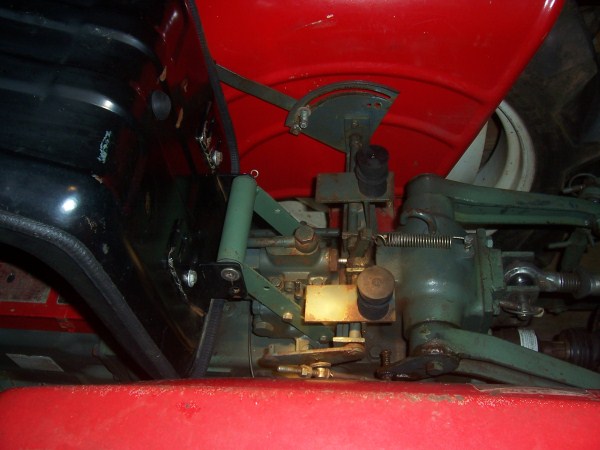

I would be looking at a Hyd. Valve however it's setup. Can't find anything on the valve itself or your setup. Here a pick of my 2000. so it maybe similar. It has the U-Vent and were the spring attaches to the lift handle is were mine raises or lowers the 3-point. If it is similar make sure it's working. Chrome Plunger in for up out for down.

Oh! I see that. No wonder then. Something has to Regulate the Fluid. What ever the setup is in there. Is what I would be trying to find out more Info. about. And on the Screen Absolutely get that clean.
