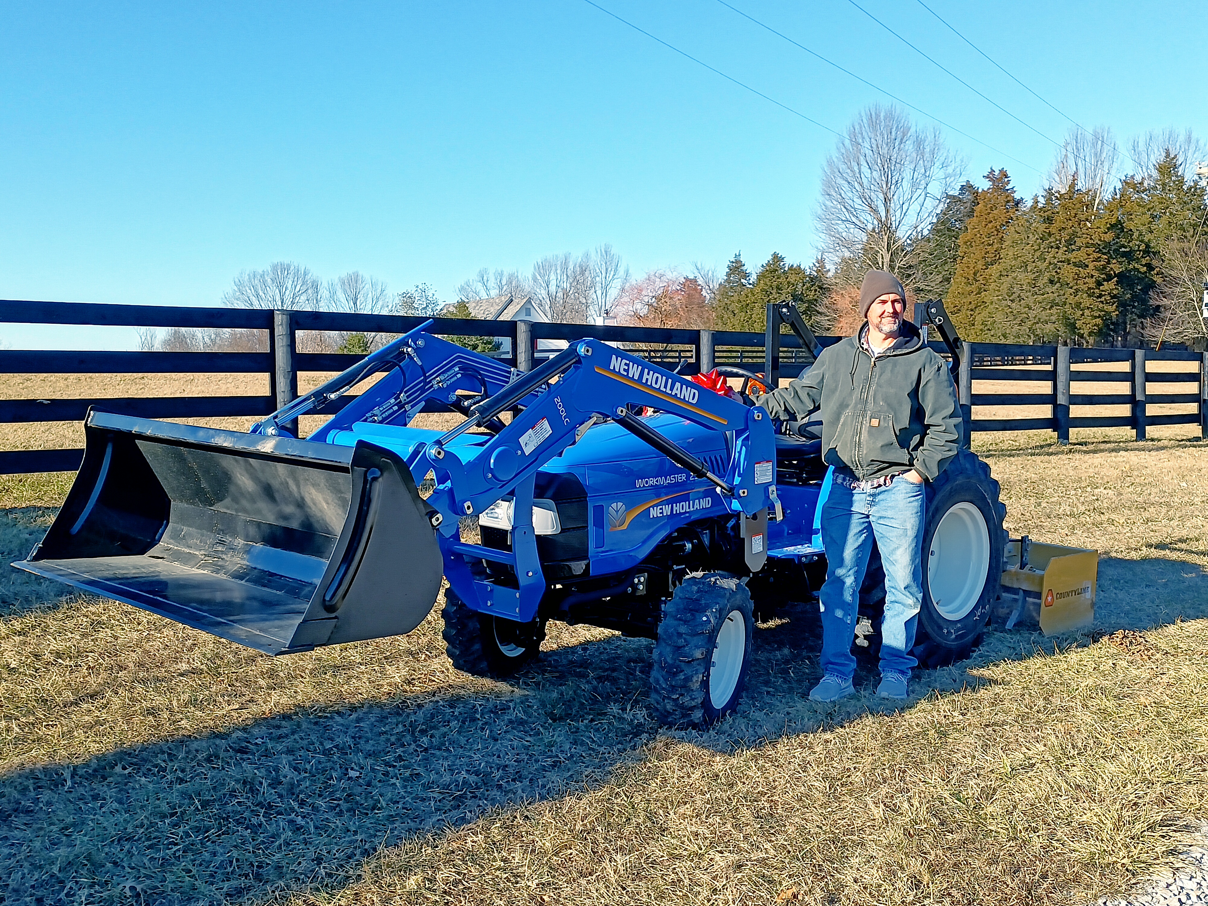

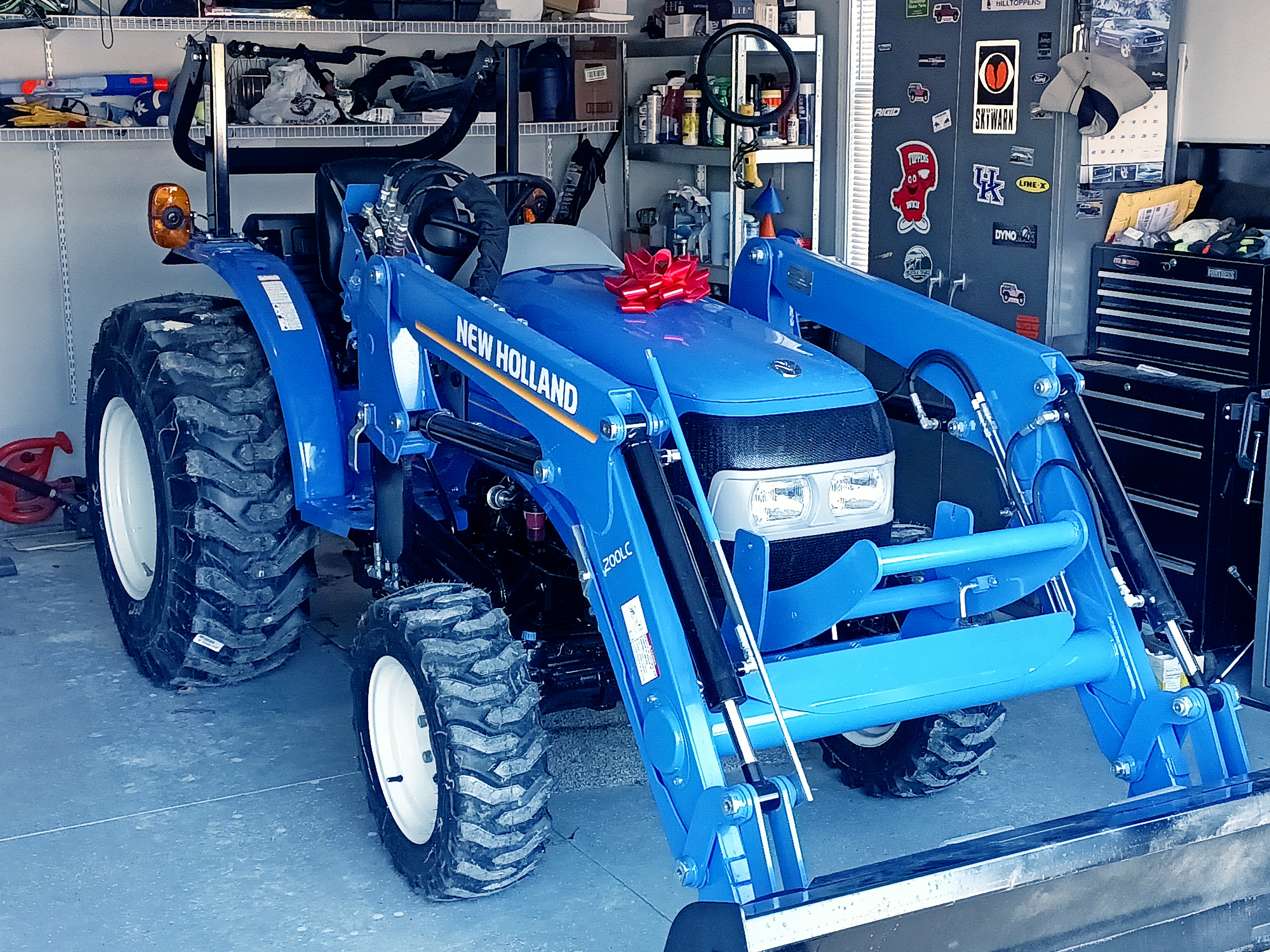

Brought home my new Workmaster 25 yesterday. With the loader, bucket, and fluid in the tires she's a heavy pig. Made the ramp on my enclosed car hauler crack and pop like it was going to snap. So far I like the tractor a lot, just not a fan of the non-removable side panels on the hood. But hopefully it'll be a good tractor. The hydro controls are so nice. If it's got enough power to drag a 5' box blade full of #57 crushed stone up a 10% grade, it'll be all the tractor I need.

Funny you mention that, because I noticed that and I tried that and I believe I broke something. Didn't even have the hood swung all the way back and that plastic hinge nut cover on top of the hood popped loose and I heard something snap and fall into the engine bay. Sigh..... So that's not going to work for me. I guess when it comes time for service I'll have to remove the loader. That's a real bummer.
Should I be running the engine full RPM when using the box blade? I tried it tonight and when I hit the hill in medium range at 2,000 RPM the tractor really bogged down. And I didn't even have the box full of gravel. I was just lightly leveling the ruts out of the driveway.

I rarely use full rpm for any task. Box blade will need to be in low range. My 33 & 35hp tractors (same size, wt) will bog in 'M' before a box is half full. If the tires spin in 'L' it's too full for the tractor's weight. :p
btw, I've found using a landscape rake is much easier for grading. Lift links allow quickly raising/lowering one side by putting a pin in different hole. This saves counting turns of a leveling box handle and remembering/finding the 'level' position again. For about $125 you should be able to replace the OEM turnbuckle-type adjuster with one as I did on my NH T1520.
Biggest advantage I've found for LR vs BB is that I can build a crown by angling it and doing so leaves no ripples as is the norm with a BB. Finesse with a drag anyway. Good luck with what you do, and congrats for choosing a winner. :thumbsup:
btw, for service access, instead of removing the FEL, raise it to full height and prop it up with 4x4 etc. It's about as good as taking it off to get at things under the hood. ;)

I'm guessing that you are aware that being too aggressive on the hydro pedal when under load is counter productive. In other words, pushing the pedal too far will cause the hydro's relief valve to open and the tractor "bogs down".
It's a bit counter intuitive but you have to "feather" the pedal to get maximum torque in any gear range.
