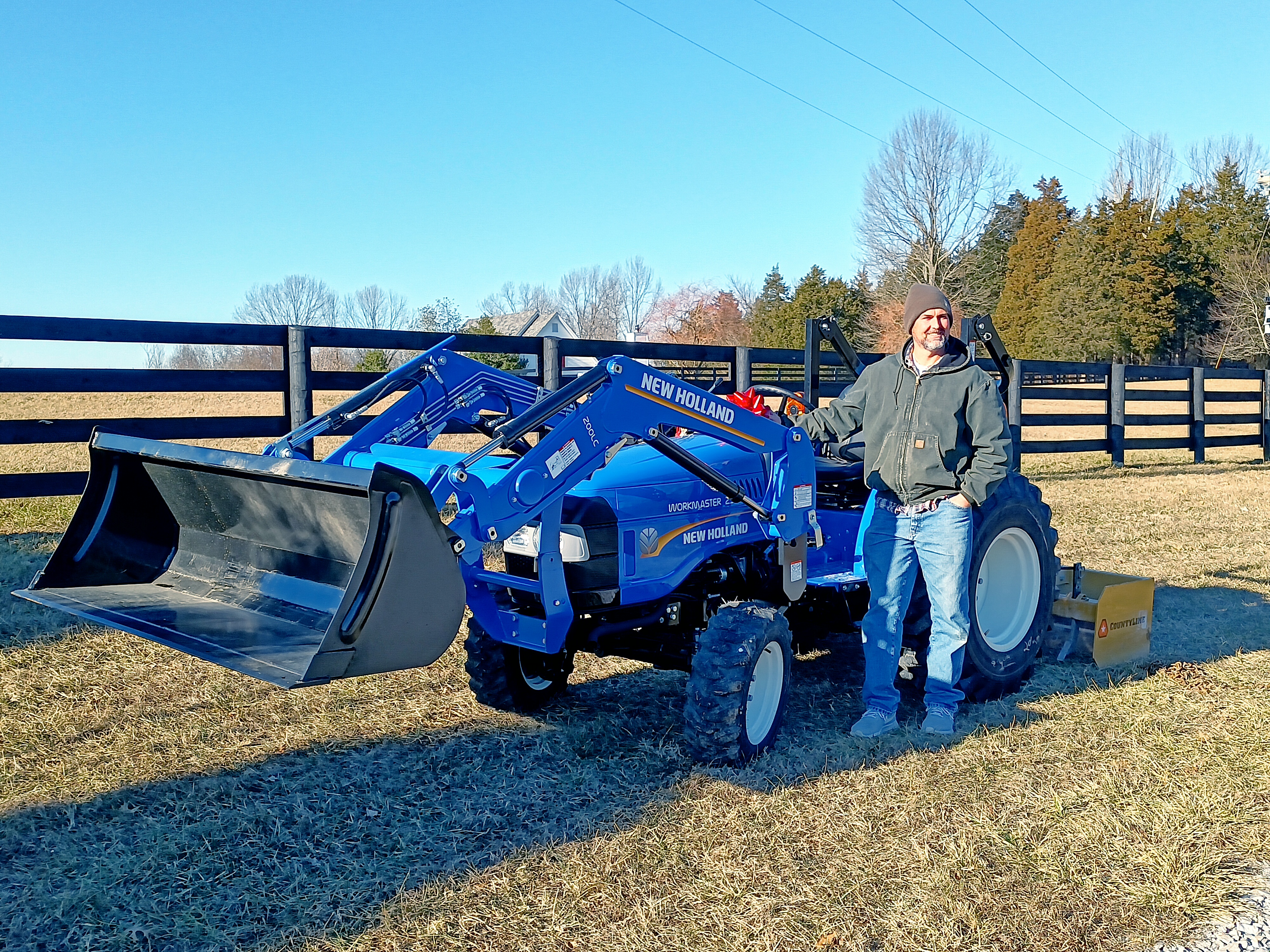

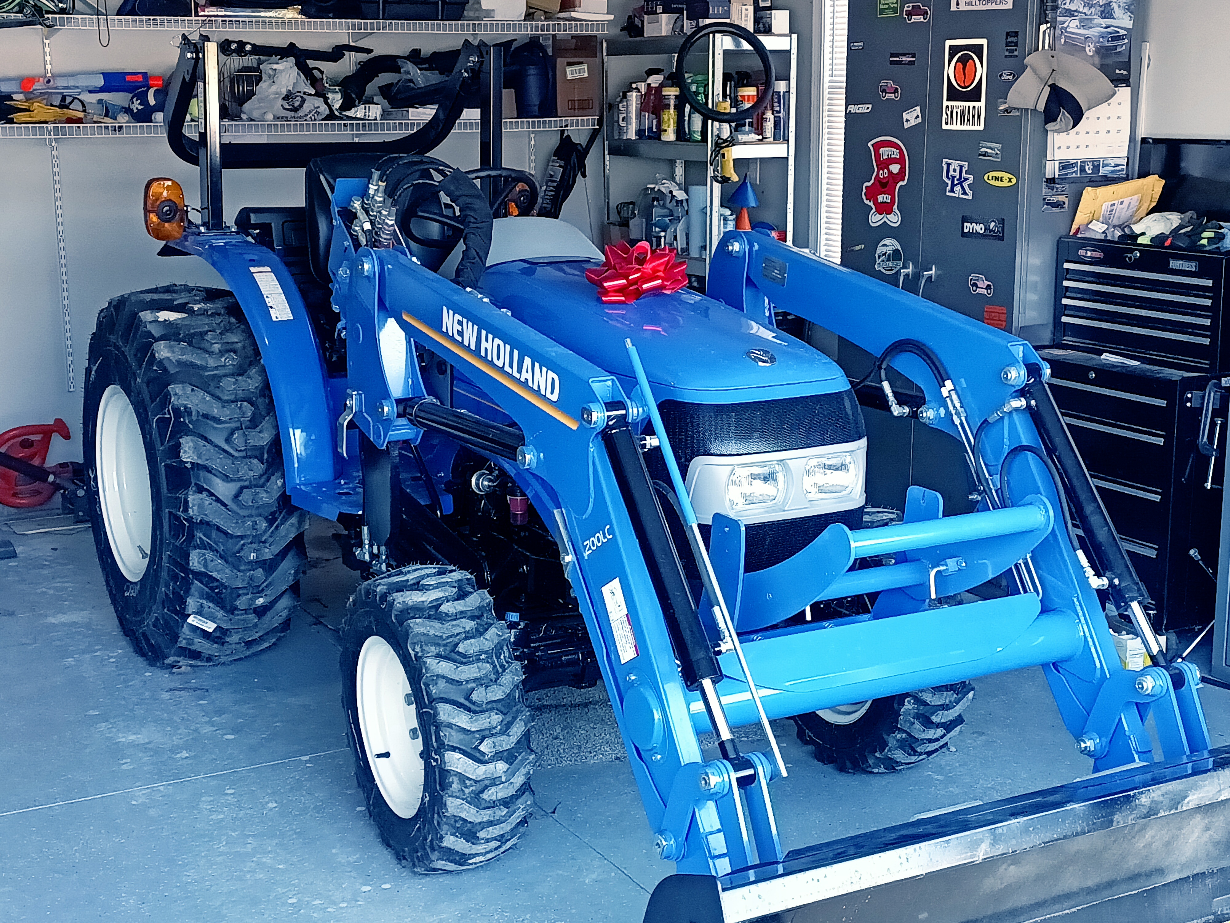

Obligatory picture:
View attachment 683868View attachment 683869
Nice unit. Way too tiny for my uses. Wrong tires too. I run radial R1' but then I'm on cropland all the time. Always been a New Holland fan but I don't care for the European designed larger units so I stick with my large frame Kubota's. I run exclusively NH hay tools however. red and orange seem to get along just fine.
let the OP enjoy his honeymoon w/his new equip. he did his homework in his decision making according to his needs.
we all can brag about the size of our own equip on other threads.
just out of respect & courtesy for someone w/a new machine...he seems seems happy w/the purchase, that's all that matters :)

Great looking tractor.Enjoy..
