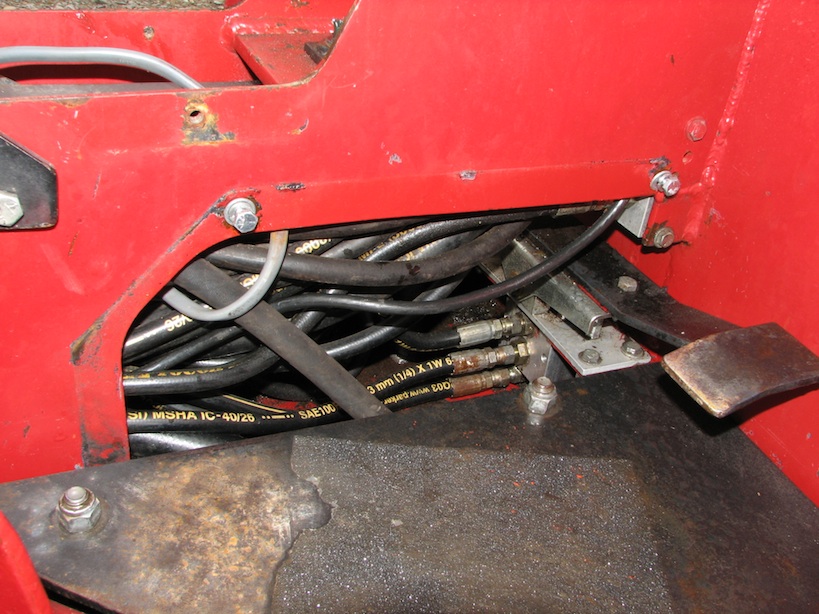

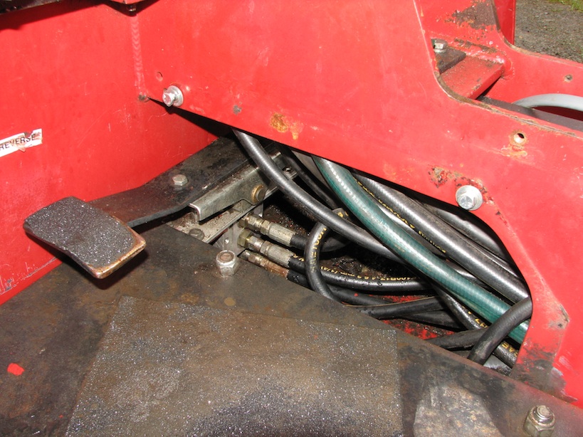

Did you happen to check on the price of the Hydroback unit? The folks here at PowerTrain said they could order one for about $65. My cable is the same as yours and Bobs. So the travel would be the same. I was thinking that the 3 in would give me more travel on the shift lever on the VSP, while mounted in a different hole on the end plate.. I have some pictures below. Have you tried to mount the end fitting in a different position, like the three holes in the triangular plate. I would suppose that you can order the Hydroback unit with with 10 lbs spring or the 20 lb spring.

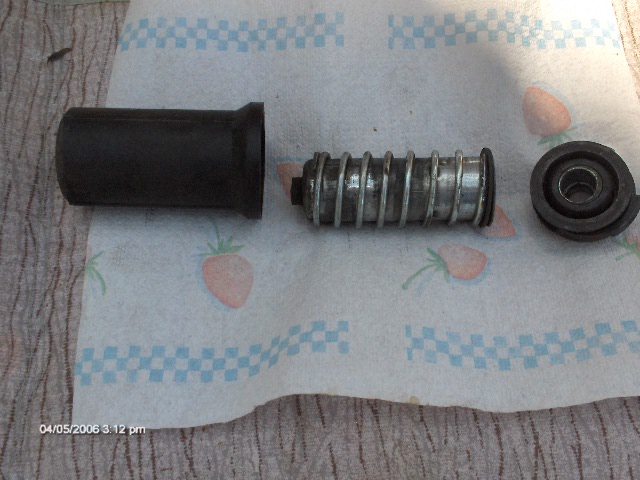

I was having trouble with my PT422 not stopping when releasing the pedal and sticking off center. I ended up lubing everything. I think the hydroback (the thing with two springs in it) was the worst of it. I sprayed some silicon teflon lube into the non-cable end (in both inner and outer cylinders) and worked it back and forth. I also made a very small adjustment in the cable position. It seems to be OK now. I have over 800 hours on the machine.
