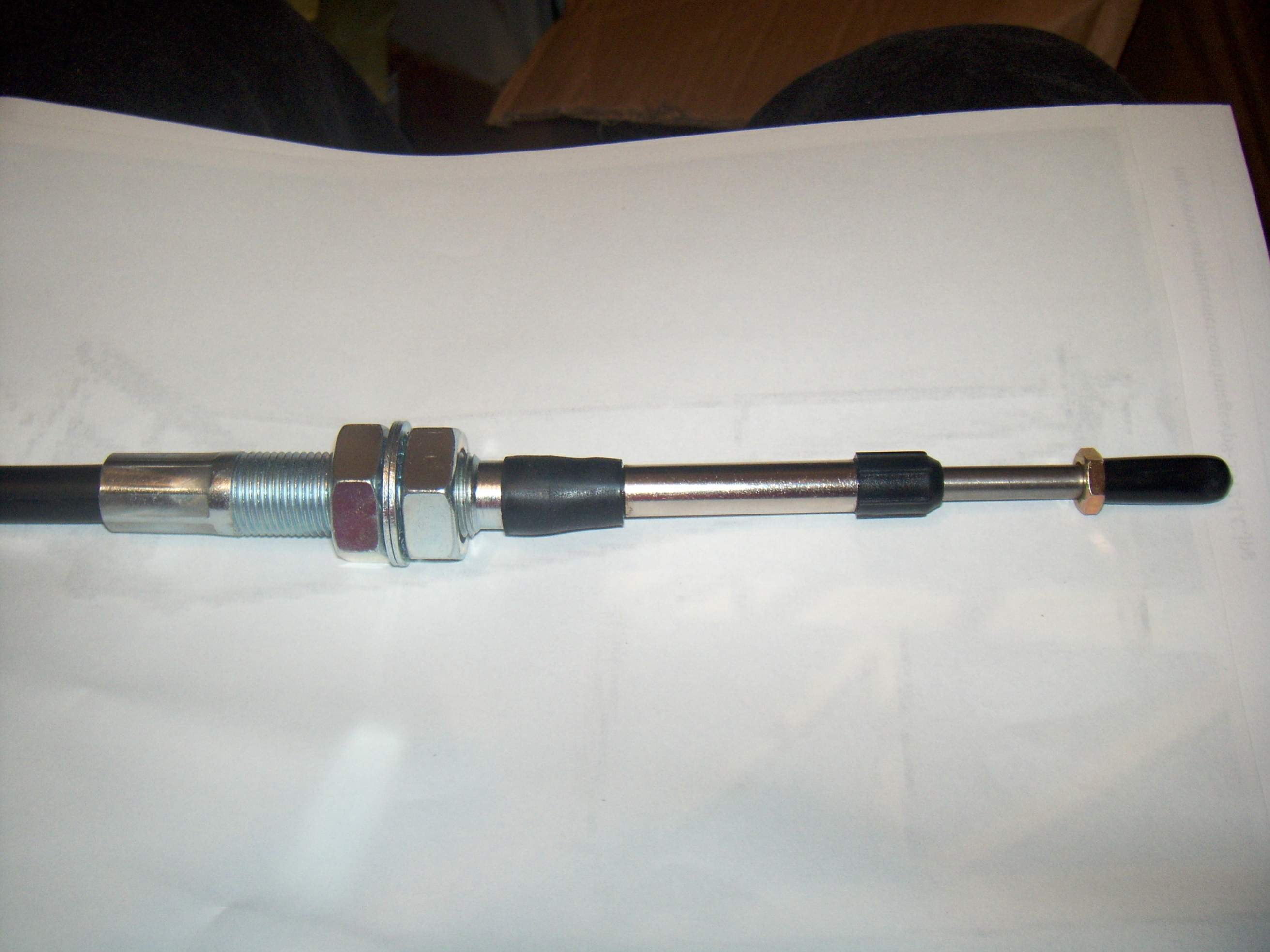

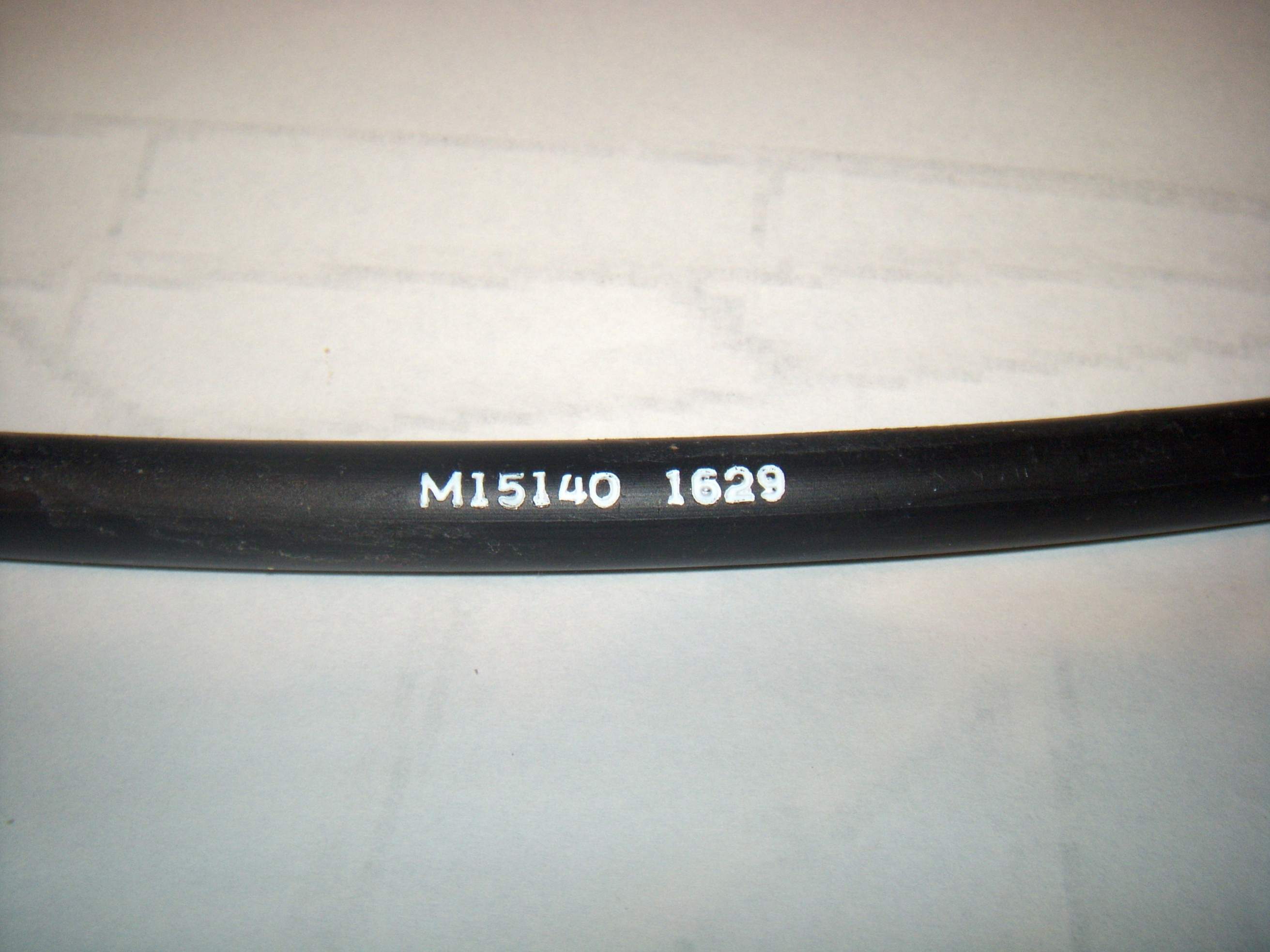

Would you tell us how the valve works. and some pictures.
/ Hydroback Cable #22
Thanks JJ, do we know which we use the 10 or 20 pound?
Also anyone able to post pictures of the hydraulic replacement for the Hydroback cable--as used on the new machines?
Thanks
Bill
No, I really don't know which one PT uses. There have light duty Hydrobacks, and Medium duty Hydrobacks, with cable movement of 2 in, and 3 in. You might be able to cheat and add spacers in the unit, which would compress the springs .

I found a company that sells the Hydroback cables locally, and the cost to replace my cable which is 84 in, is about $111.00, and the Hydroback unit is about $65. This was for a Medium Duty, 3 in travel, and 20 lbs. If the cable could be hooked up directly, it would work better. Right now, my foot pedals pull a bracket that pulls or pushes the cable, and the other end also pushes or pulls a bracket that moves the lever on the transmission. Do no not tighten the floating brackets to much, it will add extra lbs to the cable. Just tighten up the bracket and back off about one turn. Those of you that use a pressure washer on the PT, try not to squirt water/soap into the cable assembly.
