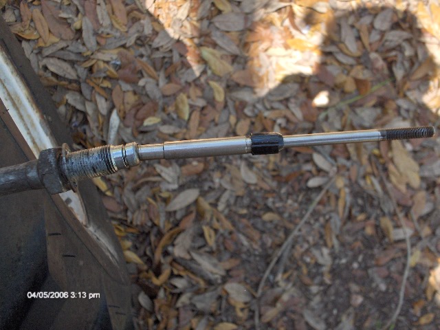

   / Hydroback Cable #42
I received my cable today, and it looks just a Morse heavy duty control cable. The only numbers that are on it are M15140 1629 . Both ends are the same. The M may stand for Morse, I will try and verify. I think what I will do is to connect both cables with long treaded nut and slick it up with cable lube and pull it through the tunnel. Just hope it does not jam up in the tunnel and scrape the hyd hoses or rip some wires out.

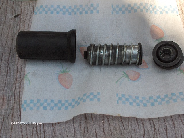

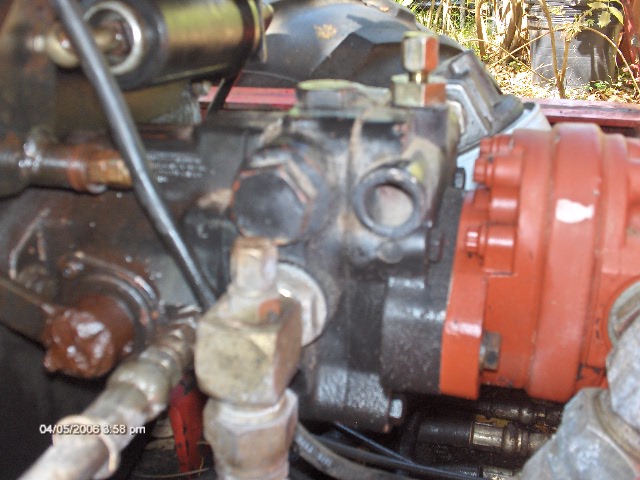

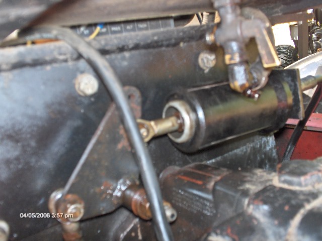

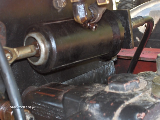

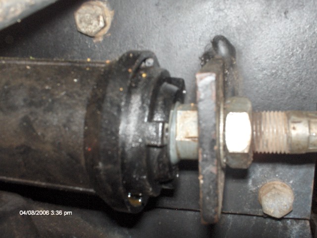

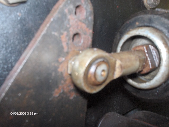

Don,
Did you happen to check on the price of the Hydroback unit? The folks here at PowerTrain said they could order one for about $65. My cable is the same as yours and Bobs. So the travel would be the same. I was thinking that the 3 in would give me more travel on the shift lever on the VSP, while mounted in a different hole on the end plate.. I have some pictures below. Have you tried to mount the end fitting in a different position, like the three holes in the triangular plate. I would suppose that you can order the Hydroback unit with with 10 lbs spring or the 20 lb spring.
