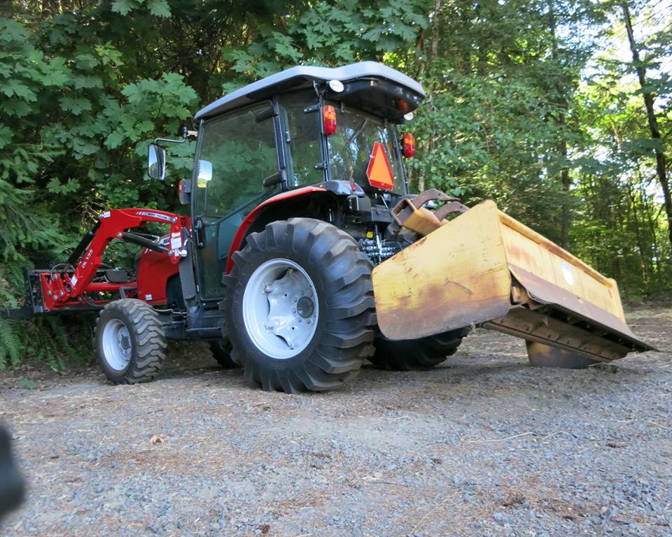

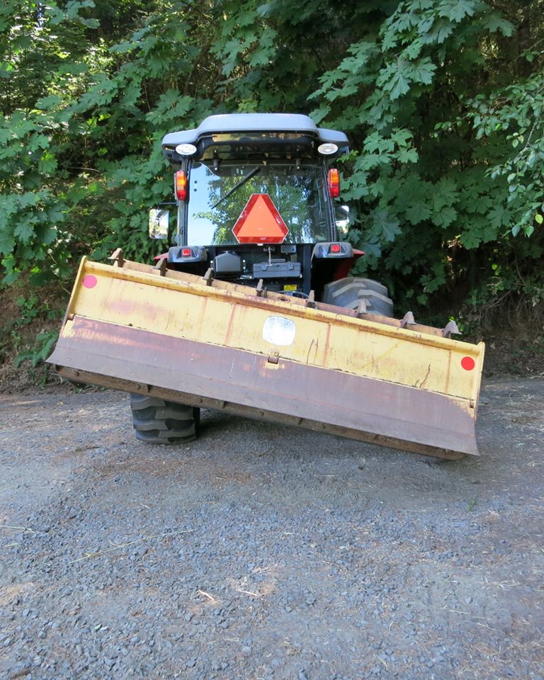

For rear blade and box blade use the hydraulic top link is great, but I'd recommend getting an additional hydraulic side link to really make those implements get more done in less time. It's amazing how much time it saves, just by letting you make little adjustments and see immediate results. An unexpected benefit is using top & tilt cylinders when the (manual feed) wood chipper is on the back - it makes getting the chipper to self feed a lot easier by adjusting the angle of the feed chute. Brian, at FitRite, did me a square deal.

Due to my TnT (Toplink & Tilt link) & Quick Hitch I can pick up any implement without getting off the tractor, no matter how crooked its sitting.
Makes running a box blade a dream. I can tilt forward to engage scarfires as needed from the seat. My L3200 has a notoriously jerky 3pt, but I can get excellent smooth driveways with the toplink. Tilt a hair forward to fill the box a bit faster, tilt back to smoothly make the box empty faster.
On my mowers I leave the toplink in float so that it follows contours nicely, but when I need to back over a ditch or swing the mower over something, I can lock it straight so it sweeps the ditch without falling in & twisting things up. I can lift the mower way up for clearance loading or maintenance (use a safety brace) at will to.

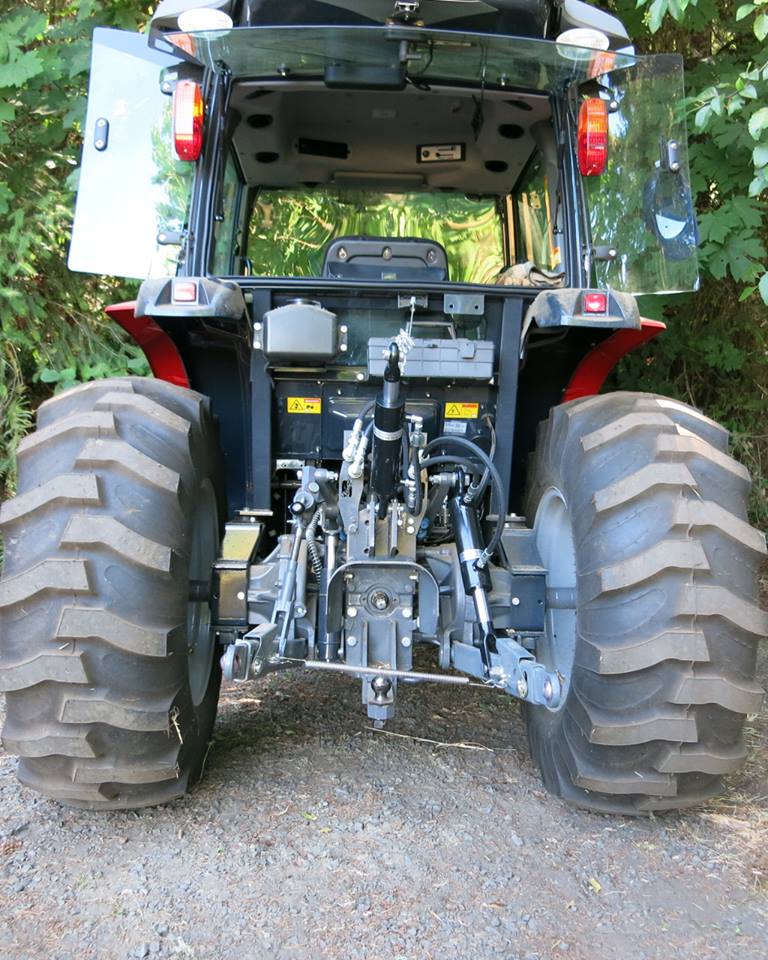

I have nothing "pro" to add that hasn't already been said. I can add that I went through Brian for my TnT, and he had never done one for my newer model tractor before. But the man knows his ... stuff, and after taking the requested measurements that he asked for, when it showed up there were no hiccups at all. It just installed and worked right out of the box. I can also add that the quality has to be seen and hefted to be believed. The walls are THICK and everything is welded. The finish is thick and tough as nails, not a bit o' paint shot on. That TnT will long outlast the zombie apocalypse. Absolute highest quality at a very fair price. I can think of no cons.
