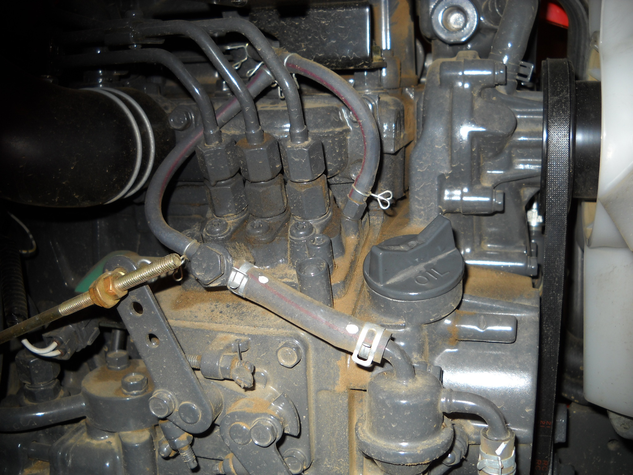

I am trying to relax but cant. Is you tractor close by - can you run out and see if you have a Oil Fill right under the air-intake?
I dont deserve to be a member of the site.
So ashamed
AH!!!!!

Take a pic of both and post them to see. It may be it has 2 oil fill caps.

I will go out - it's raining and it's outside so you owe me- just kidding. I know mine holds a bit less than four quarts and yours should hold a bit more according the the manual. I think yours has a larger sump thus maybe the two caps - I will check mine now.

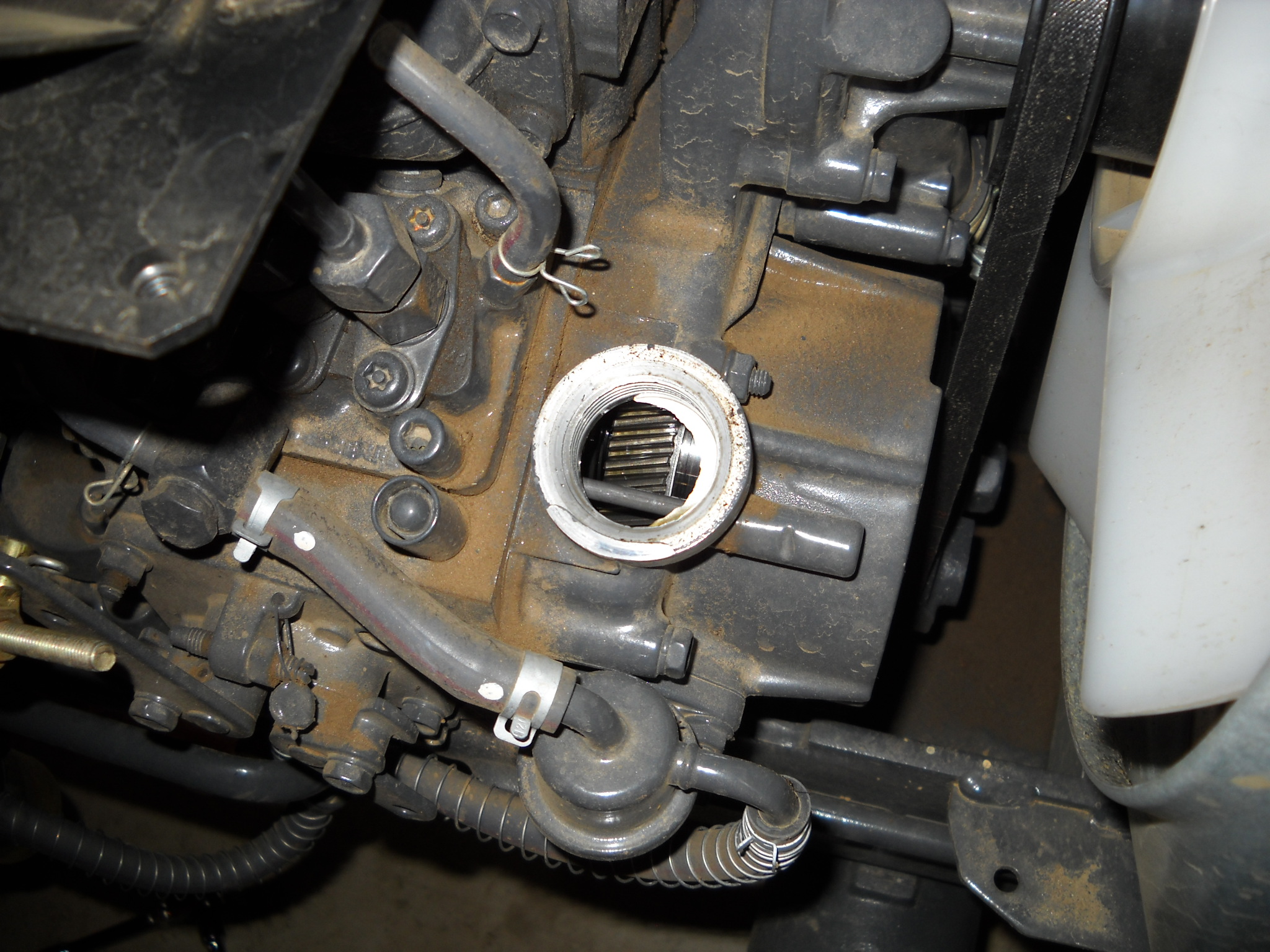

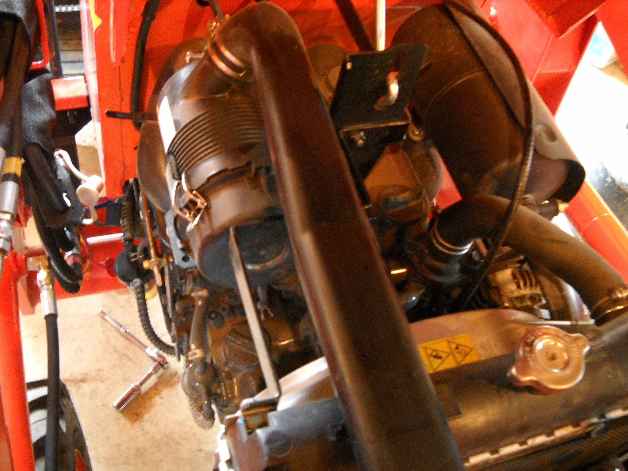

Here ya go guys.
806 - Show both Oil Fills
818 and 821 - The Lower Oil Fill (the one I used)
817 - The two drain plugs
What a nice Sunday.

I've just got one filler cap on the rocker cover and one drain but it is a smaller engine. Man - I think I know your problem! You don't have enough oil in there yet. Mine didn't show until I was over three quarts and you have an even bigger sump. Start putting more oil in the top fill, you aren't up to the stick yet! - Man -I am almost sure that is it.

It looks to me like you can use either hole to put oil in.
Did you add enough oil to hit the dipstick yet??

Hum....I dont know about that - I have almost the entire gallon in there now -its suppose to be 3.7 qts.
I am thinking maybe the sump has two sections and I filled up the one that doesnt show up on the dip.
