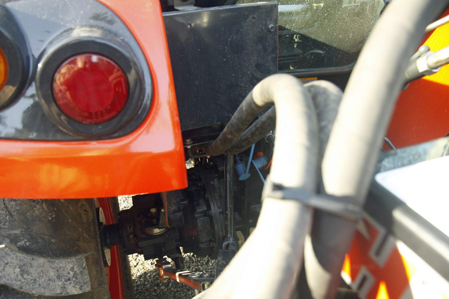

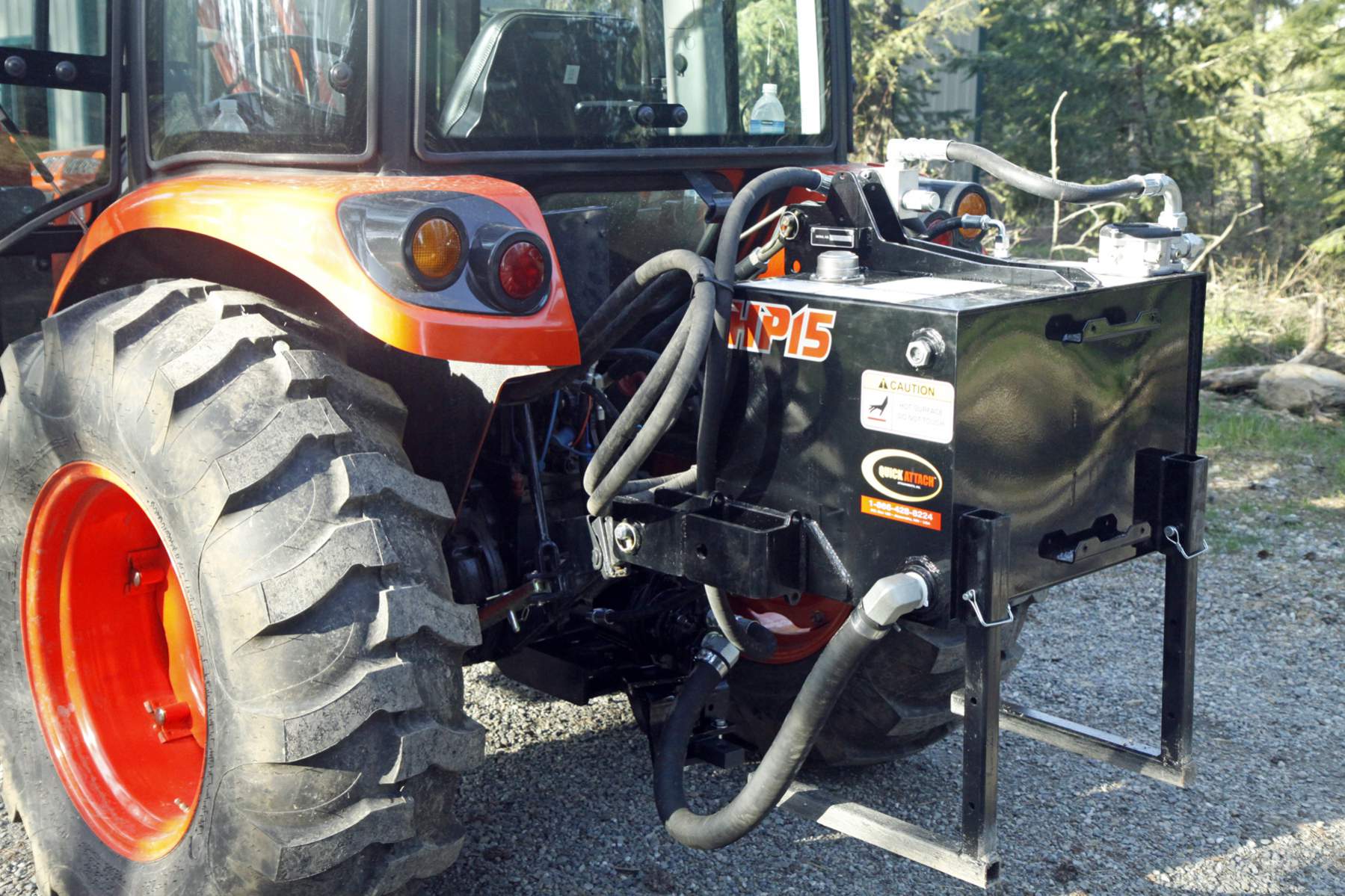

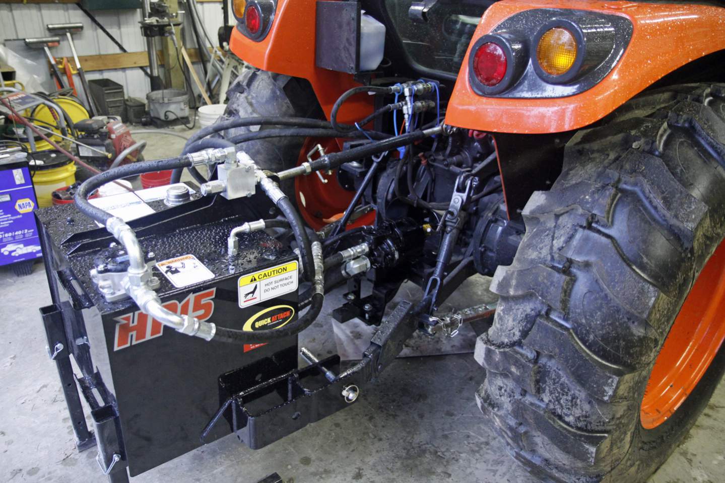

no. he needs ext hydraulics to power the blower. On my system, the hud pump is mounted on a bracket that attaches to the tractors drawbar. I too had to use a 6 spline extension, but i have no wobble on mine. final rear powerpack 1.jpgpowerpack 1.jpg

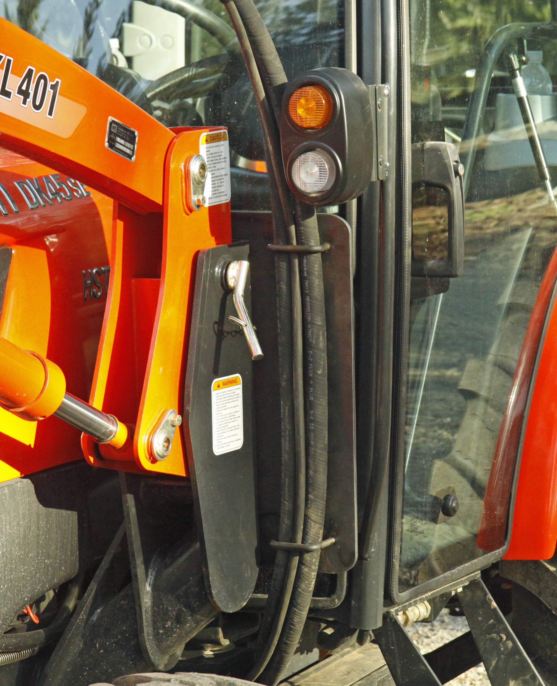

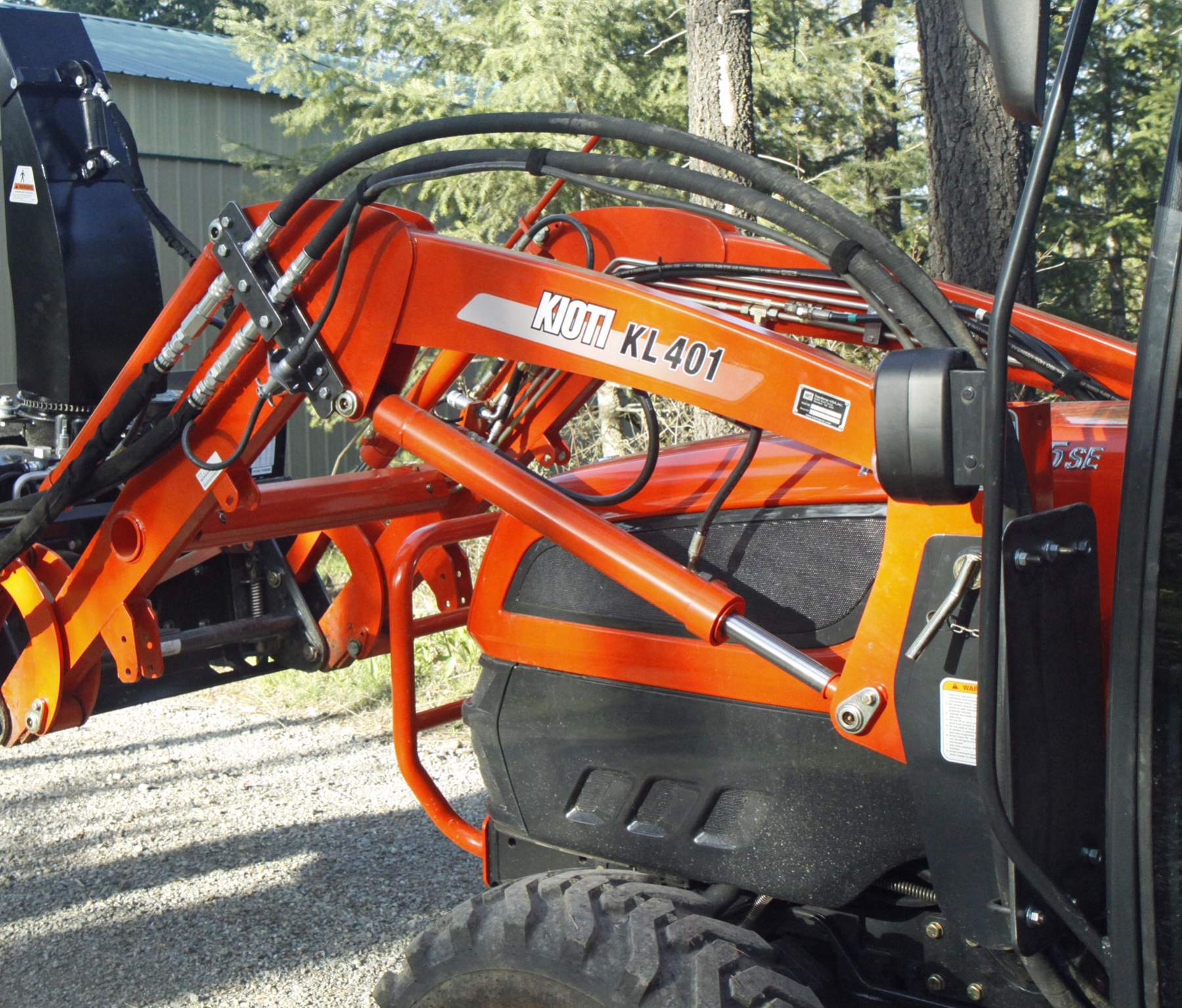

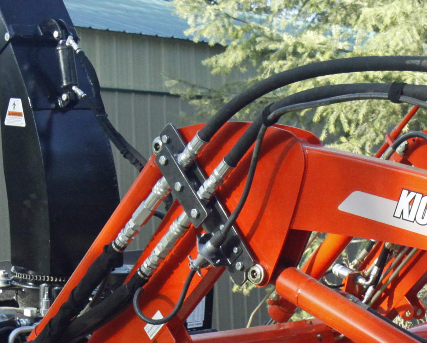

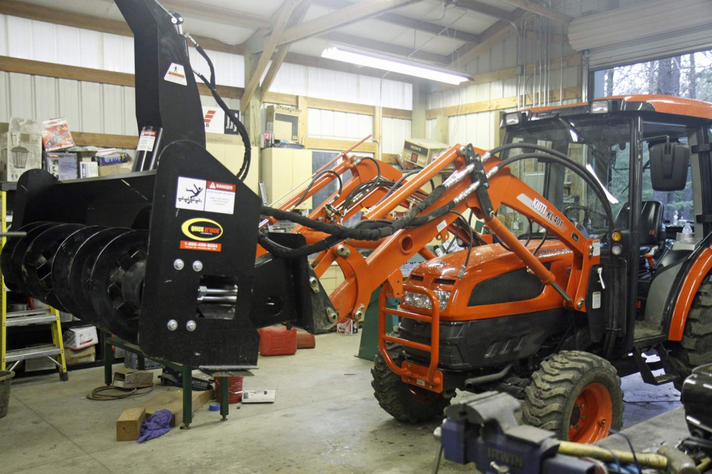

Grsthegreat, I see you have a cab. How did you run your hoses to the front? Do they go up the FEL side arms? On my L 39, no cab, I magnetically attached to arms and I could raise the blower as high as I wanted. Running under my cab, I can't raise the feel very much. I used tie wraps to hold the uses. How are yours mounted?

Here is a thread where Grsthegreat shows how his lines are run: http://www.tractorbynet.com/forums/attachments/205921-making-brackets-installing-quick-attach.html

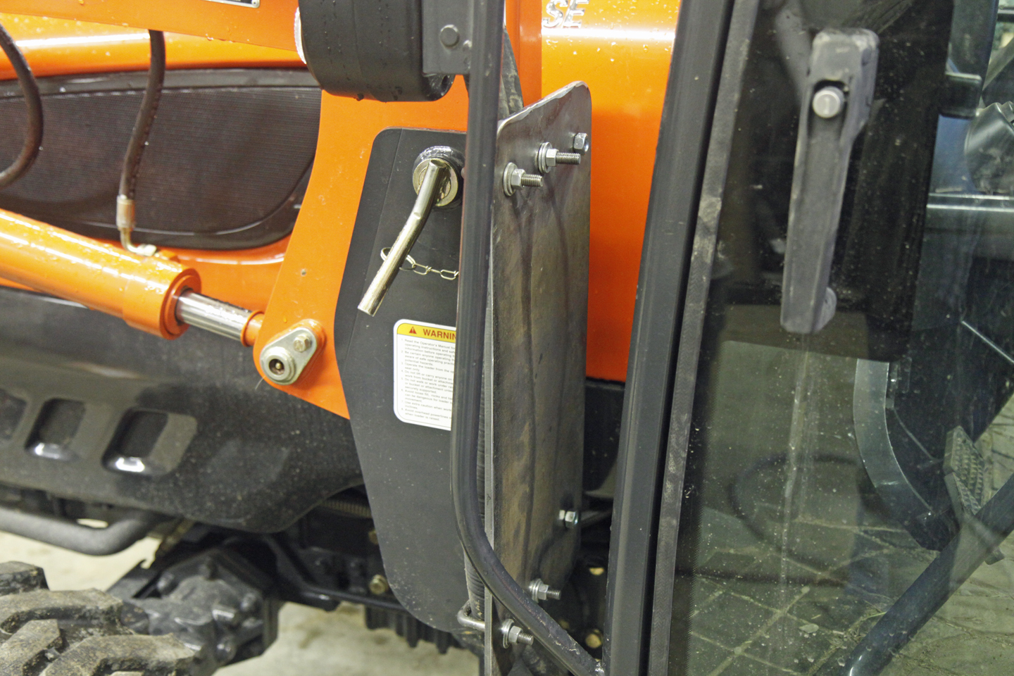

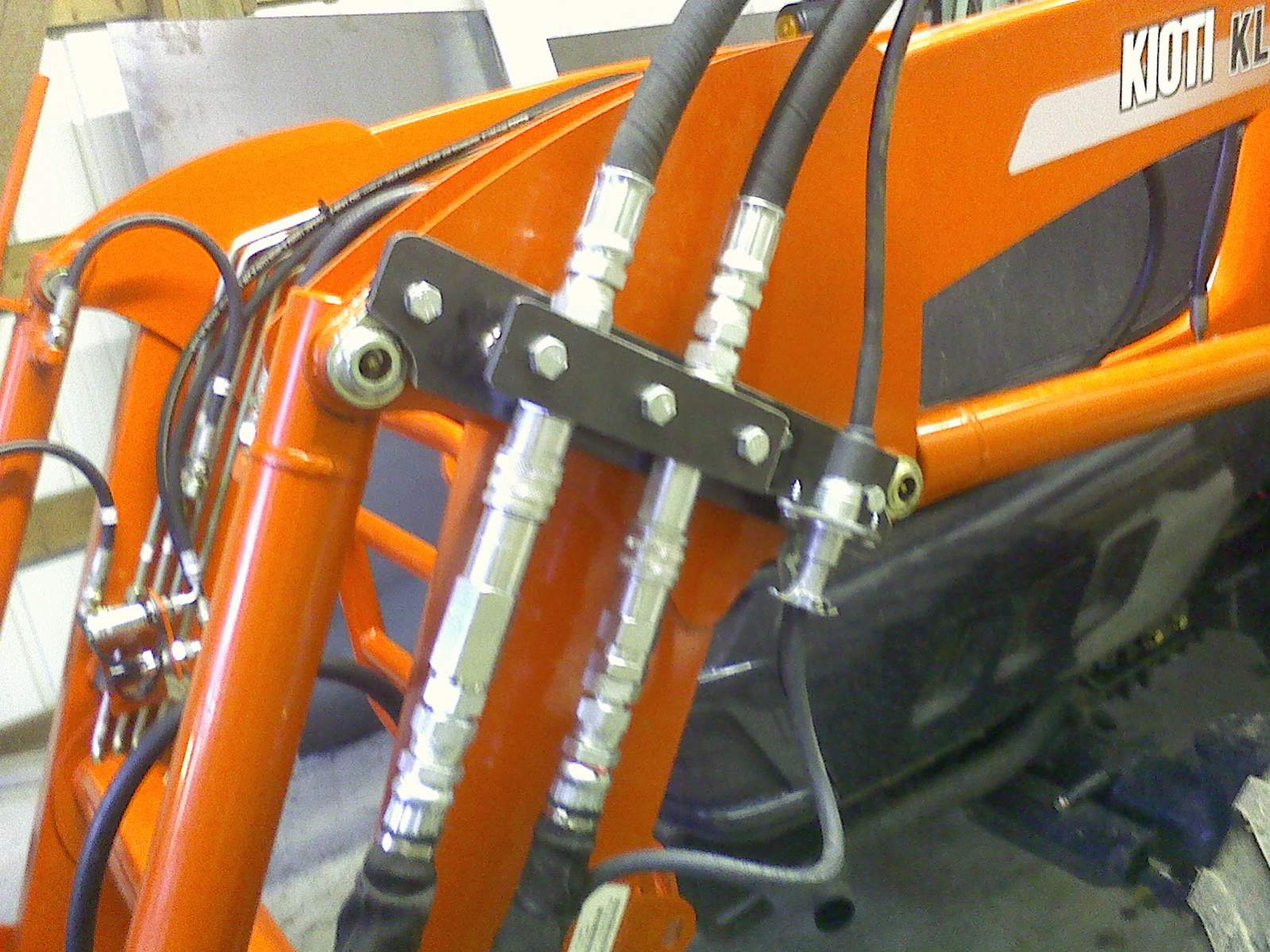

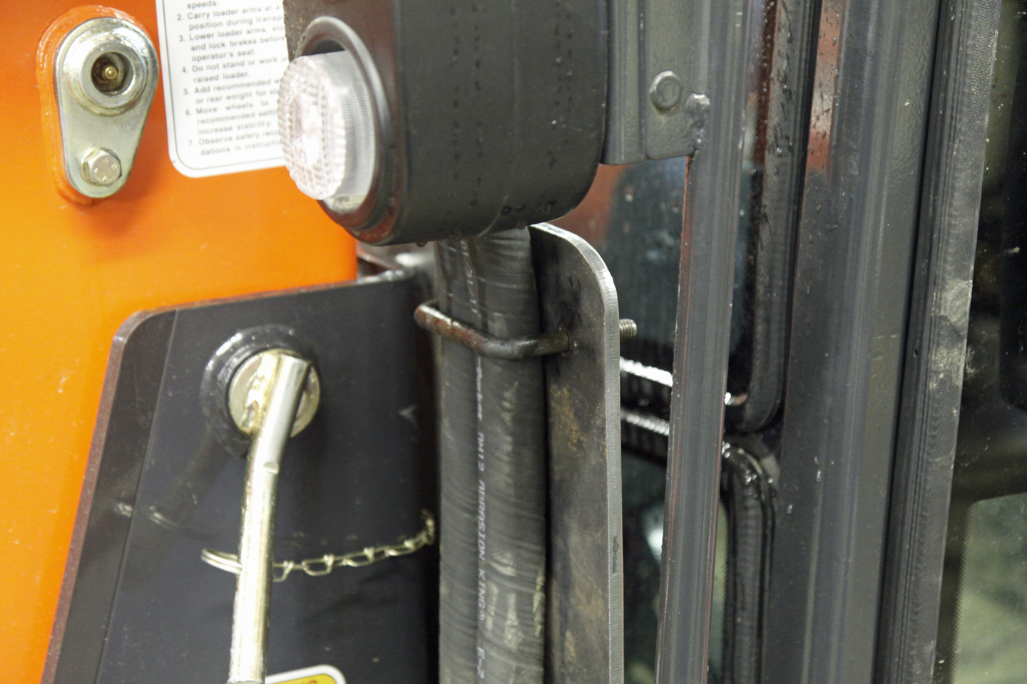

i built some removable brackets to support the hoses....they go under the cab, then up the loader support arm then over the loader arm. here are some pics
side bracket 1 and 2.jpgrear hors route bracket.jpgsnowblower installed.jpgcontrol wire 2.jpgbracket 1.jpgbracket 2.jpgbracket 2 better.jpgbracket #1 best view.jpg
