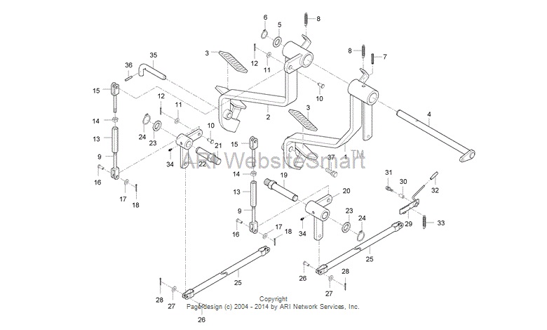

OK, think I was unclear. From what I can tell, the way this is supposed to work is there is a rod that goes through both brake pedals. There is a metal plate with a L slot in it attached to the right pedal. There is supposed to be a little nub sticking out of the rod (which also is L shaped), that goes into this slot on the plate. The rod then slides back and forth, clearing the left pedal and guided by the nub on the slot. I now realize that I am missing the little nub on the rod, and the non bent end of the rod has this nut that either holds a washer on, or has a washer attached, and won't come off. The washer prevents the rod from sliding clear of the left pedal. I hope that's clearer, I'll try to get a picture tonight. I think also the fact that I have a CK35 HST which has different brake setup than the gear CK and the DKs is adding to the confusion. So is there a trick or am I just missing something completely (I suspect the latter)

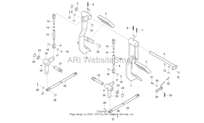

Here's a schematic to the two types of pedals listed for the CK35.
   / I Feel Like an Idiot... #12
Deerherd, is part # 35 the coupler that locks the pedals together? From Tony's description, this doesn't sound like what he has.
   / I Feel Like an Idiot... #13
I updated my post and put up the two types listed for the CK35

You should be able to do this without any tools. Can you just unscrew part #35?
No, the bolt (Part #37) is what is holding the rod (#35) from sliding, and I can not get it to budge. I know that in practicality I'll almost never use split brakes, but I want to be able to do it.
OK, here are the pics.
The first is a close up of the problem bolt (#37) where it attaches to the rod (#35). The 2nd is the whole assembly with the rod slid inboard, the 3rd is the rod slid outboard as far as it will go.
Hope this will lead to some answers
