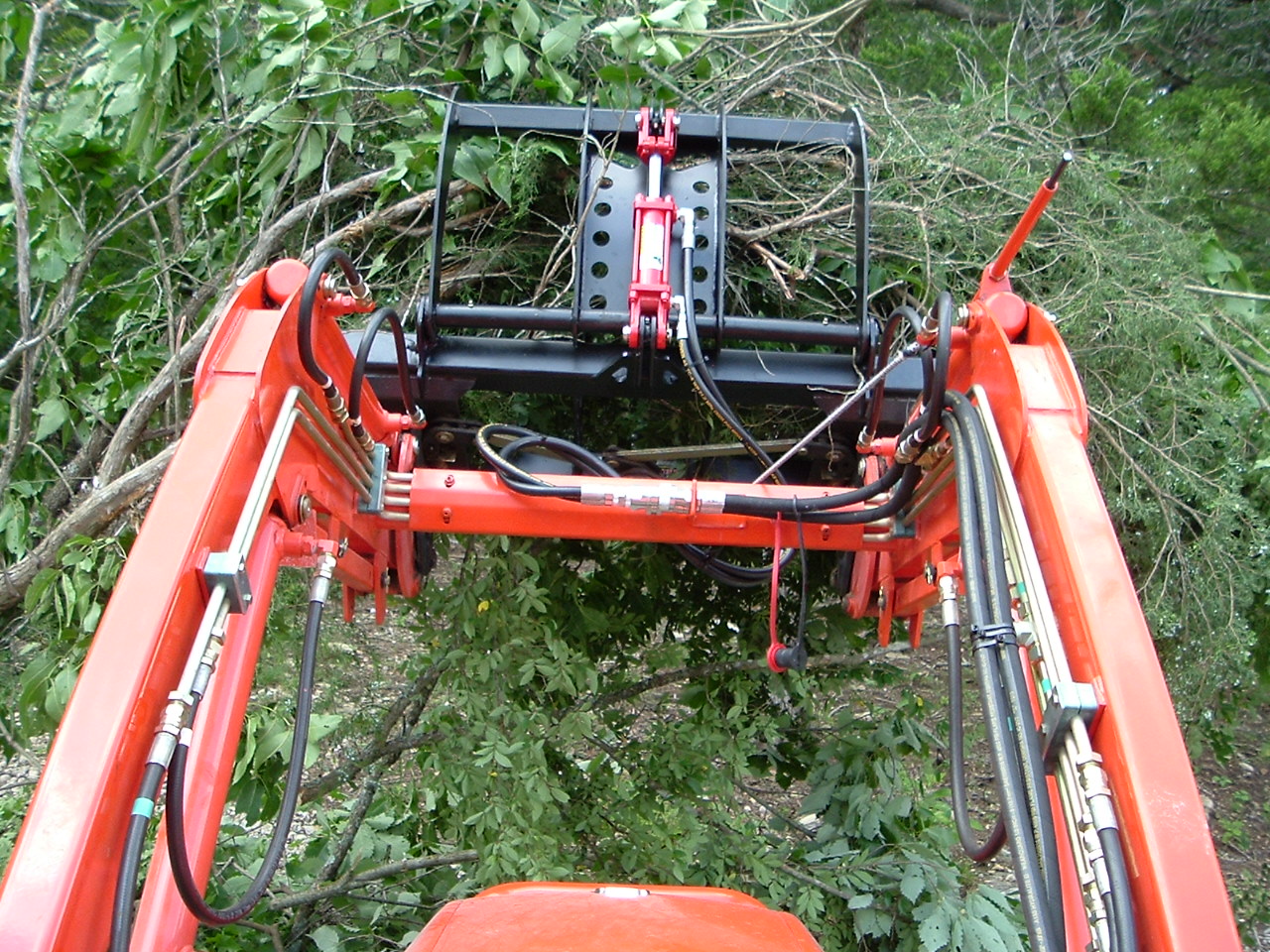

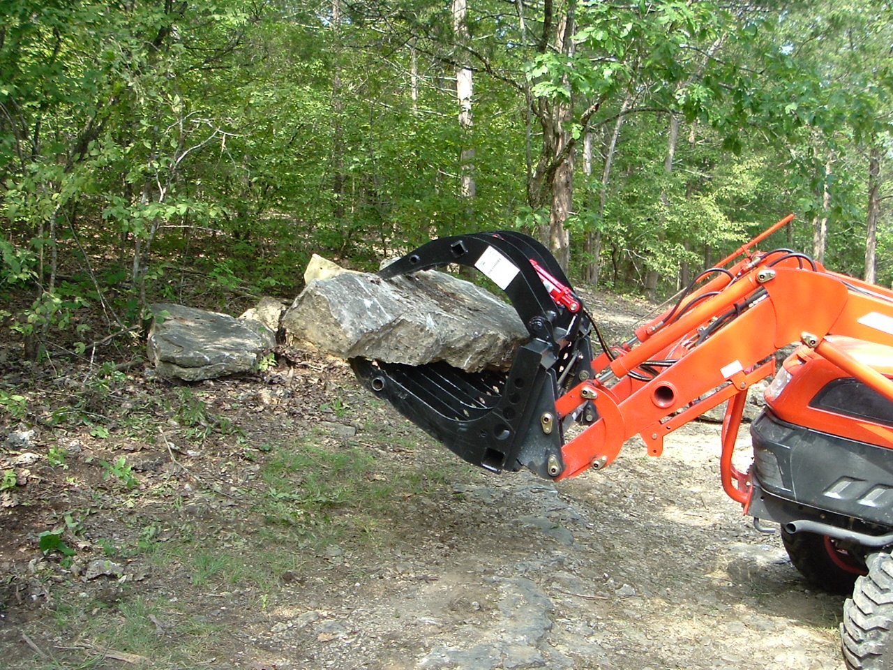

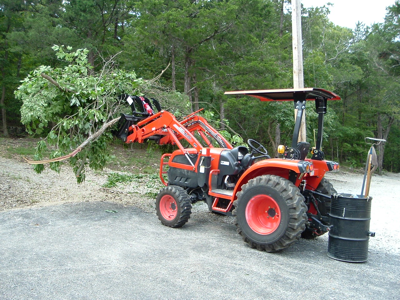

A good grapple will make that brush and tree hauling a snap!
