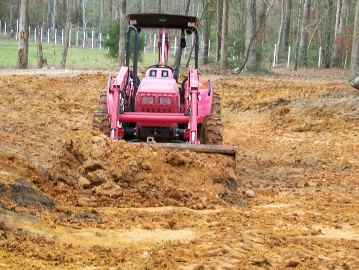

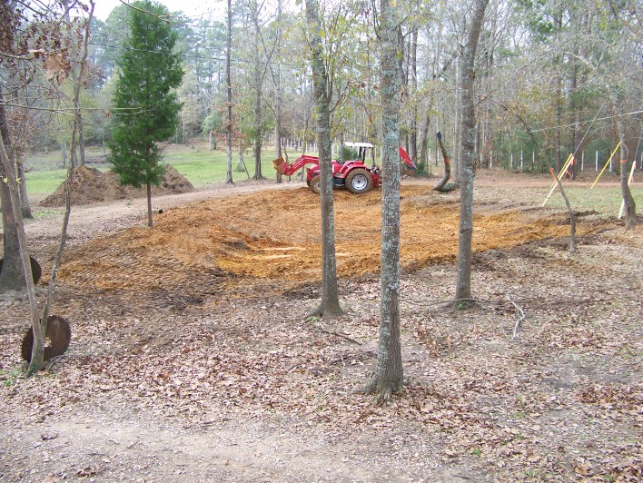

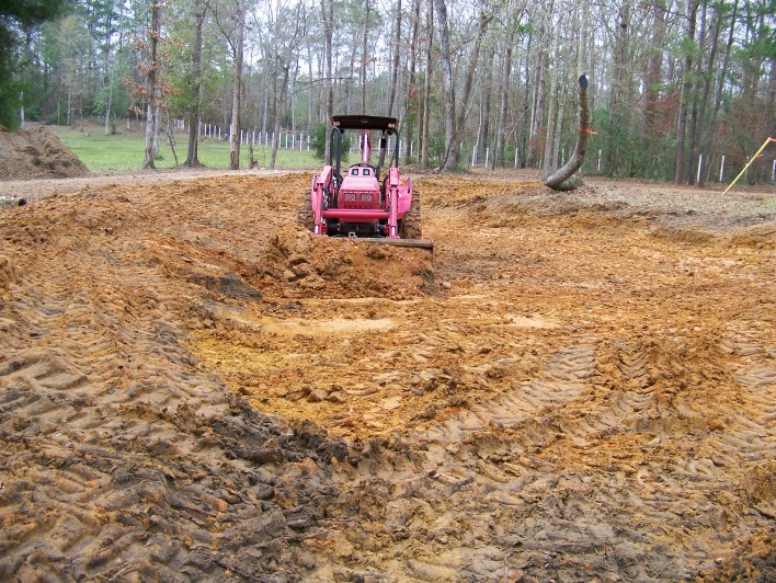

I don't own a back hoe......Can I presume that this is a MUST?
and BOEING been berry berry good to me:D
(ex. Pan AM, ex. ATA, Current Freight Dawg...arf, arf. (does Bugger need buds?)
Boeing,
You can dig out with your loader bucket. I dug down to about 4 feet, but the small size of the pond and the depth I wanted dictated using a backhoe. If I had the room, I could have dug out the pond only with the 7 foot wide bucket. This was really faster digging then digging with the backhoe, then hauling out the spoils with the loader bucket.
I just dozed, then tilted back and lifted the bucket when I got to the edges of the pond. After a while, it was just too tight in the bowl shaped basin to turn around safely with a full loader bucket of dirt.

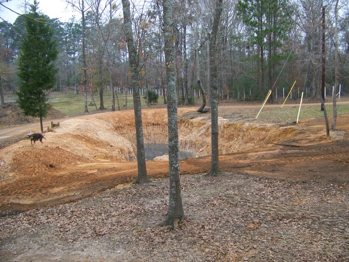

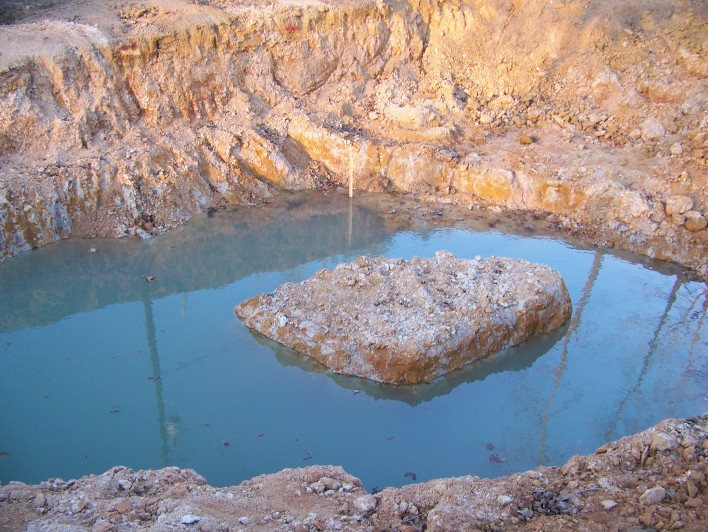

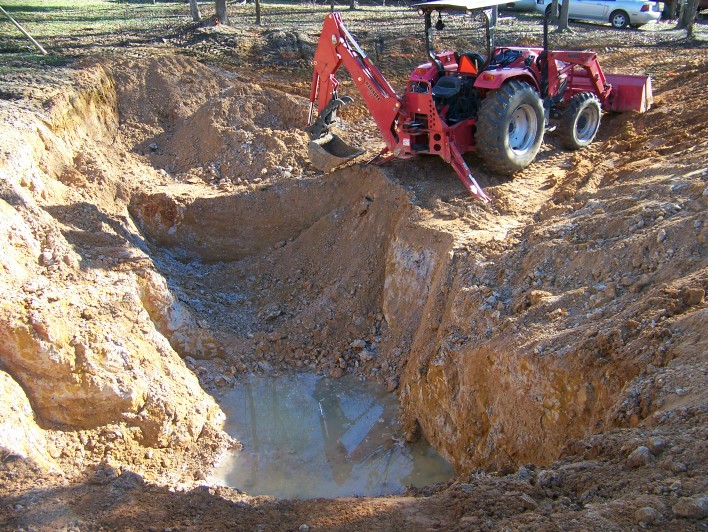

Boeing,
These photos show how the backhoe gave the small pond a lot of depth.
