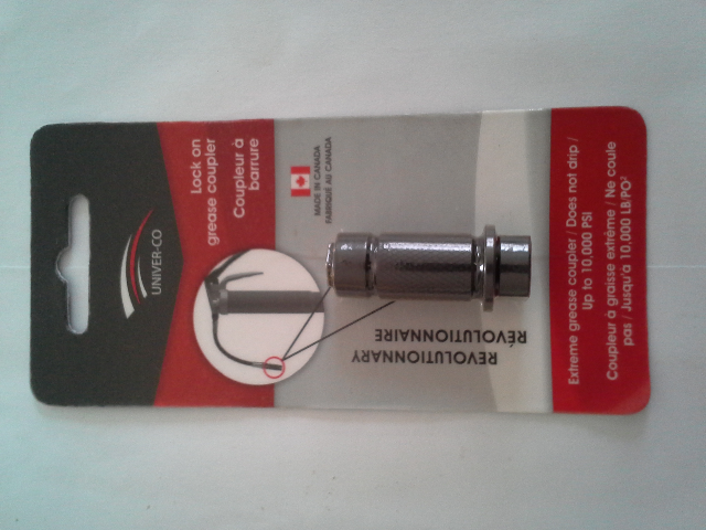

Ive been looking for the LockNLube since I first read of it from k0ua quite a while ago. EBay is the only place I could find them and shipping to Canada is a pain. Found this one a couple weeks ago at one of my local suppliers:
Pushes on and pull from the slide coupler to remove. Only marginally bigger than a standard tip. Had one fitting on my snowblower auger it wouldn't stay on but had been awesome otherwise. Well worth the $30. I'll be getting 2 more of them soon for the other 2 guns
   / I found a better LockNLube coupler review #20
