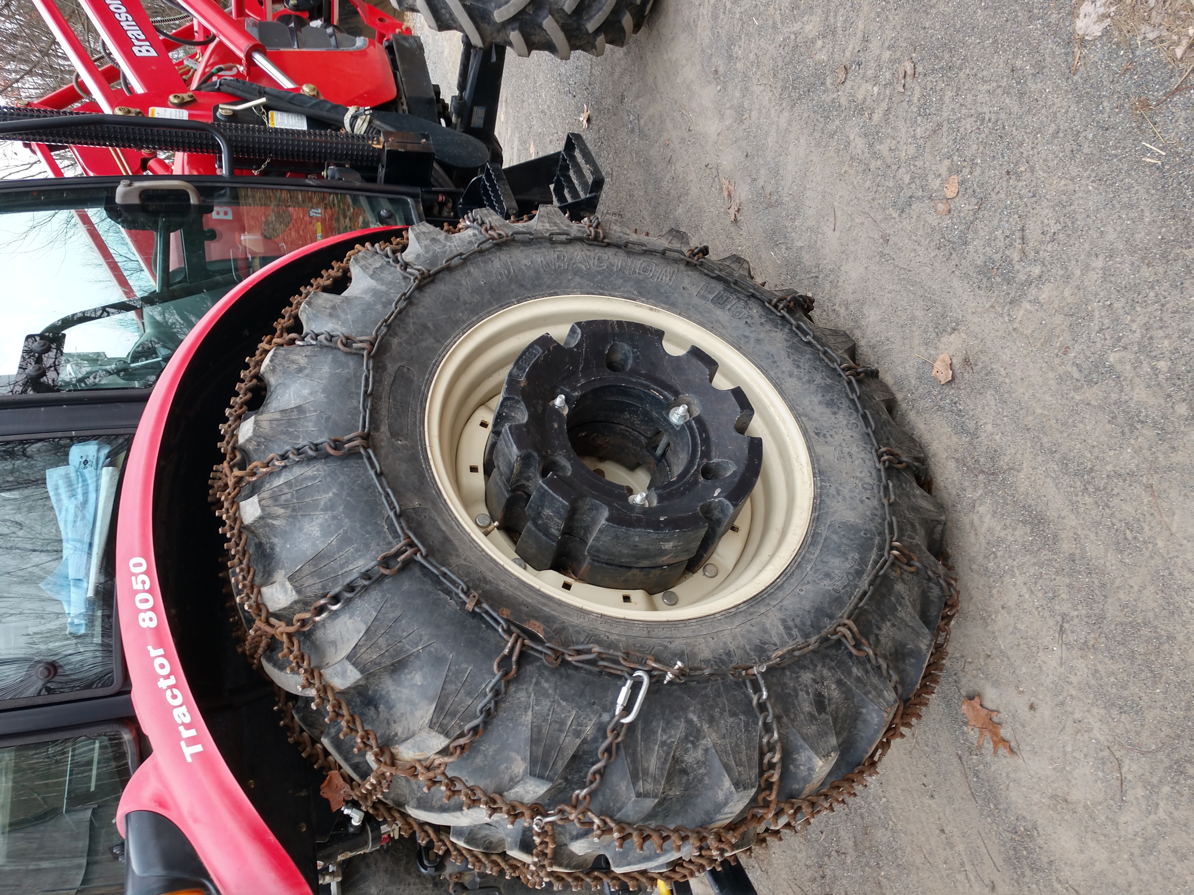

I bought a full set from tirechains.com this year. Shipped total was about $1500 but I got the spring tensioners and binder that helps install.
The style is completely up to you and your tire size.
They are very difficult and heavy to install if you have never done them before. Best method that I do for my tractor is to:
Jack up the rear, DEFLATE the tires, as in remove the valve stem. This shrinks the tire. Roll the chains on, or try to lift and stuff them under your fender on top of the tire. Hook the inside first, as tight as it will go.
Get a friend
Connect the outside, but dont cam it over.
Spin the tire and get the chains centered and even as best you can. A pry bar works well for this. Keep adjusting.
Cam over the chains, they should be tight, very tight.
Install tensioners or bungees
Re-inflate your tire to normal psi. You will hear the chains rubbing on the rubber. Tight chains are happy chains.
The fronts are really easy. Lighter and easy to get to. Use an FEL if you have one to life the front axle. Put a block under the other side so your axle does not articulate when you put the heavy chains on.
For the floor. Put down a layer of wood, like 2x6s where you will be driving. Let the chains chew them up.
Front chains are great for steering and helping pull if you have 4wheel drive.
Try not to spin the tires with chains on. This tears them up. Feather the clutch type of thing.
Trim or zip tie the excess chain material. You dont want that flying around.
I will put my chins on in the late fall and will keep them on probably until mid to late April. The work in the mud too!
The ride quality will be more bumpy. I'ts just one of those things. But you will grip like glue!
Totally worth the hassle and $$

I have not deflated tires in over 50 years of installing chains on tractors,
I have deflated pickup tires some times.
I do not try to super tighten chains, I only run tensioners on my pickup chains,
don't have any on my tractor chains.
Wire or tye wrap or use quick links or clevises on any loose links or remove them.
If you remove them you may have trouble next year when installing them if you switch sides.
I normally install mine in the fall and remove them in the spring.
On the tractors that we use on the roads going to the feed lots those chains are removed and installed
several times a year depending on conditions.

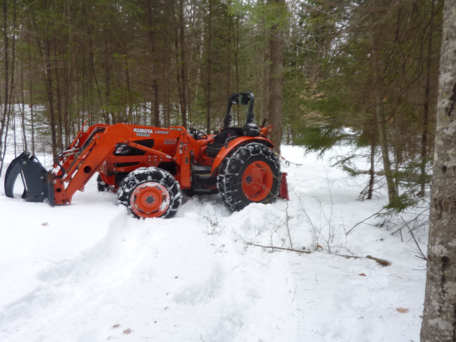

The ONLY chains I would recommend are the Euro type;
Auiline,
Trygg,
OFA's
these style of chains will provide the best traction and ride quaility of any conventional style of tire chains.
the link below should take you to a thread I posted on how I install chains,
this method works very well for me.
https://www.tractorbynet.com/forums/snow-removal/405039-mounting-tire-chains.html?highlight=
I agree with Lou, both on the Euro-style chain and on the installation method (It's well worth your time to read the description he linked). I wrestled with getting chains on my tractor for years. Using the method Lou describes, my 100#, 14 year old daughter could do it. The toughest part about the install is dragging the chains out of the garage (well, that and the fact that I always seem to wait until it's well below freezing and blizzard conditions to put them on).
I've tried a variety of chains on my tractor. I finally settled on the OFA Eko 8 chains for my rear wheels, and wish I had just bought them from the start. I started with V-bar ladder style, then went to V-bar Duo-Grip style, and now the OFA Eko chains. For my variety of uses, there is simply no contest. It was an expensive experiment, but the up side is that I've used all those chains on the exact same tractor and in the same terrain, so I really got an education in what the differences are. There are plenty of uses where one of the other styles would have been "good enough", but with the variety of my situations, the Euro-style is it.
If you are interested, I posted my impressions in more detail in a thread in the Kubota Owners section (apparently, they will let us NH owners in there if we behave ourselves): L3301 Snow Chains. The whole thread has some good info in it.
There was another good thread - I think in the Snow Removal section - but I can't find it now.
