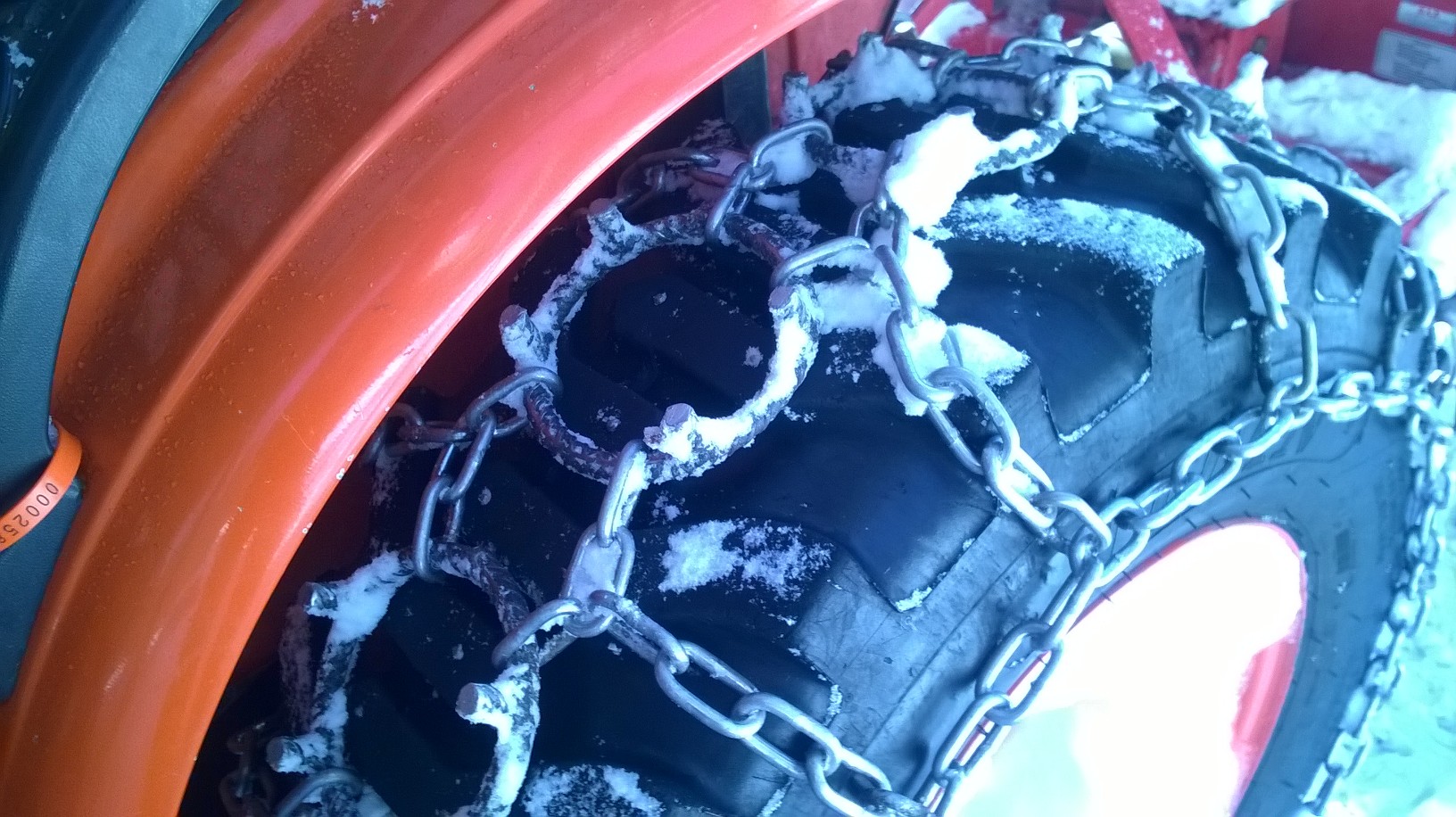

Mine are almost identical, perhaps a newer design. TRYGG.
I used them only on the rear of a M7040. I clear two brothers' driveways which are paved and all that happens is small polished white marks which oxidize black once the sun comes.
The right tool makes life much easier getting the chains secure.
The TRYGG tool is expensive. $280 Canadian $.
It is like a bumper jack from the 1960's. I was going to make my own but 1960's bumper jacks are highly sought items for many $$.
I tried many methods before the TRYGG tool. It is like having a gorilla help you. Unbelievably easy to use.
The TRYGG chains and side links are so hard a 36" bolt cutter wont even scratch them.
Dave M7040
p.s. the non uniform chain pattern on the tire was the result of a mis match between tire and chain and has been corrected

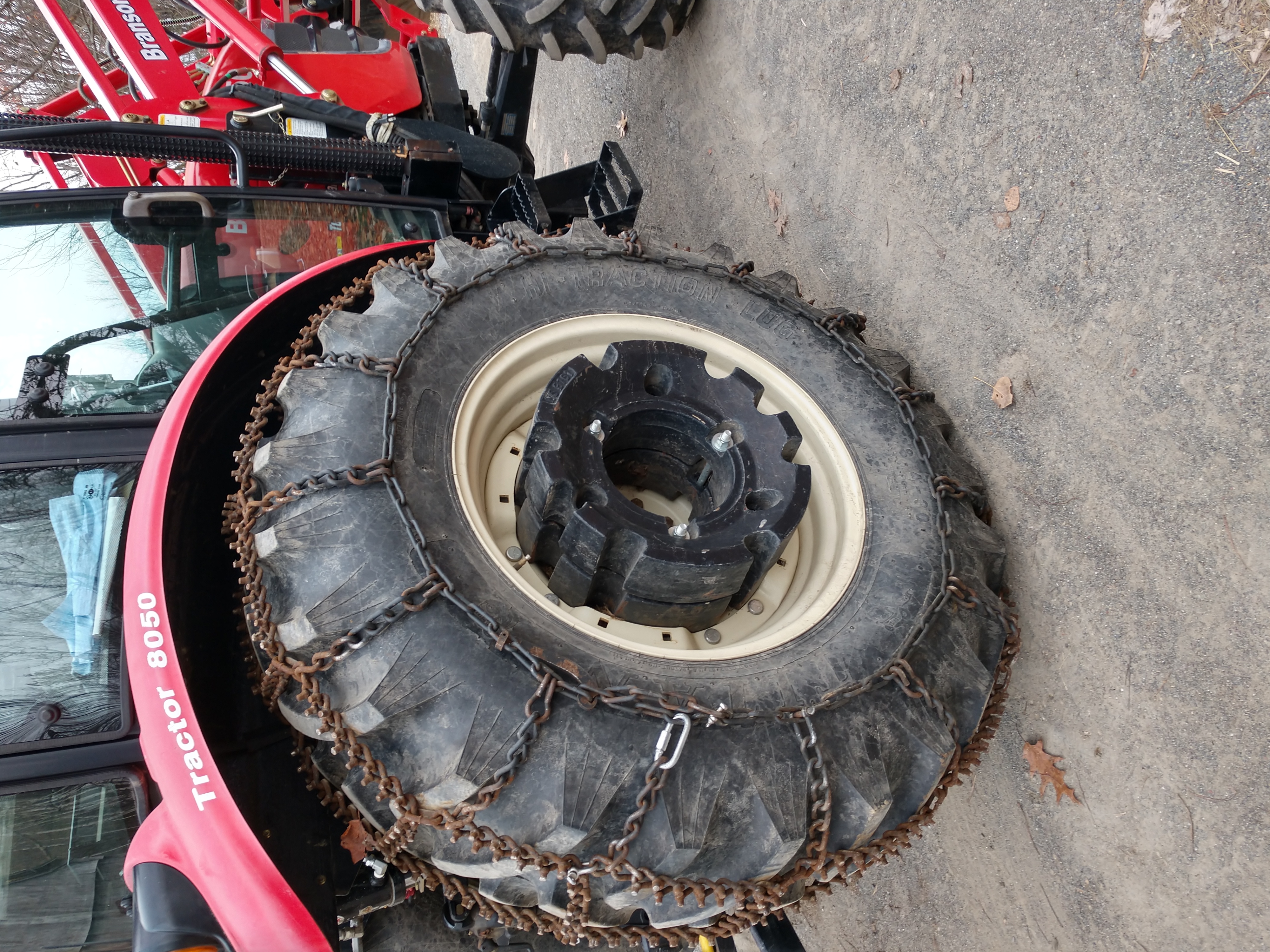

Or you could make your own.

I bet those work great. Got a lot of time invested in those, but probably only $100 in materials.
You are right, I have a bit less than 100$ invested in these however they did take me approximately 10 hours to complete. A friend of mine has the TRYGG chains mention earlier in the thread and they are even better. He's had them for 10 years and they are still going strong. His has the grousers on the side chain as well which I think helps with clearing deep snow from the tires path.
